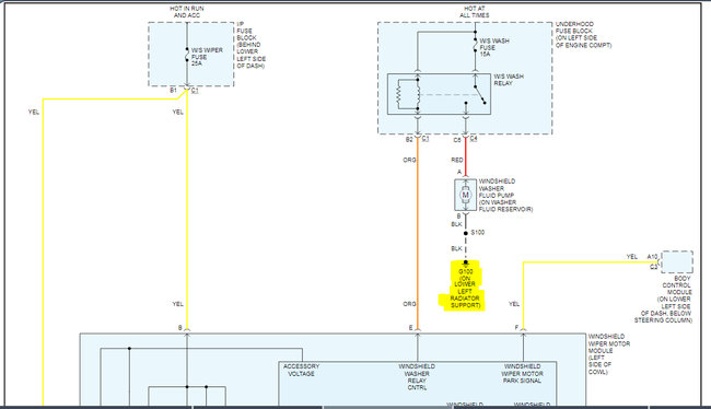

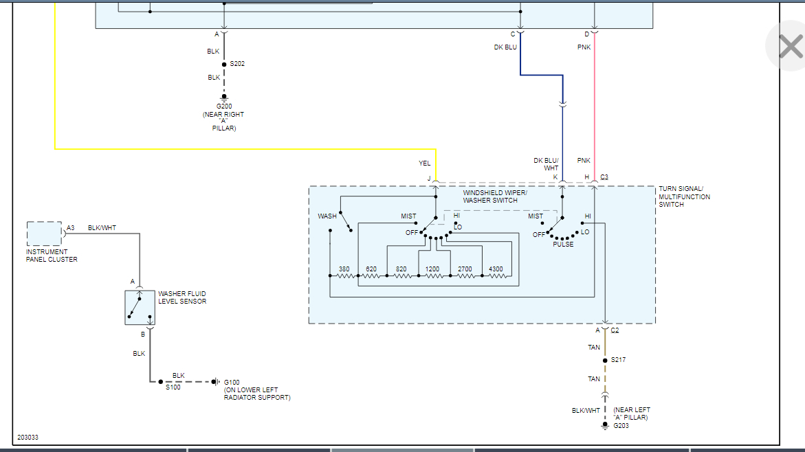

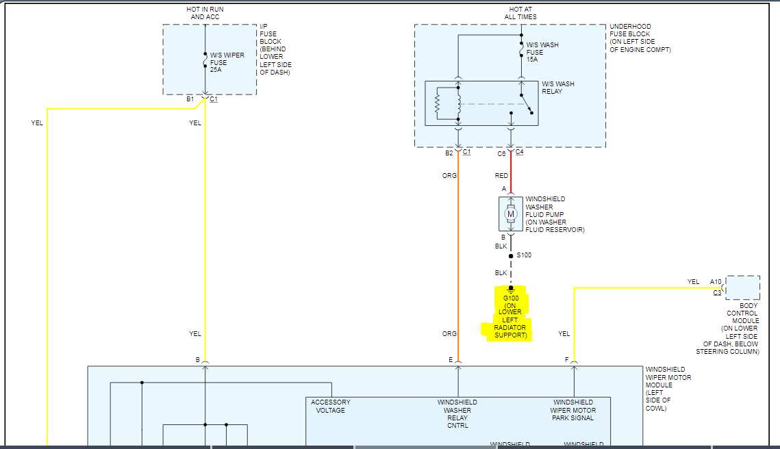

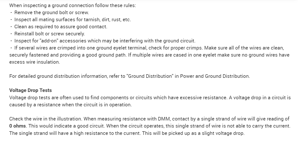

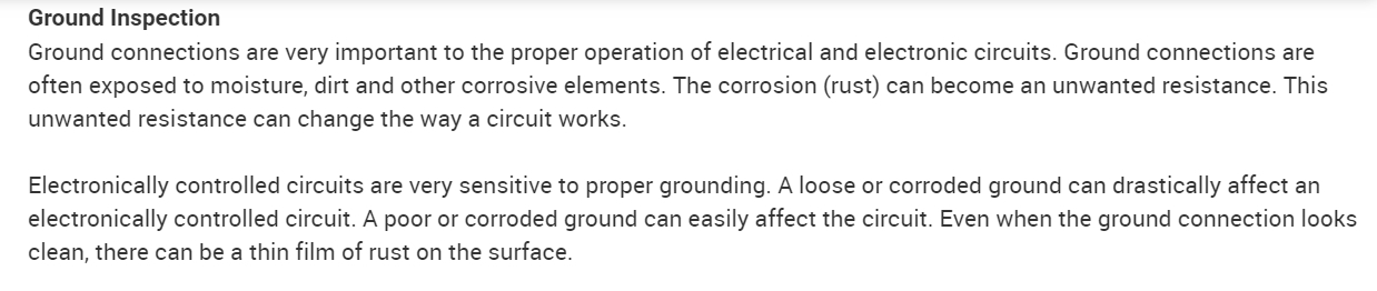

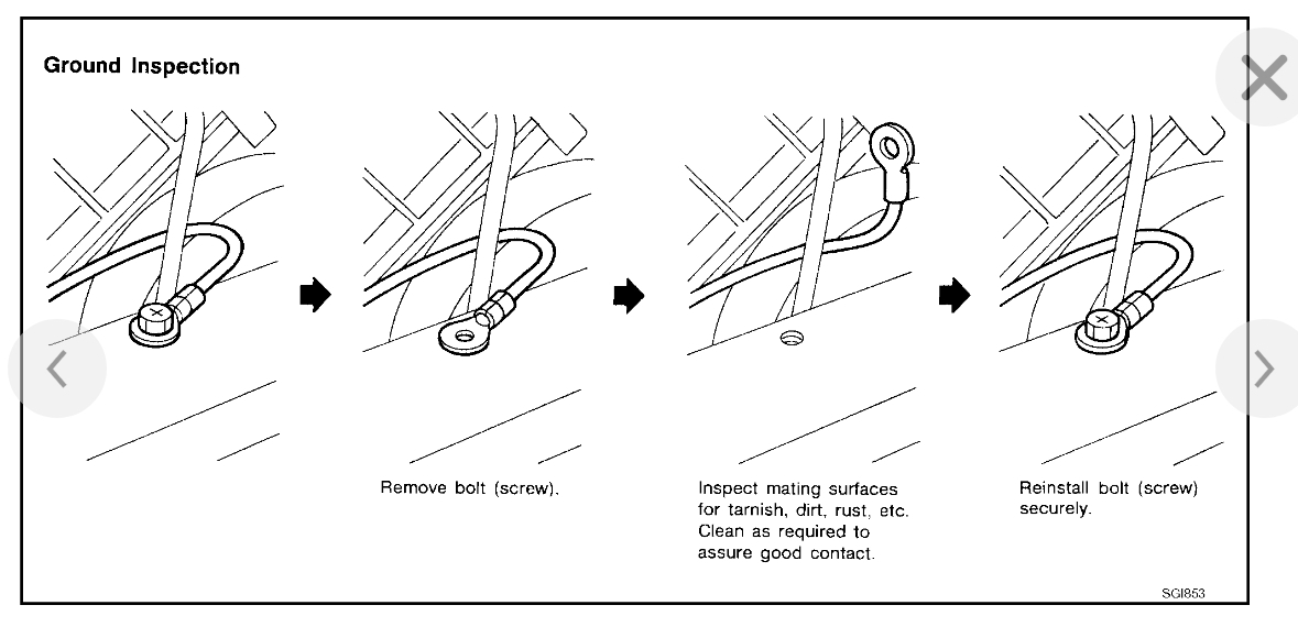

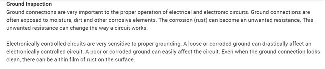

This could be a problem with the Ground 100, which is located on the lower left radiator support. The negative or ground side of the circuit is overlooked a lot of times when diagnosing an electrical problem, but it is half of the circuit and when it messes up, the whole circuit is dead. In fact, according to Honda of North America, seventy five percent of all electrical problems are ground problems. In the diagrams down below I have include the wiring diagram for your vehicle's washer/wiper system and a guide explaining how to check grounds. Please go through these guides and get back to us with what you are able to find out. We can continue from there, if necessary.
