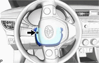

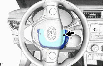

Here are the directions specific to your vehicle for replacement. The attached pictures correlate with the directions.
2015 Toyota Corolla L4-1.8L (2ZR-FAE)
Wiper Switch - Removal [08/2013 - ]
Vehicle Sensors and Switches Sensors and Switches - Wiper and Washer Systems Wiper Switch Service and Repair Removal and Replacement Wiper Switch - Removal [08/2013 - ]
WIPER SWITCH - REMOVAL [08/2013 - ]
WIPER / WASHER: WIPER SWITCH: REMOVAL; 2014 - 2018 MY Corolla [08/2013 - ]
PROCEDURE
REMOVE LOWER STEERING COLUMN COVER
NOTICE:
Removing the lower steering column cover in the incorrect order will cause the parts to break.
Release the tilt lever, and fully extend and lower the steering column.
Lock the tilt lever.

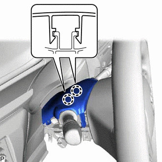

Turn the steering wheel assembly to the left and remove the screw.
pic 1
Turn the steering wheel assembly to the right and remove the screw.
pic 2

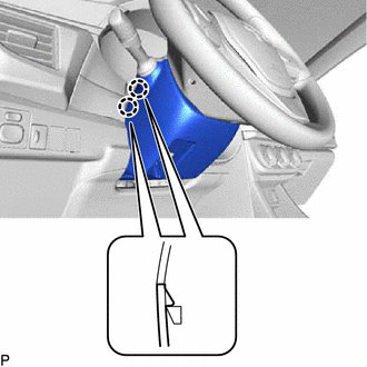

Turn back the steering wheel assembly to the center.
Disengage the 2 claws.
pic 3
pic 4
Insert your fingers into the opening of the tilt lever of the lower steering column cover and disengage the 2 claws .
pic 5
*a Claw
*b Claw
HINT:
Spread the claw to disengage them.
Disengage the 2 claws to remove the lower steering column cover.

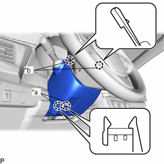

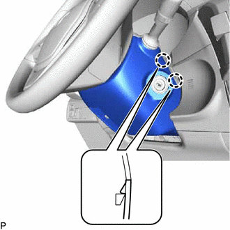

REMOVE UPPER STEERING COLUMN COVER
Disengage the 2 claws and remove the upper steering column cover.
pic 6

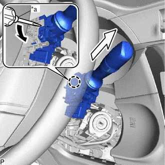

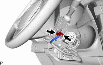

REMOVE WINDSHIELD WIPER SWITCH ASSEMBLY
Disconnect each connector.
pic 7
Turn the steering wheel assembly to the right.
Using a screwdriver, disengage the claw and remove the windshield wiper switch assembly as shown in the illustration.
NOTICE:
If the claw is pushed with excessive force, it may break.
pic 8
*a Screwdriver

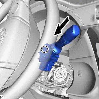

INSTALL WINDSHIELD WIPER SWITCH ASSEMBLY
Engage the claw to install the windshield wiper switch assembly.
Pic 9
