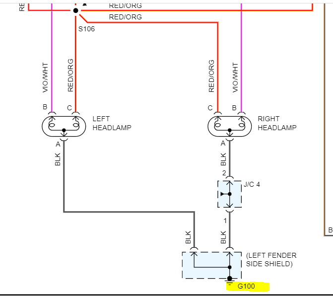

If the right-side headlamp is dim it is likely related to a weak ground. The headlamps ground on the left side fender. See pic below.
Note that it is identified as G100. The turn signals have the same ground. Also, on the right-side headlamp, there are two joint connectors related to a ground for the signal lamps. So, this is where I would suggest starting.
I have a feeling there is a weak ground allowing power to back feed through the signals.
Check the ground first. There will likely be more than one wire there, so make sure all connectors are in good condition and not loose, damaged, or corroded.
Let me know what you find.
See pic below.
