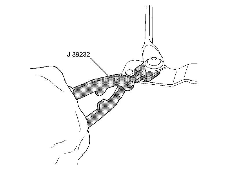

J 39232 Wiper Transmission Separator

3. Remove the transmission from the wiper motor drive link using the J 39232.

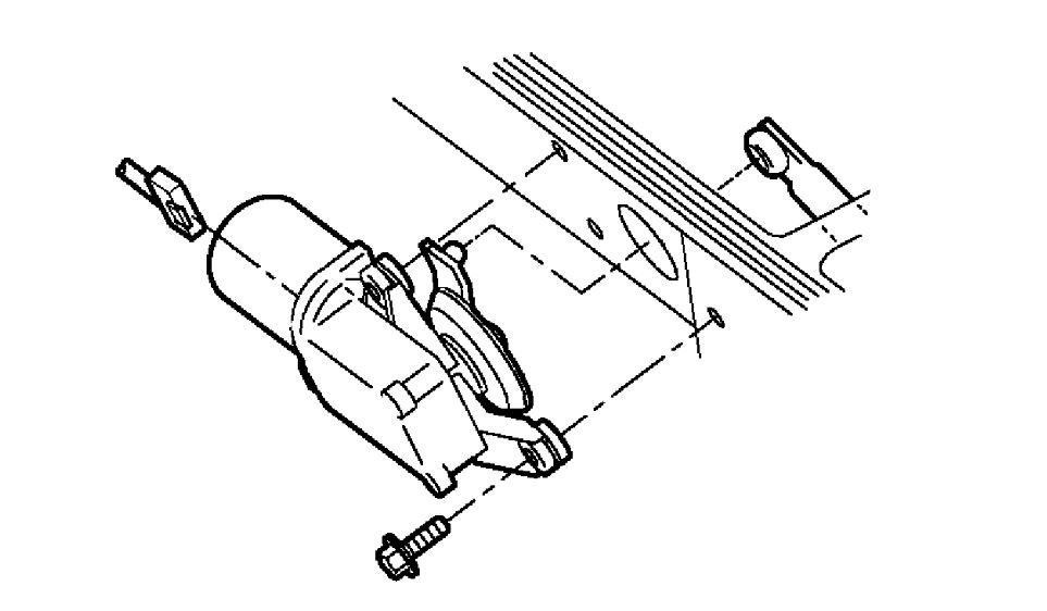

4. Disconnect the electrical connector from the wiper motor.
5. Remove the three screws and wiper motor from the vehicle.
Check out the images (Below). Please let us know what happens.
