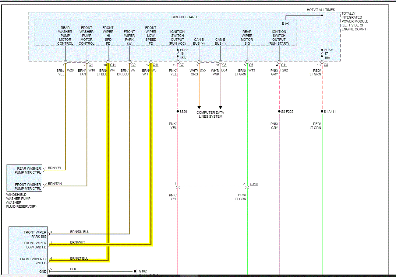

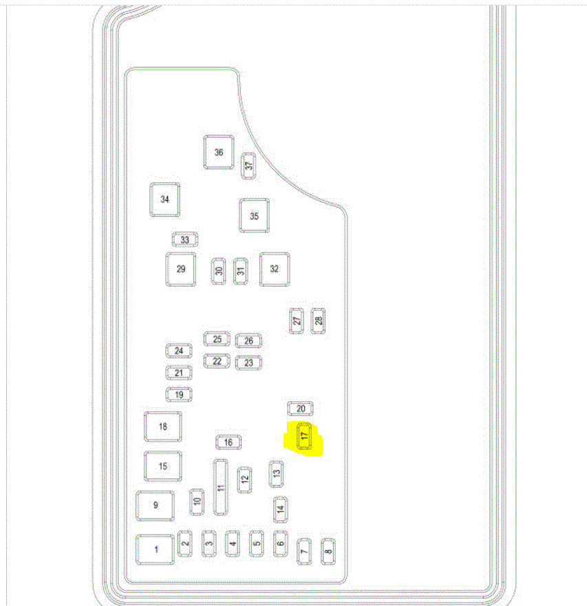

First, if I am reading the wiring schematics correctly, fuse 17 in the under-hood fuse box (see pic 1 below) is what powers the wipers. If you haven't already, check that fuse. If it is good, make sure there is power to and from it. Here is a link you may find helpful:

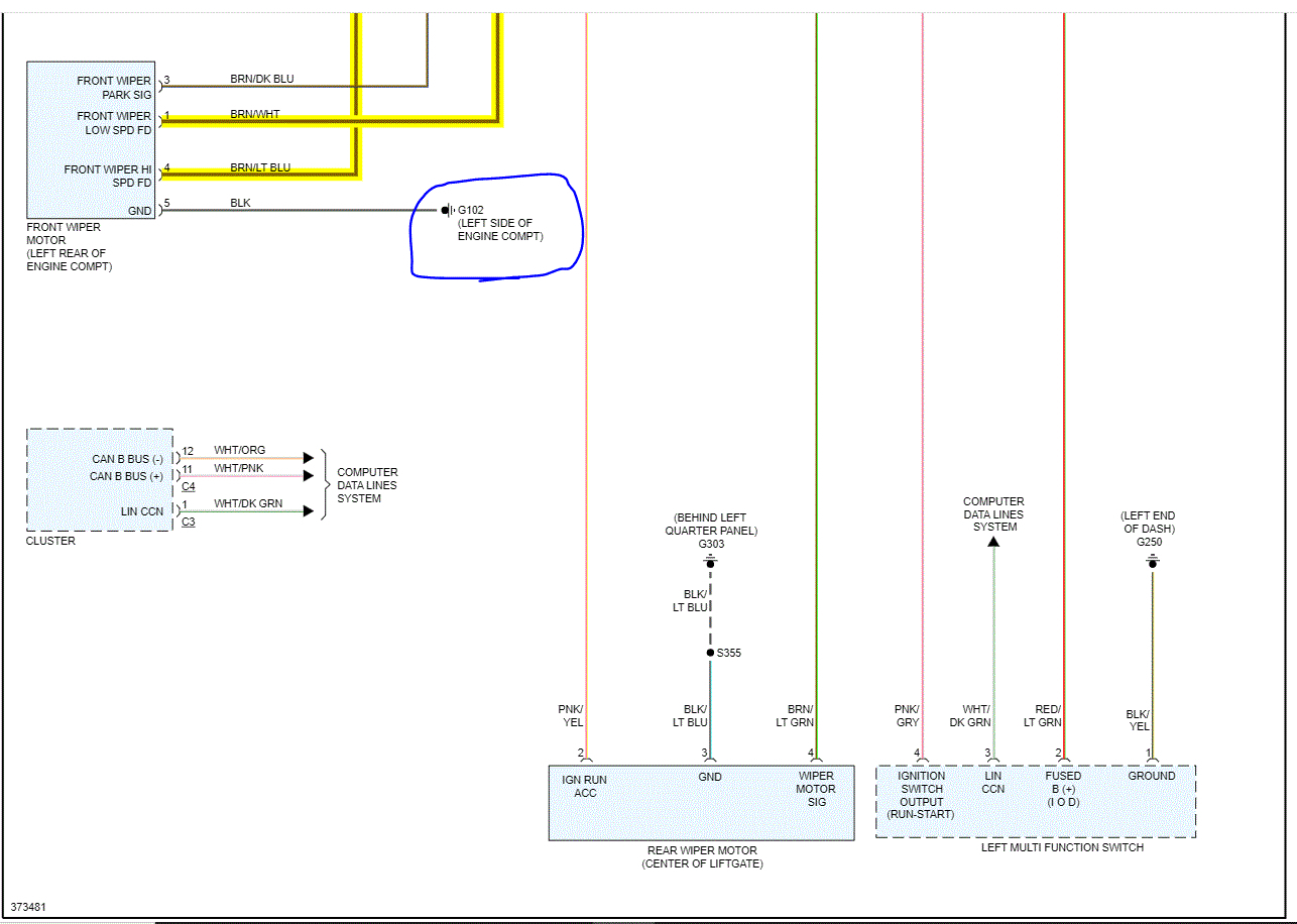

If the fuse is good and has power, the easiest thing to do next is to confirm that the ground wire at the wiper motor (black in color) has continuity to ground. See pic 3.
If that checks good, then we need to confirm if there is power to the motor. If you look at the wiring schematics below (pics 2 and 3), notice I highlighted two wires. One is brown with a white tracer and the other is brown with a light blue tracer. The brown/white powers the low wiper speed and the brown/lt blue powers high speed.
Turn the key to the run position (engine off). Turn the wiper switch on high speed and check the brown/light blue wire for power using a test light or a voltmeter/multimeter.
Do the same on the brown/white wire with the wipers on low speed.

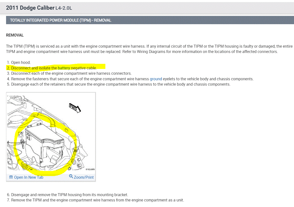

The connectors are under the TIPM (fuse box). First, make sure the battery is disconnected (neg terminal). Next, follow the directions in pic 1.
Once the box is loose, carefully lift it up to gain access to the wiring/connectors under it which plug into the module.

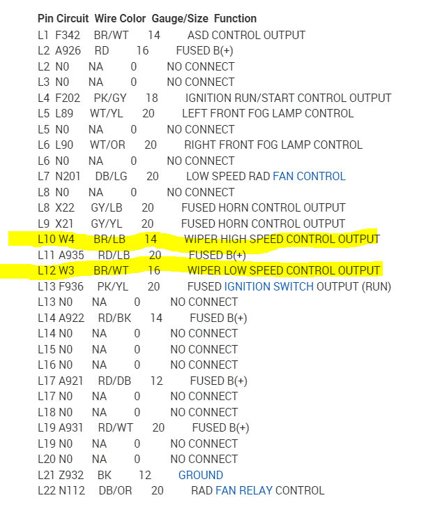

If you noticed in the first schematic I sent, the wiper speed power is supplied via connector 11 (C11) at pins 10 and 12.

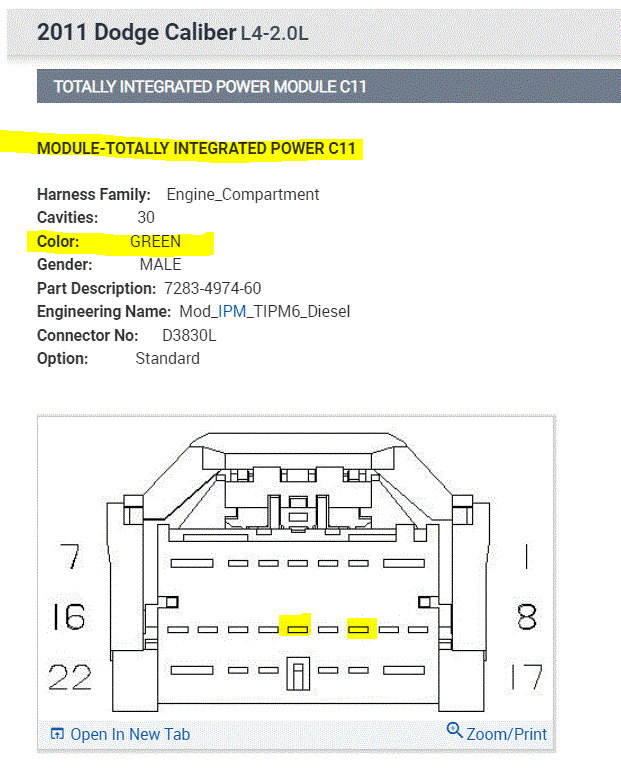

Connector C11 will be green in color. If you look at pic 2 below, you will see how it's shaped. Disconnect the connector and inspect the two pins I highlighted in pic 2. Are they corroded, broken, or damaged in any way? Also, check on the receiving end for corrosion or damage.
