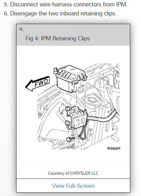

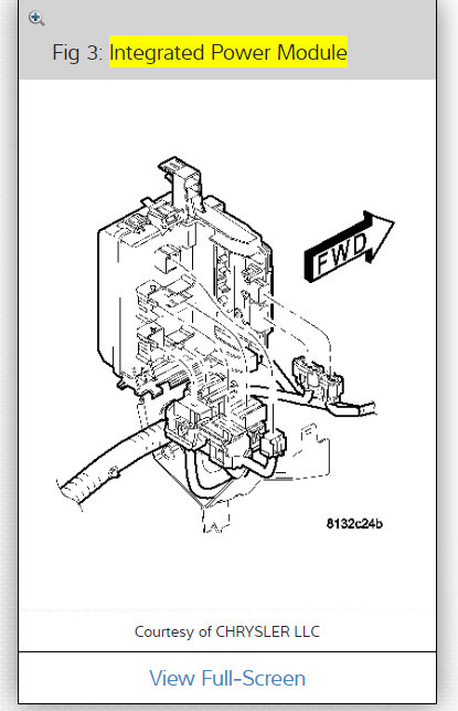

This is common when the TIPM goes out which you can replace yourself because it self initializes. Check out the diagrams and instructions (below). Please let us know what happens.
May 15, 2019 at 10:41 AM

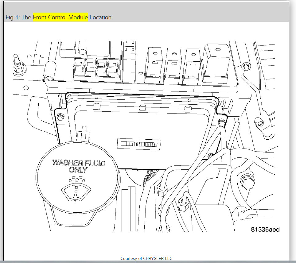

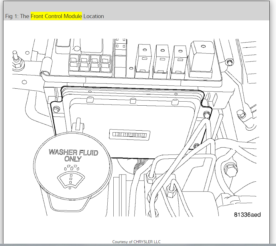

When you did the TIPM did you do the front control module? I see they are separate on this car.
Here is the test and the diagrams below

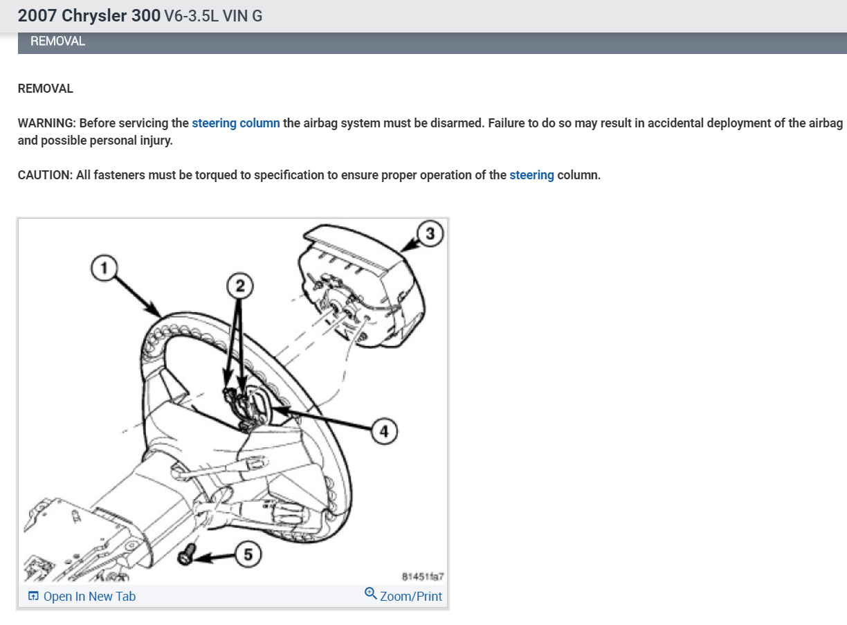

Thank you. The front TIPM was replaced also the Steering Column Module. I guess I could try replacing the actual lever switch the turn signal switch that encompasses the windshield wiper and turning signal as well as high beams.
May 16, 2019 at 1:16 PM

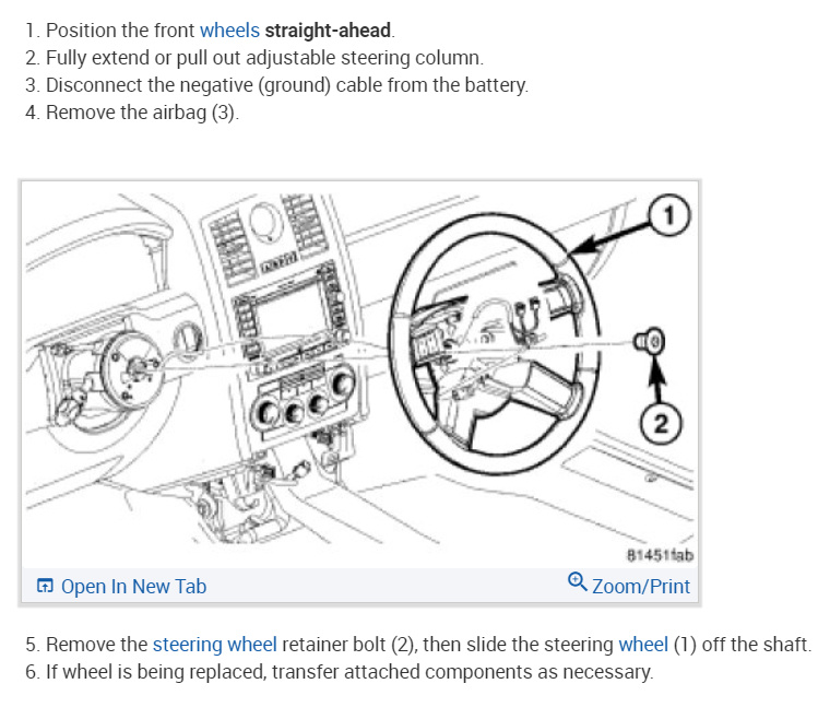

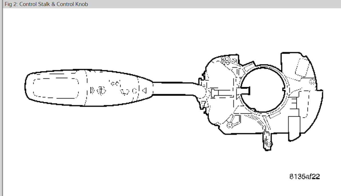

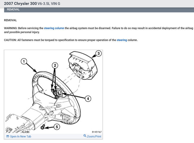

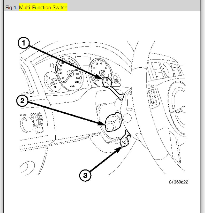

That would be my next move. here are pictures of the switch it looks like you will need to remove the steering wheel this guide and instruction below will help.
https://www.2carpros.com/articles/steering-wheel-removal

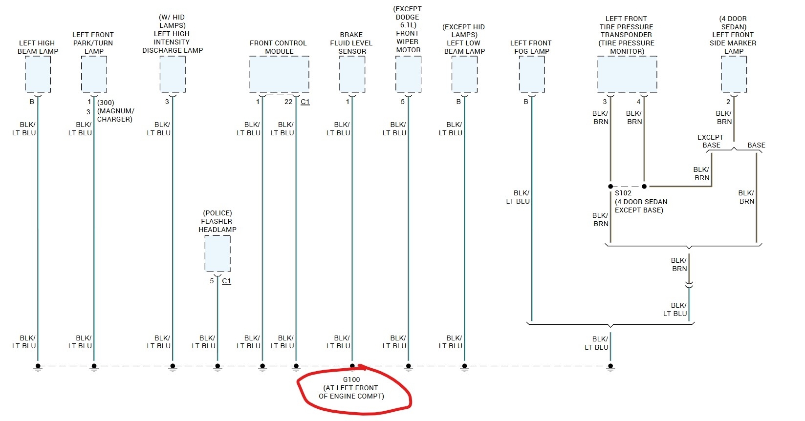

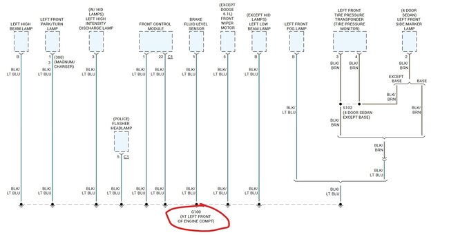

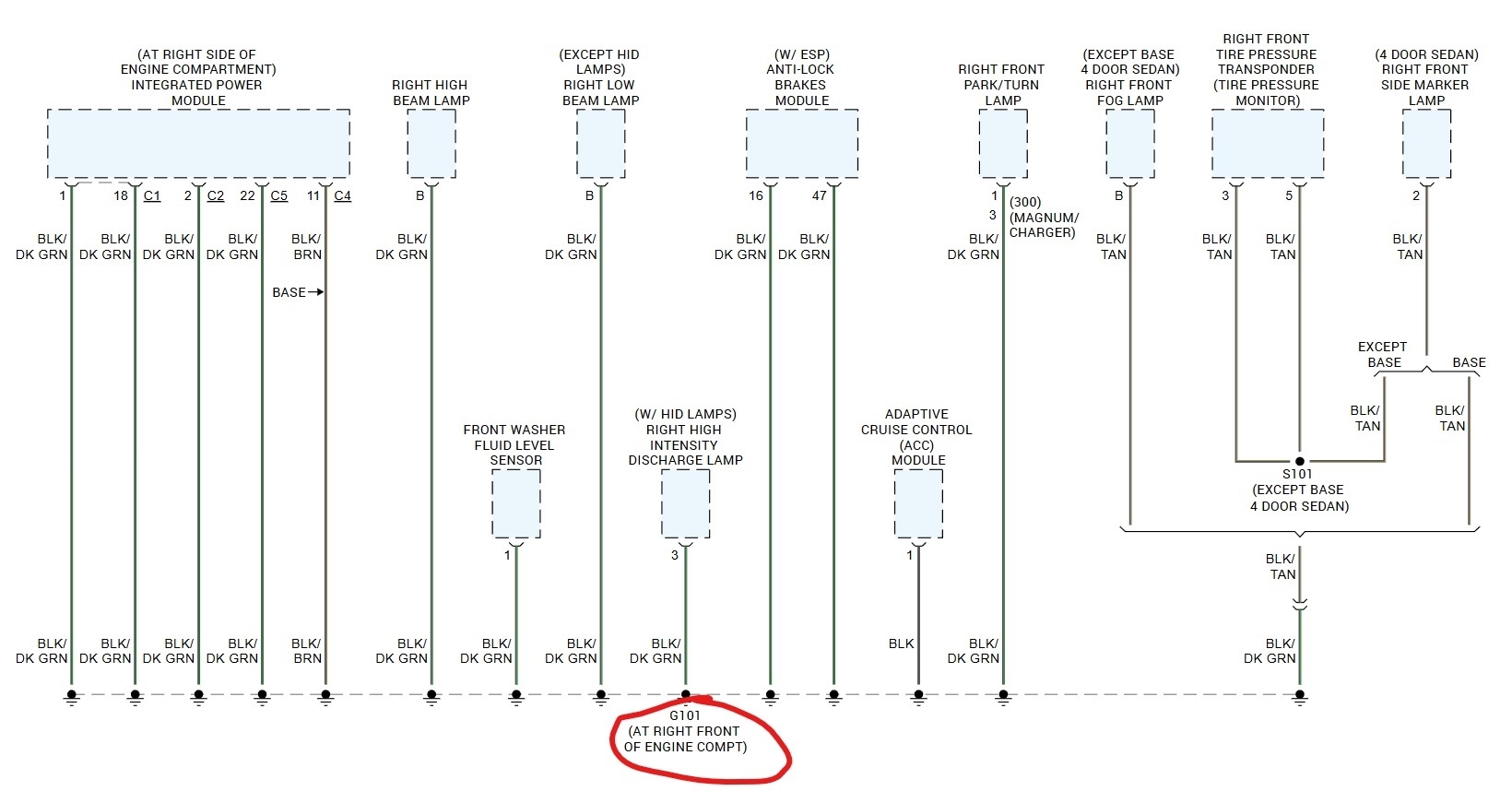

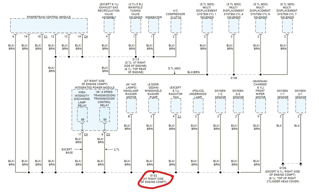

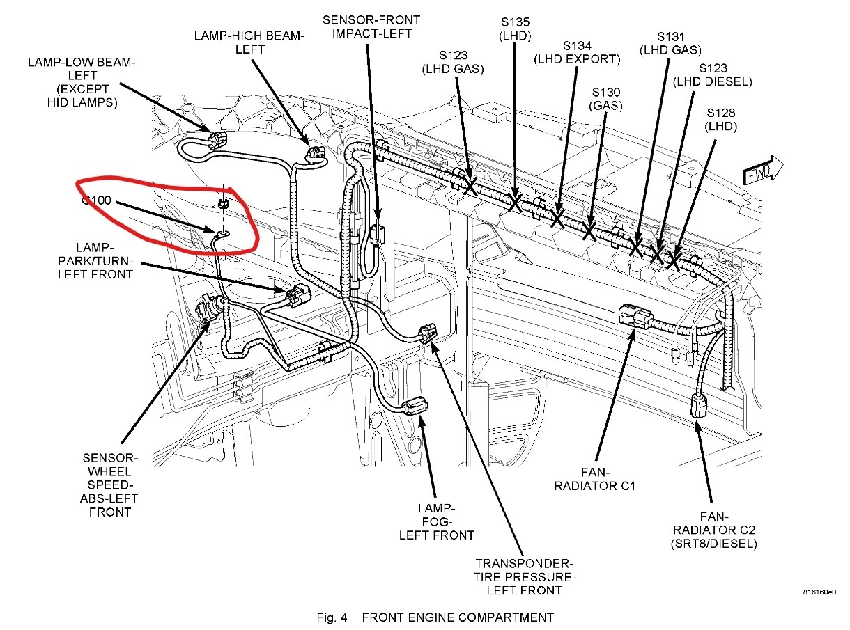

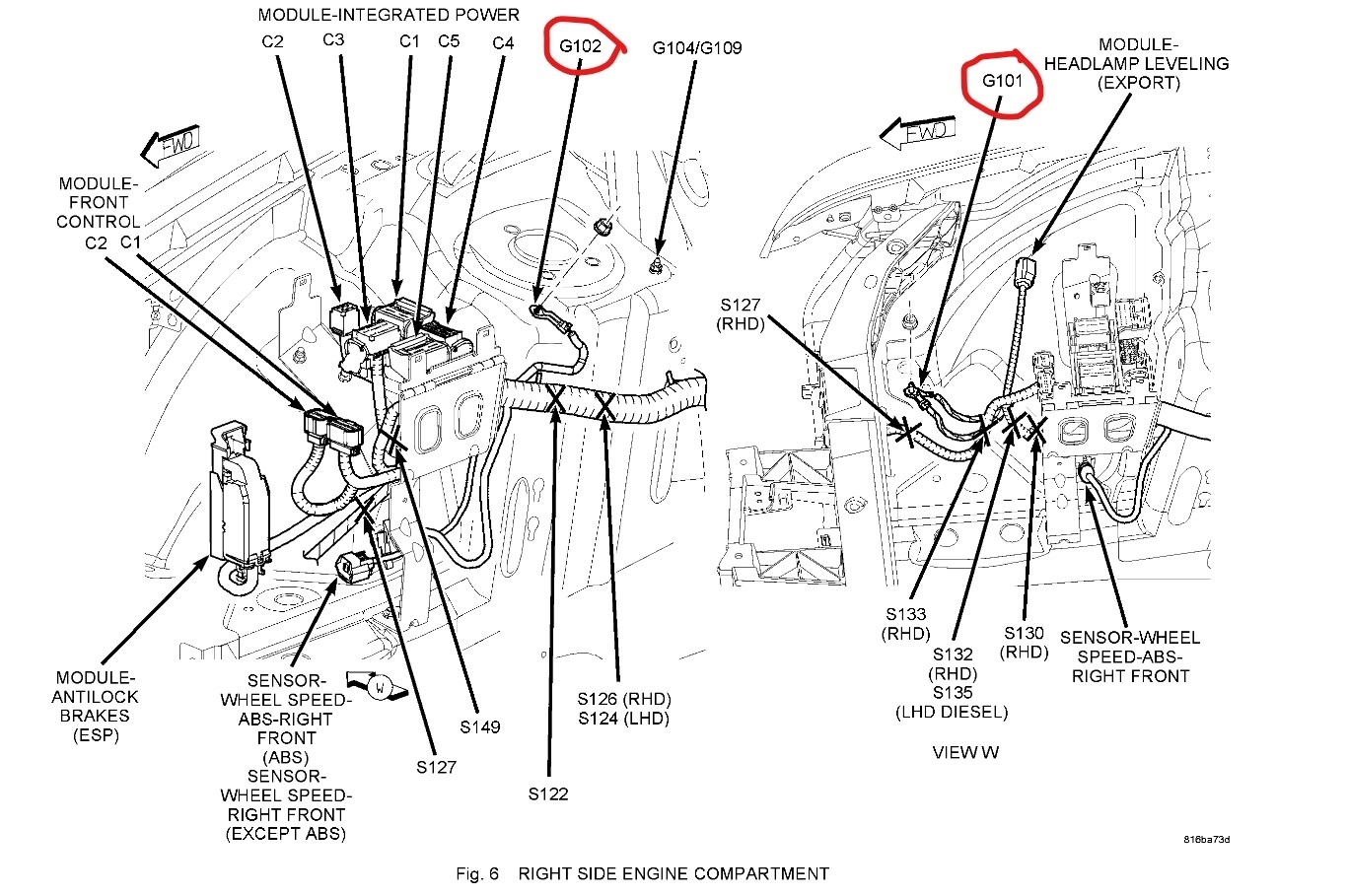

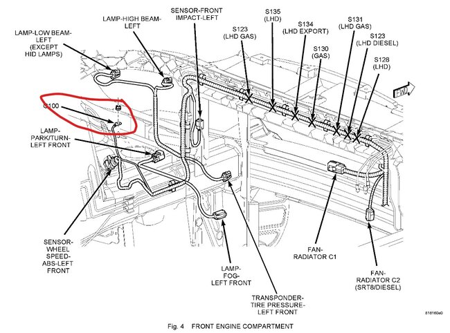

Okay, with multiple systems showing a fault on a Chrysler I'm going to suspect a bad ground point. The engineers thought it was a good idea to take a lot of individual ground wires, bundle them together and then crimp them all into a single eyelet and onto a single bolt. Usually there are 6-10 wires bundled together and in your case, those meet up at ground point 100 and 101. I would say to give each wire a good tug but have the parts to repair them handy. I would also check the other ones in the front, rarely do I find just one bad ground. If you look at the first two images you can see where the grounds are bolted in place, notice how it looks like 3 wires? The other three images are the actual numbers of wires at each of those ground points. Just a few more than 3.
Here are a couple examples of what you are likely going to find - These are on Jeeps, but the entire product line suffers the same issues.
