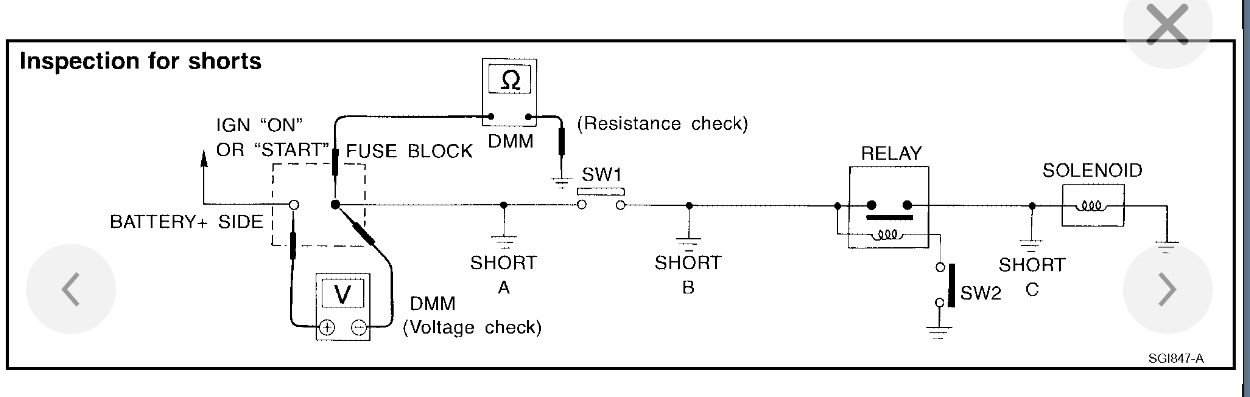

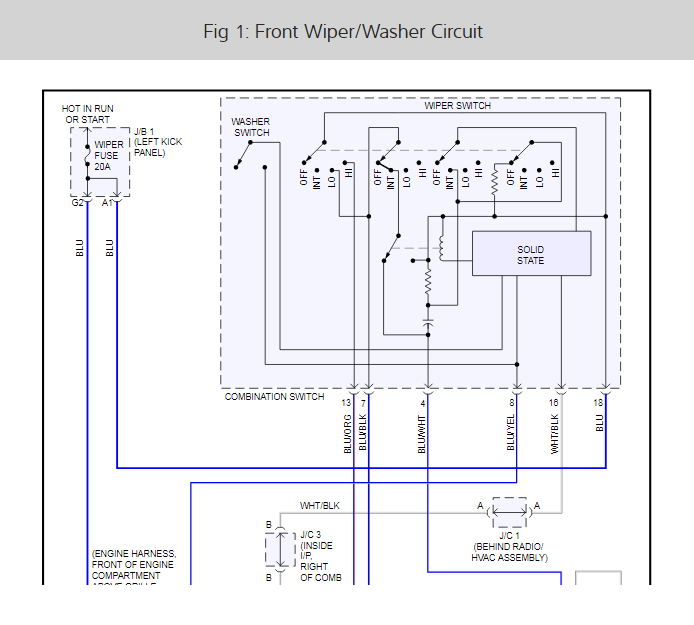

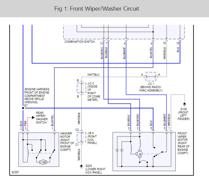

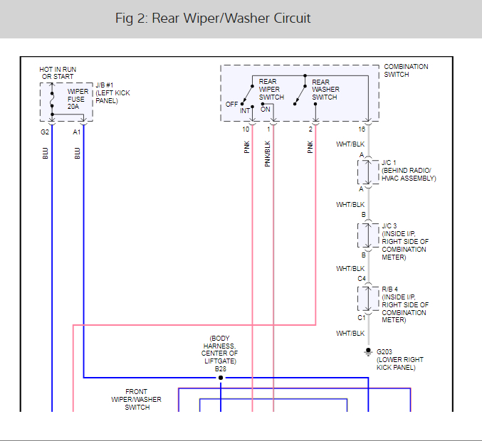

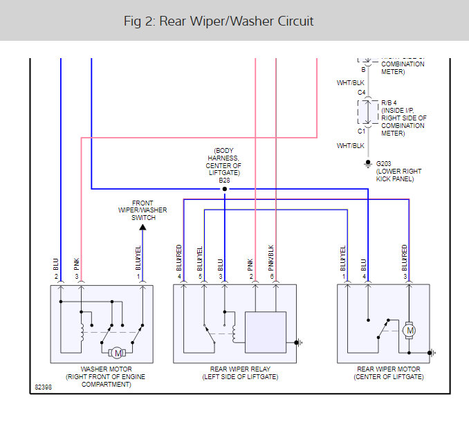

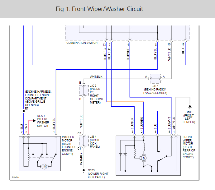

Vehicleis a Dx wagon. I Checked the 25 amp fuse and it was blown. so I replaced it with a new 25 amp fuse but still both the front and rear wipers don’t work. Then I tried changing out the wiper switch on the steering column with the original one that previously worked. (I had changed the clock spring with high beam/wiper switch with a new set 2 years ago) but still nothing. Any suggestions on what else I should do or check would be helpful. Thank you.
