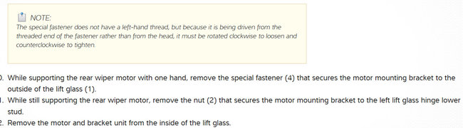

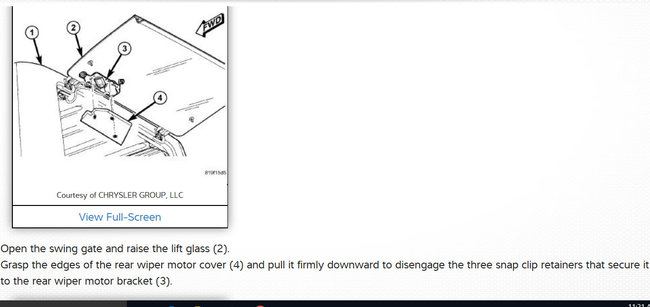

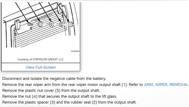

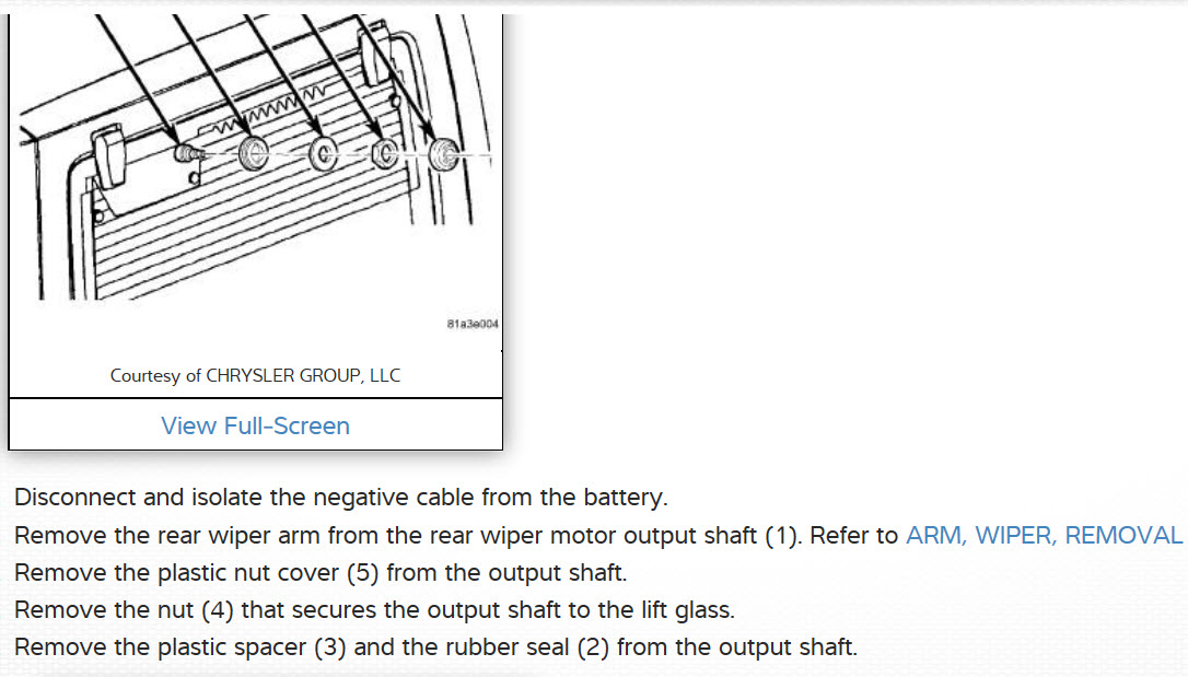

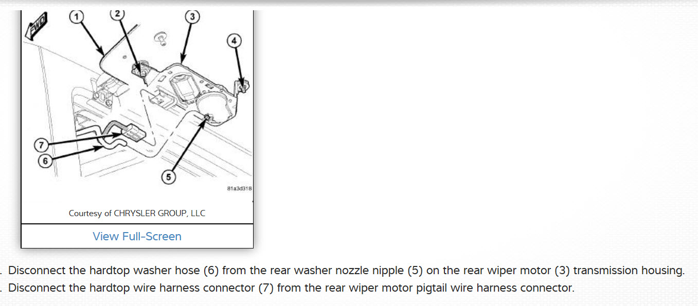

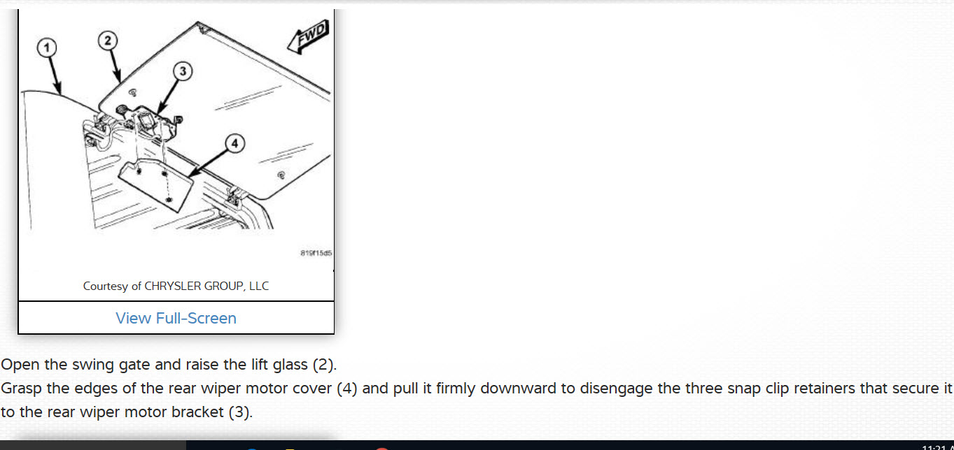

How can I replace my rear windshield wipers ?
Feb 28, 2017 at 4:54 AM
HMAC300
CERTIFIED EXPERT
48,601 POSTS

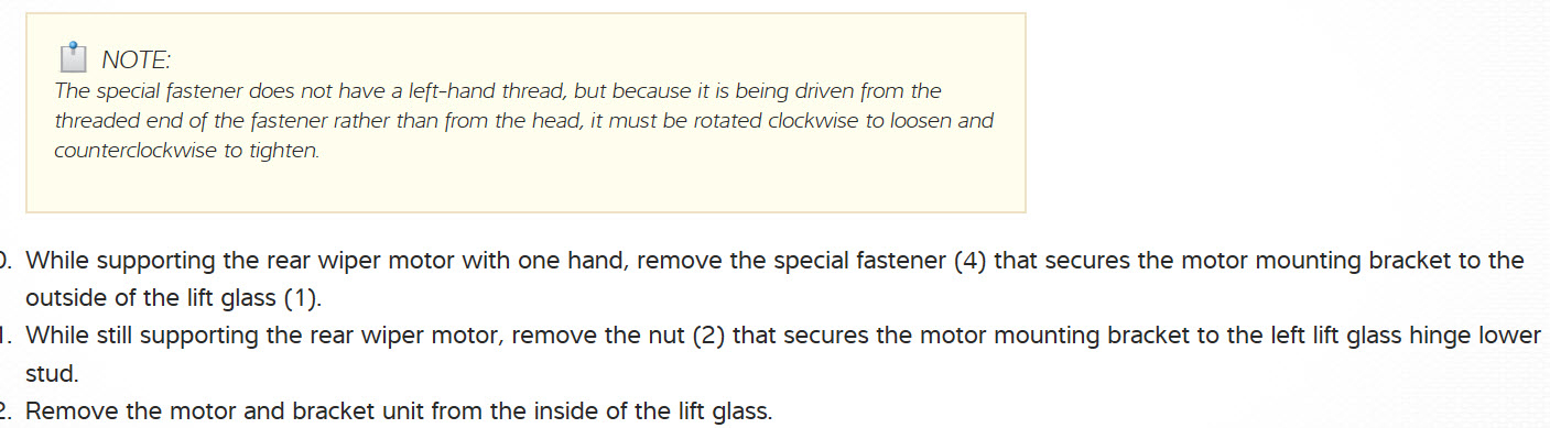

if it does not work check fuses under hood and in car. if blade needs replacing go to auto parts they do for free. if motor does not work have a mechanic scan for codes because it may be something else. other wise see pictures.
Feb 28, 2017 at 8:25 AM
