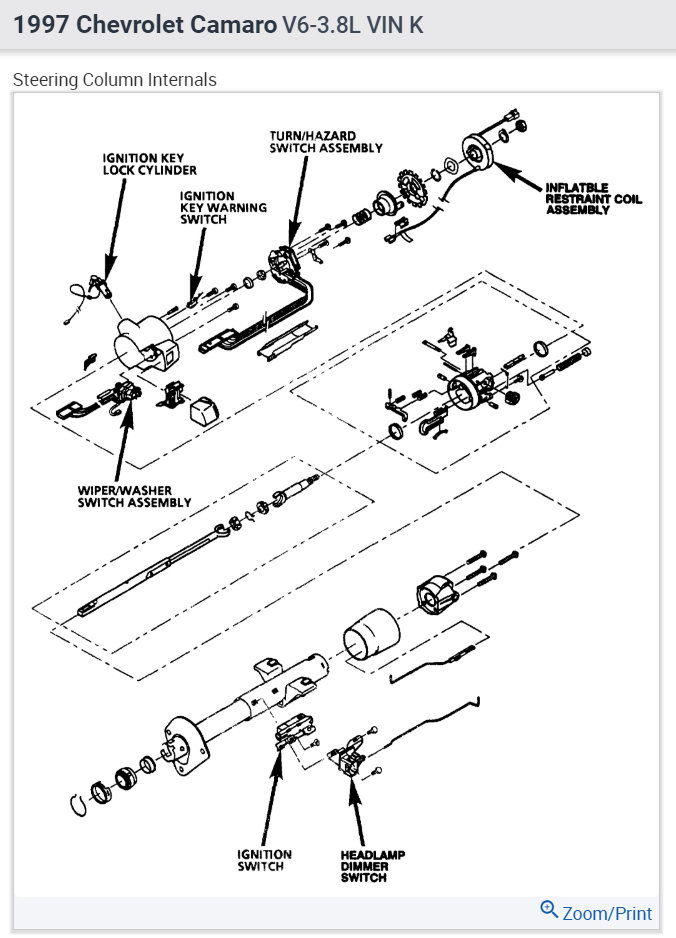

Can I use the much cheaper Dorman 49277 wiper switch without cruise control in my 1997 Camaro?
I might just need Dorman 49265 just the housing for washer switch, that is only thing that does not work just spins around does on and off but no pump or speed control.
Aug 15, 2018 at 11:18 AM
You should be able to the only way to tell for sure is to install it to see what happens. Check out the diagrams (below). Please let us know what happens.

It looks like both would work. Maybe the only difference would be maybe having to re-pin the electrical connector since you would be deleting the cruise control. Hope this helps and let us know how things turn out.Thanks for using 2CarPros.
