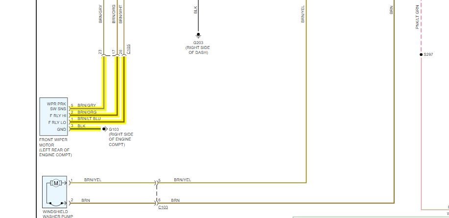

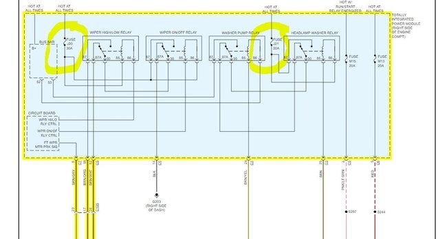

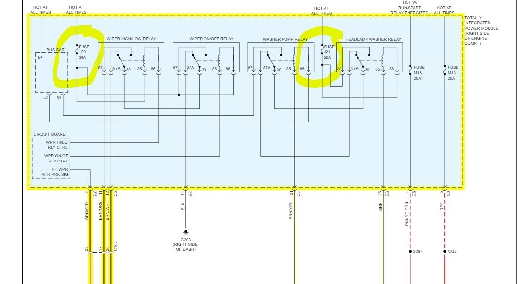

Good evening,
I attached a wiring diagram for you to view. Please tell me the wire you tested for power?
I circled 2 fuses as there are two controls for the internal relays.
The TIPM is a very common failure.

Tested at J20, and at the harness that supplies the motor. J20=good voltage and amps. Harness= good voltage with almost no amp draw. Motor runs when bench testing with boat battery.
Based on the wiring diagram, looks like one or both of the internal relays went out. I’ll order a new TIPM and hope that does the trick.
