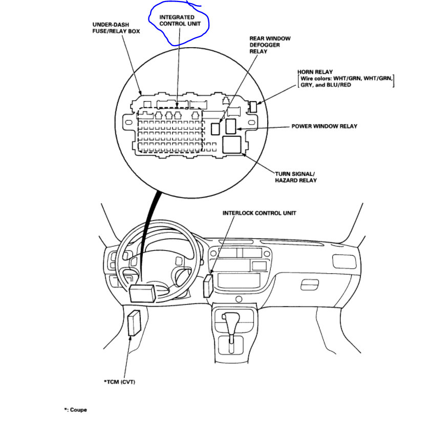

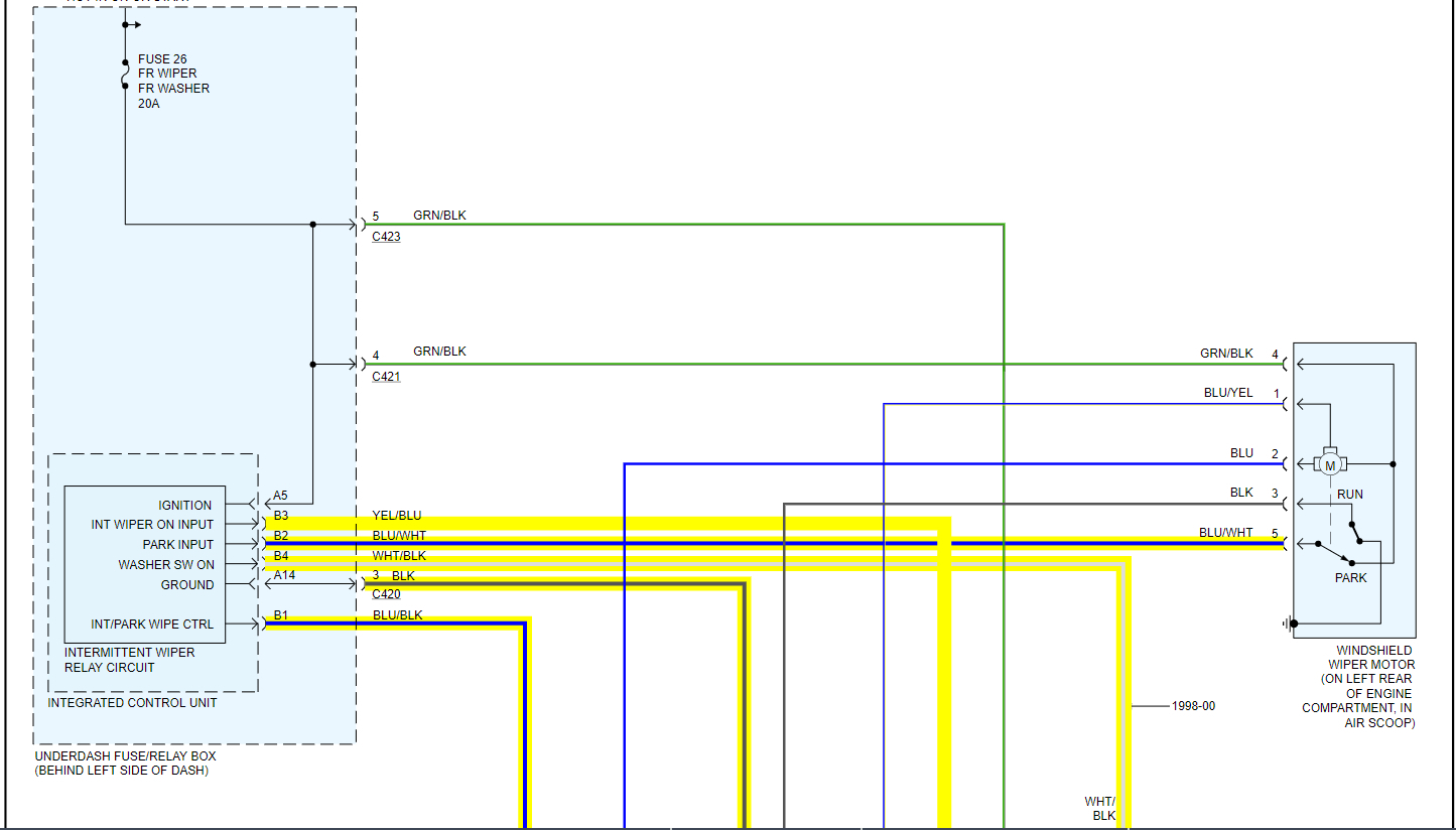

The wipers are controlled by the processor that is located in the under dash fuse panel.

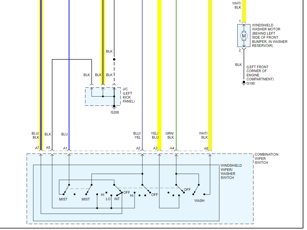

I attached a wiring diagram for you to view. We need to do some tests to determine the actual issue.

This sounds like the control unit is the issue. The fuse block will have to be replaced.

If you looked at the diagram I posted, the processor for the wiper control is part of the under dash fuse block. It is not serviceable and is built into the fuse block itself.

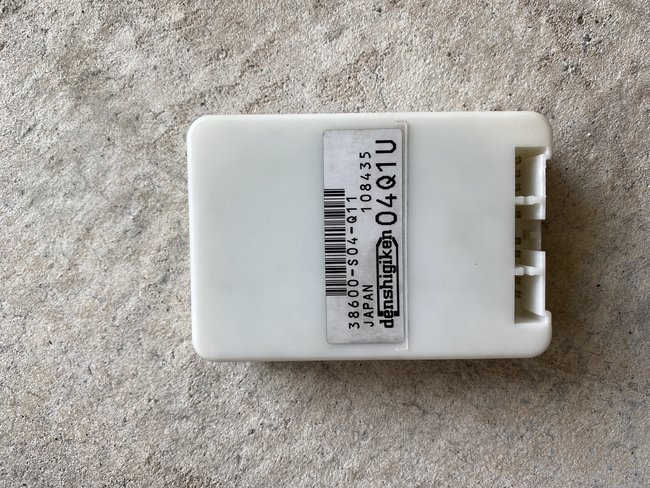

Hey there, after further testing and investigation.
I found out that the relay in the ICU only clicks sometimes, not all the time when i switch to INT on the wiper switch.
Which leaves me to think the ICU is the problem

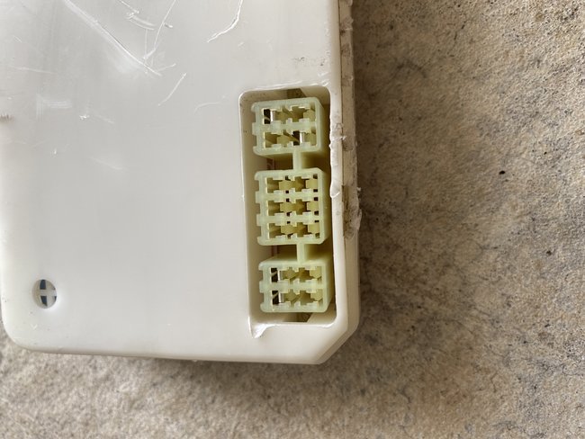

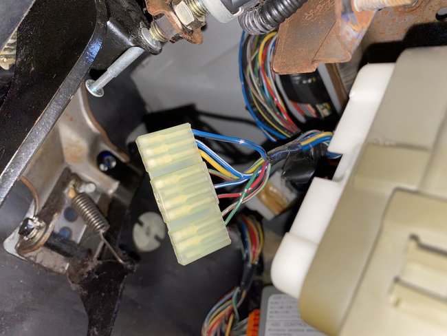

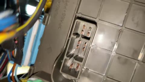

And also when i took apart the ICU. Theres seems to be only 4 connections on the ICU itself but there are multiple connections on the fuse block itself where the ICU plugs in to. Is this normal? Are the rest of the prongs useless or do i have an ICU not meant for this car?
Dec 24, 2020 at 10:33 PM
You can try the ICU. The connections not used are okay, as that may been used in other models.

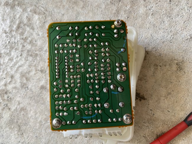

Finally fixed the problem, as i troubleshoot everything else including the wiper motor, switch and wiring.
Everything seems fine which leads me back to the ICU
I tested the ICU again and it only clicks occasionally.
So i took the ICU apart and resoldered every connection on the circuit board itself and it fixed the problem.
There should be a loose connection on one of the solder which explains the relay working occasionally.
Thanks alot for your diagram as that helped me alot in troubleshooting and minimizing the problem.
