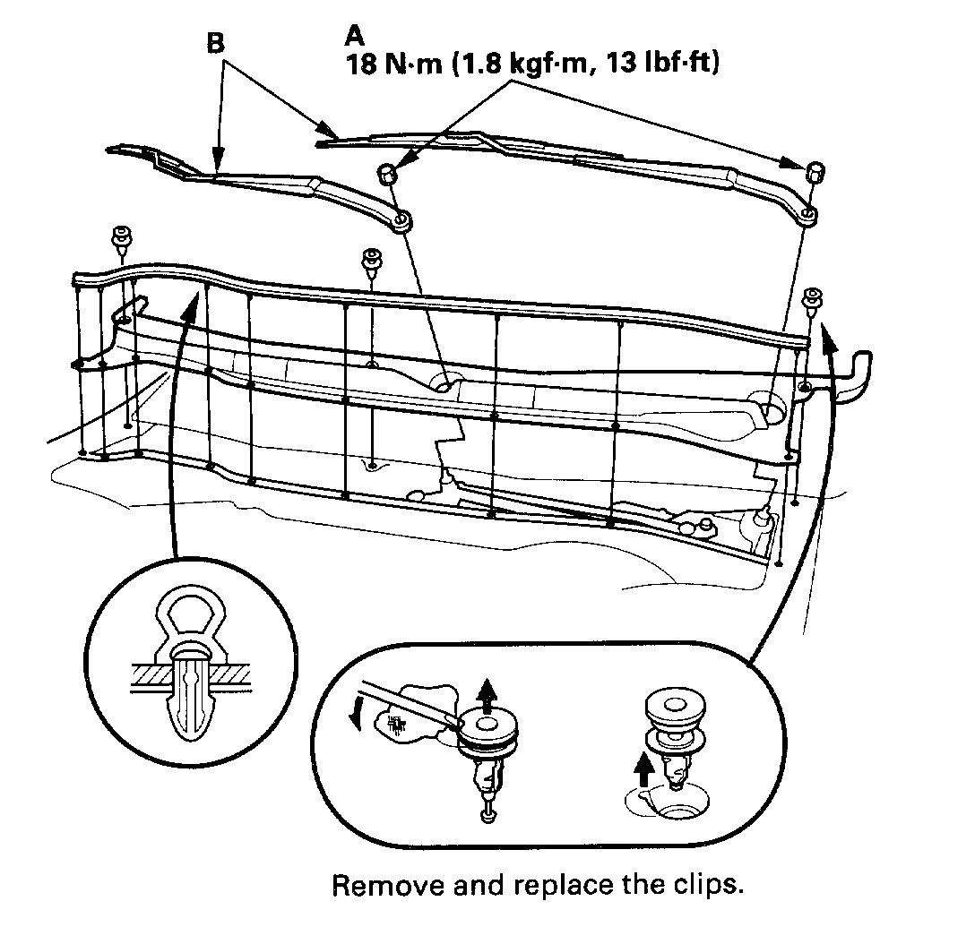

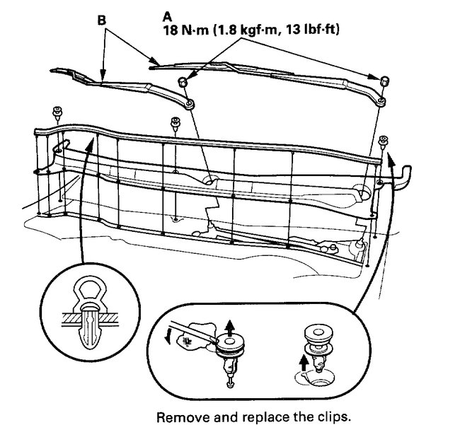

1. Remove the nuts (A) and remove the windshield wiper arms (B).
2. Remove the hood seal and cowl cover.

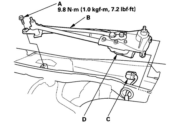

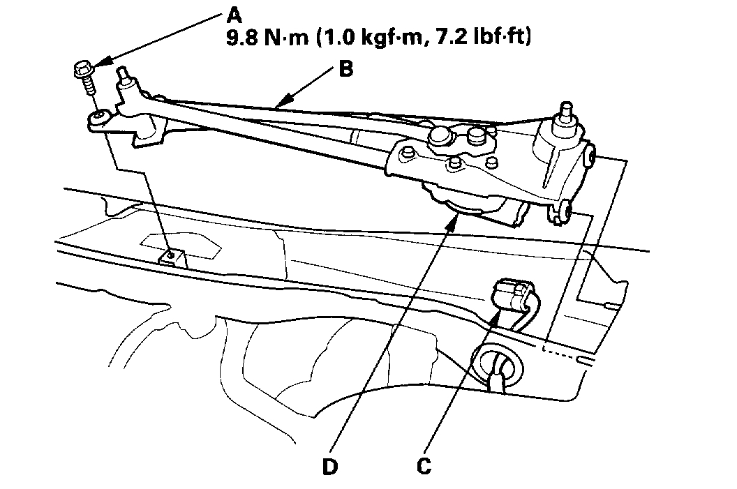

3. Remove the bolt (A) and windshield wiper linkage assembly (B).
4. Disconnect the connector (C) from the wiper motor (D).

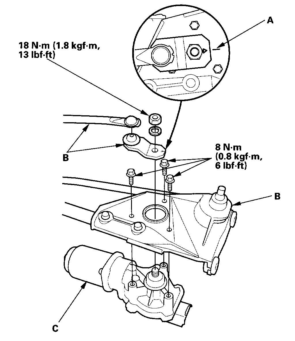

5. Scribe a line (A) across the link and windshield wiper linkage to show the original adjustment. Separate the windshield wiper linkage (B) from the wiper motor (C).
