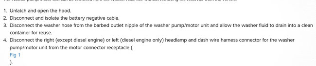

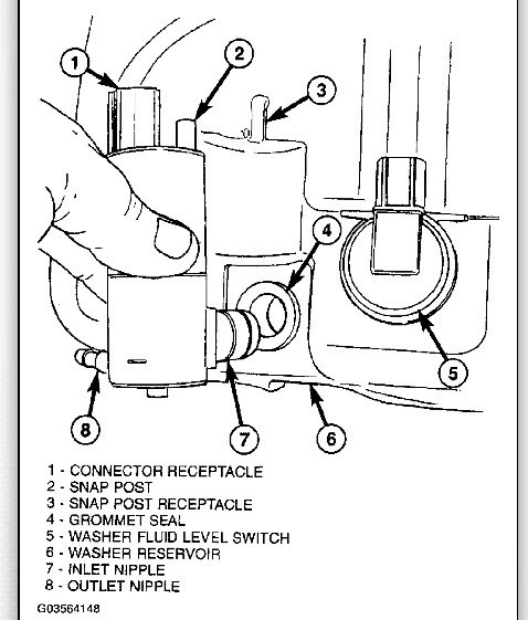

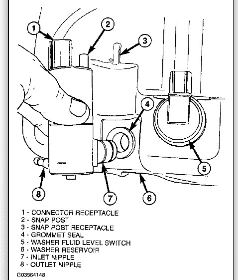

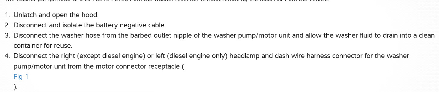

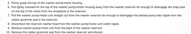

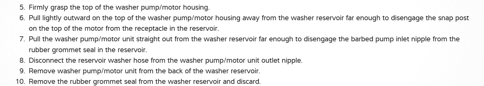

How to change washer pump?
Jun 29, 2016 at 7:21 AM
HMAC300
  • 48,601 POSTS
see pictures for instructions reverse for reassembly. you may have to reset security system if truck does not start.
