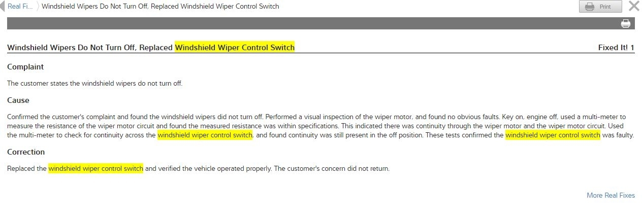

I did a little research on your issue and found that the most common problem is the switch itself. I attached a picture which is from Mitchel service manuals online which indicates the same issue and how they fixed it.
Take a look at it and let me know your thoughts.
