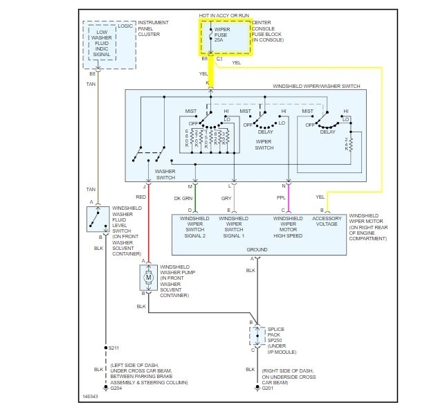

Windshield wipers not working. I turn the switch nothing happens. There isn't any noise, movement.
Jun 25, 2019 at 1:50 AM
Good morning,
You need to start with checking the fuse. Verify power on both sides.
https://www.2carpros.com/articles/how-a-car-fuse-works
Beyond that, you need to check for power to the switch at the yellow wire in the switch.
