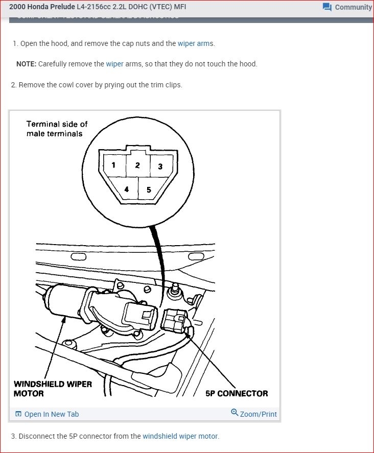

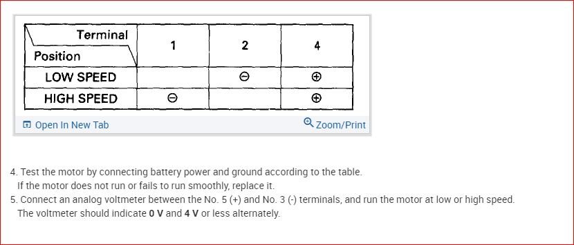

If so, I would suspect your motor is the issue. Attached is the test to verify. If you put power to it as it states and it still runs slow then you know it is the motor. Basically, you are eliminating all wiring and controls and just testing the motor. If it acts the same, then the motor is the issue.
Let me know if you need more assistance or if this is not what you are experiencing. If they are slow on all settings then there is a chance the linkage connecting the motor to the wiper arms is binding but it appears it is just the high setting. Thanks
