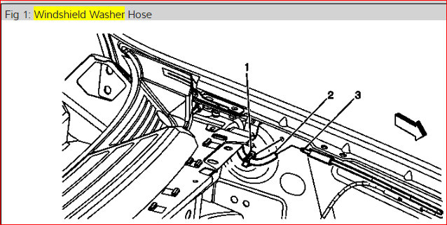

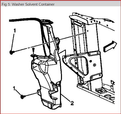

I've attached two pictures below.Hope this helps and feel free to ask questions if needed. This video shows the washer reservoir being replaced.
https://youtu.be/ezjJz_N5cFQ
Check out the diagrams (Below). Please let us know what you find. We are interested to see what it is. Thanks for using 2CarPros.

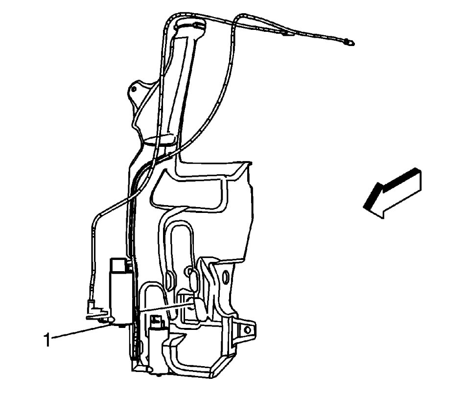

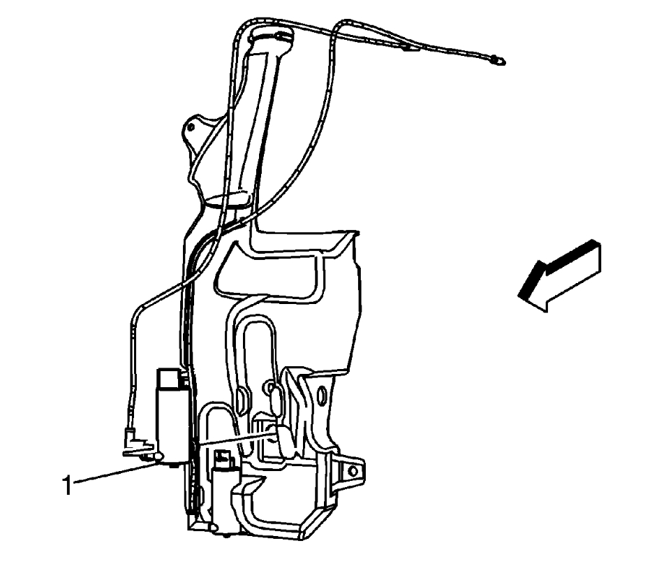

My rear windshield washer is not working. When I looked at it I have a portion of the hose hanging out under the wiper blade. I have tried to find a drawing of how they are supposed to go so I can fix it but have had no luck.
Jan 27, 2021 at 10:32 AM (Merged)
Here are diagrams for the rear washer hose routing to the pump. Check out the diagrams (Below). Please let us know if you need anything else to get the problem fixed.

The front windshield wiper reservoir has a hole in it and won't hold fluid. The reservoir needs replaced. I'd like to replace it myself. What is involved in removing and replacing this reservoir?
Jan 27, 2021 at 10:33 AM (Merged)
SMJIM
I had to pull the battery and battery tray and the left fron fender inner plastic panel to gain access.
By battery had leaked and took out the bottle and rear wiper pump.
Pain in the neck but for a few $$ of parts I had it all back up. Dealer wanted $200 plus for labor.
I would recomment replacing the tank and both pumps and do the job once. Pick up a package of the plastic retainers for the fender liner as some of mine broke on the way out.
