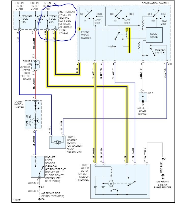

Replaced motor twice because they wouldn't work. The fuses are good and yet still not working.
Jan 20, 2022 at 5:46 AM
CERTIFIED EXPERT
52,796 POSTS
Good morning,
I attached a wiring diagram for you to view. Check the fuse I circled for power on both sides with a test light.
Also, test the two wires I highlighted at the wiper motor with the key in the on position.
Let me know the results so we can proceed.
