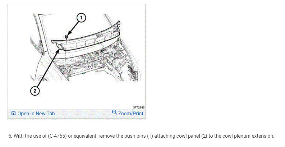

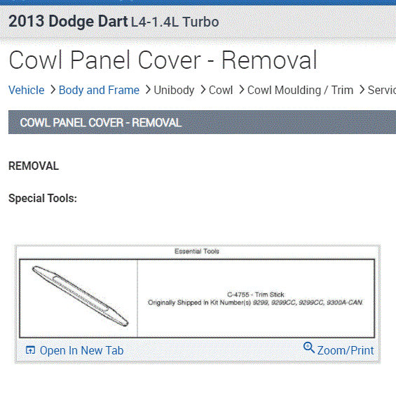

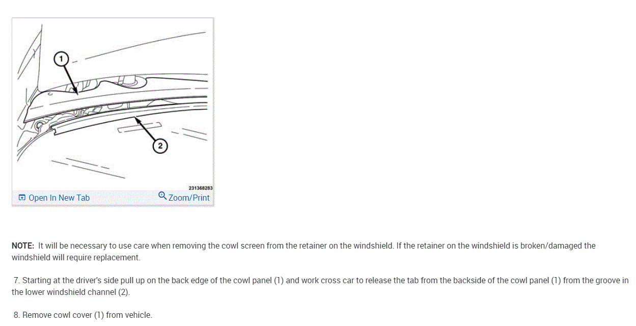

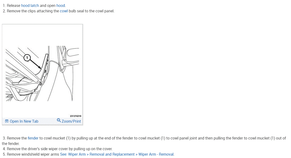

The wiper motor is located under the cowl. If you look at the directions below, they provide the directions to remove the cowl. Once it's off, you should be able to disconnect the motor.
If you decide to repair the wiring, let me know exactly what has been damaged and I'll get you the info needed to make repairs.
Take care and Happy Thanksgiving,
See pics below.
