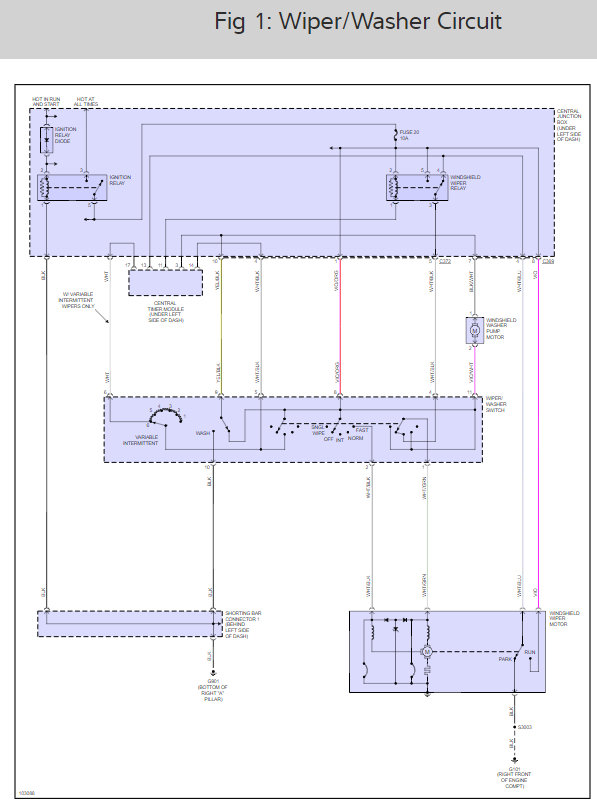

Weather below freezing pump stopped working. Is there a fuse?

Hello, sorry to hear. since it is below freezing the fluid may actually be frozen. have you checked that? The fuse is fuse 20, picture attached.

Thank you, very helpful. i did notice ice in the bottle in the trunk that I just bought.
