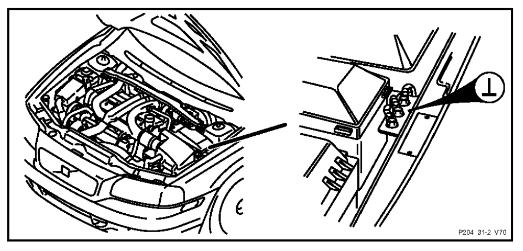

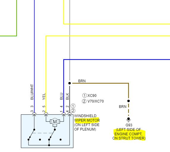

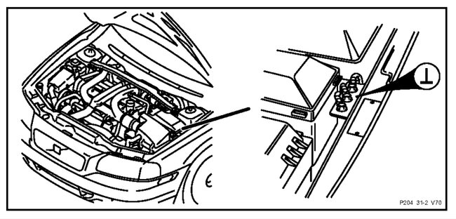

The ground wire will be brown. Its grounding point is the left front strut tower. See pics 1 and 2
Try to splice a new ground wire in place at the wiper connector and as a test, ground it to the negative battery cable to see if things work properly at that point.

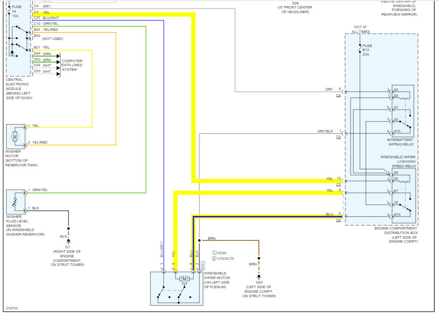

If you are not getting power to the yellow or blue wire, I think the low/high wiper relay is bad or we have a connection issue. At least, that is what we need to check next.
If you look below, I highlighted the power wires for the motor to run. Both of these wires come through the relay.
The relay is under the hood. See pic below. Remove the relay and if there is another one having the same part number, switch them. If there isn't, inspect the connectors on the relay and where it mounts. Make sure they are clean, and tight, and there are no corrosion issues. If you want to physically test it, here is a link that explains how to do it:

If the relay is getting power to it (pin 86) and then power is sent out via pin 87 or 87A, the motor must be the problem. However, you indicated there was no power to either the blue wire or the yellow wire at the wiper motor. Is that correct?
Just as a check, disconnect the motor and run battery voltage to the blue wire. Does the wiper motor turn run?

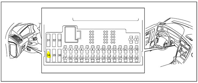

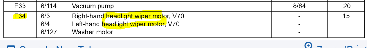

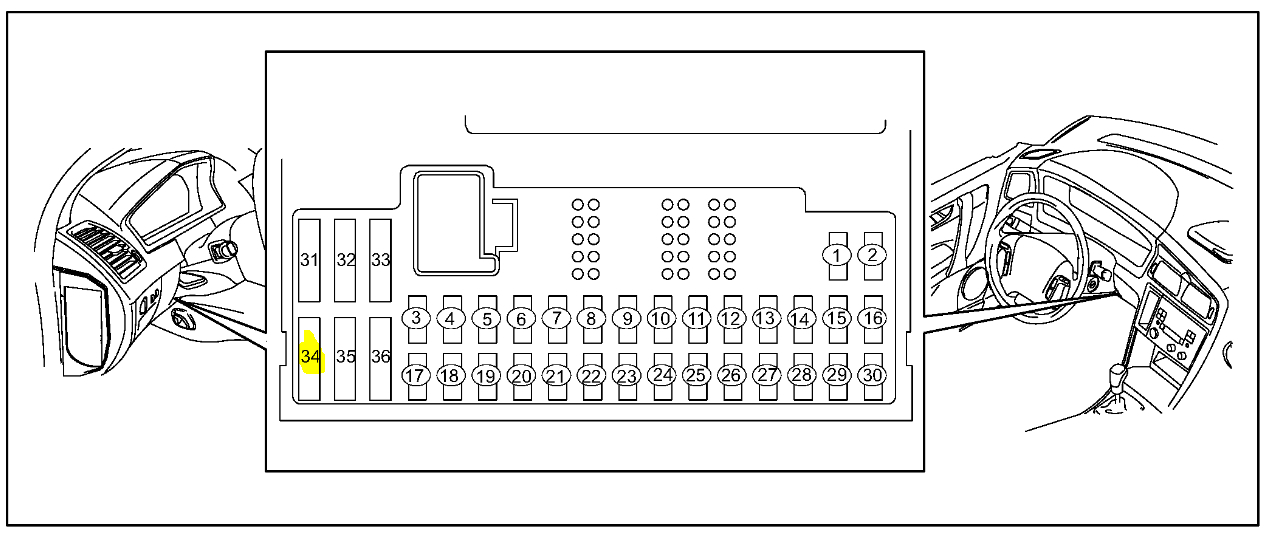

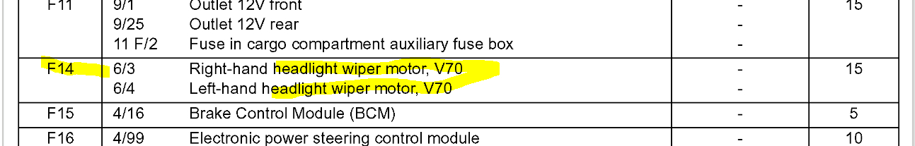

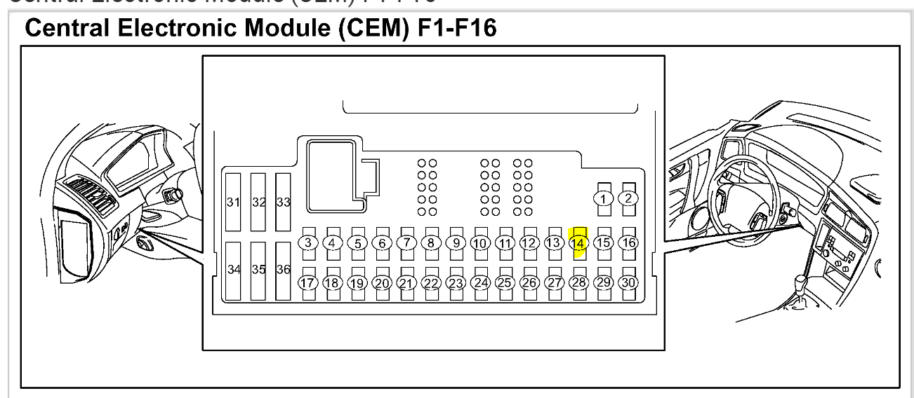

I have one last fuse to check. Also, please confirm for me that pin 85 of the high/low relay isn't getting power with the key on and the switch on high or low.
Also, check fuse 34 under the dash on the left side as well as fuse 14. I'm looking at the legend for the wiper motor and it is showing two different fuses for the headlamp wiper motor. Ugh!!! One is likely listed wrong.
See pics below.

Hi Joe, I checked the fuse with the multimeter and it is good.

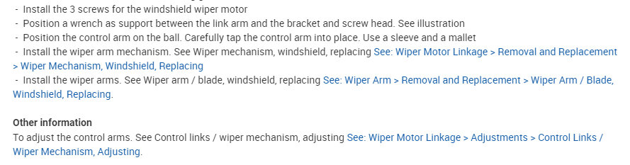

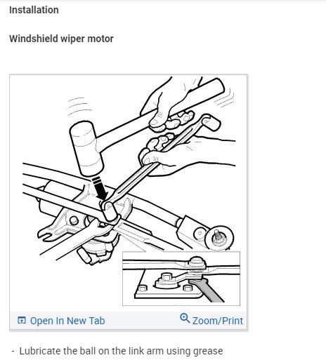

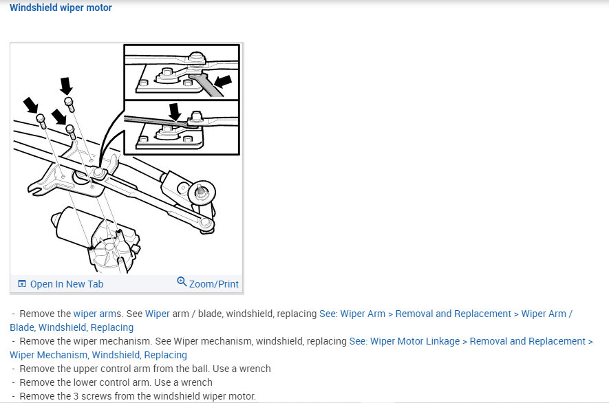

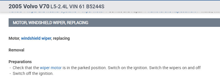

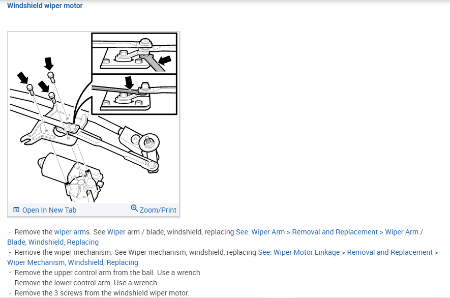

Okay. Based on all the tests, it sounds like the motor itself is bad. If you look below, I attached the directions for the removal and replacement of the motor.
Take a look through them and let me know if you have questions.
Let me know how things turn out for you.
joe
See pics below.
