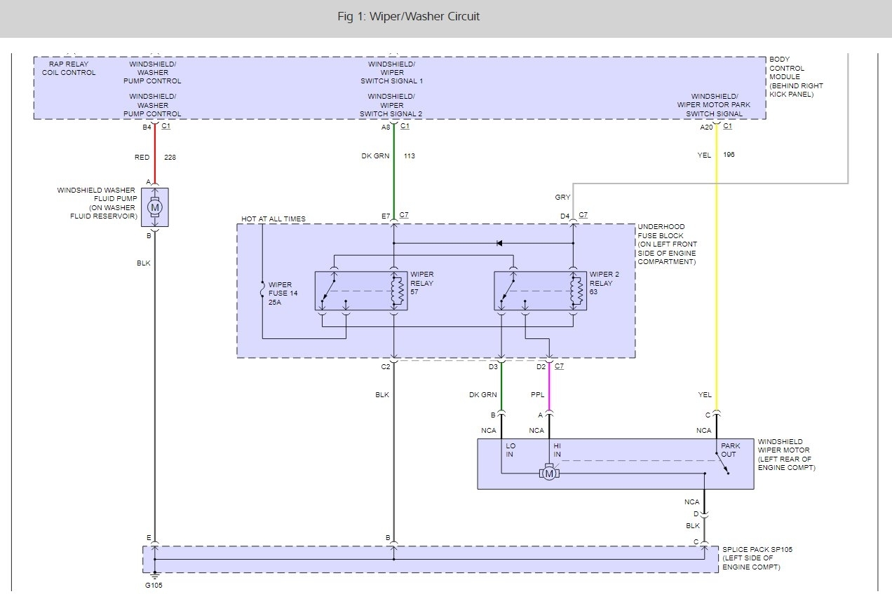

Does not turn off automatically.
Jun 24, 2017 at 3:29 PM

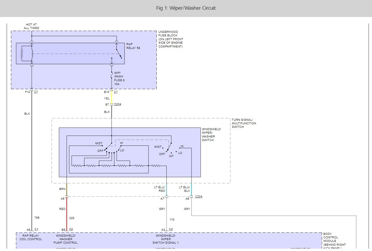

A couple of things come to mind, first is you have a relay sticking which will keep the washers going. Next is the BCM is having a problem. Here is a guide and a diagram (below) that will help you do some testing to see what the problem is and get it fixed.
and
Please run some tests and get back to us so we can continue helping you.
