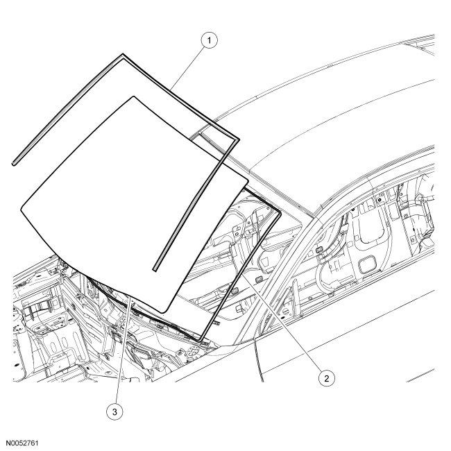

That moulding is replaced with the windshield usually, but is not responsible for sealing the windshield in any way. Urethane sealer between the body and the windshield take on that job.

Minor, it's just for aesthetics.
