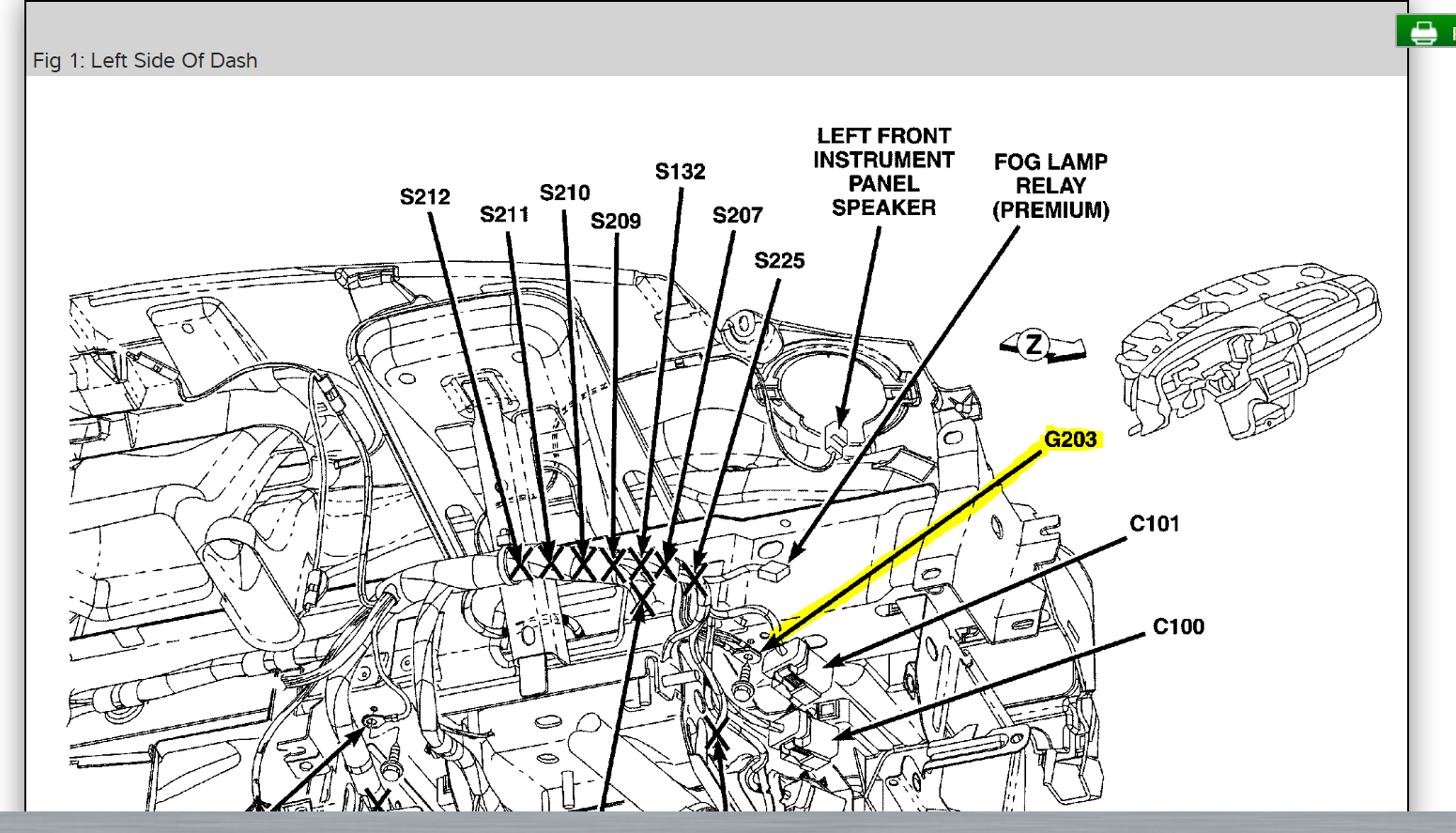

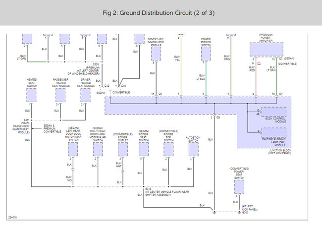

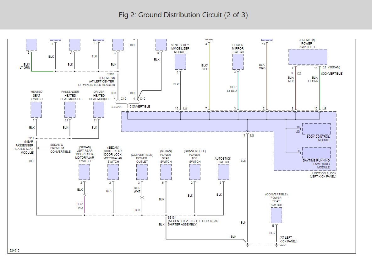

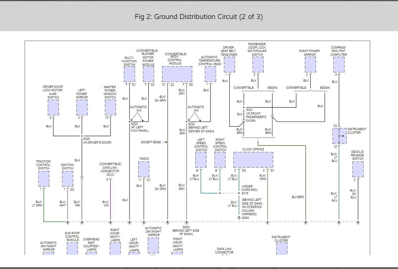

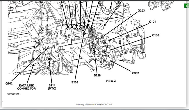

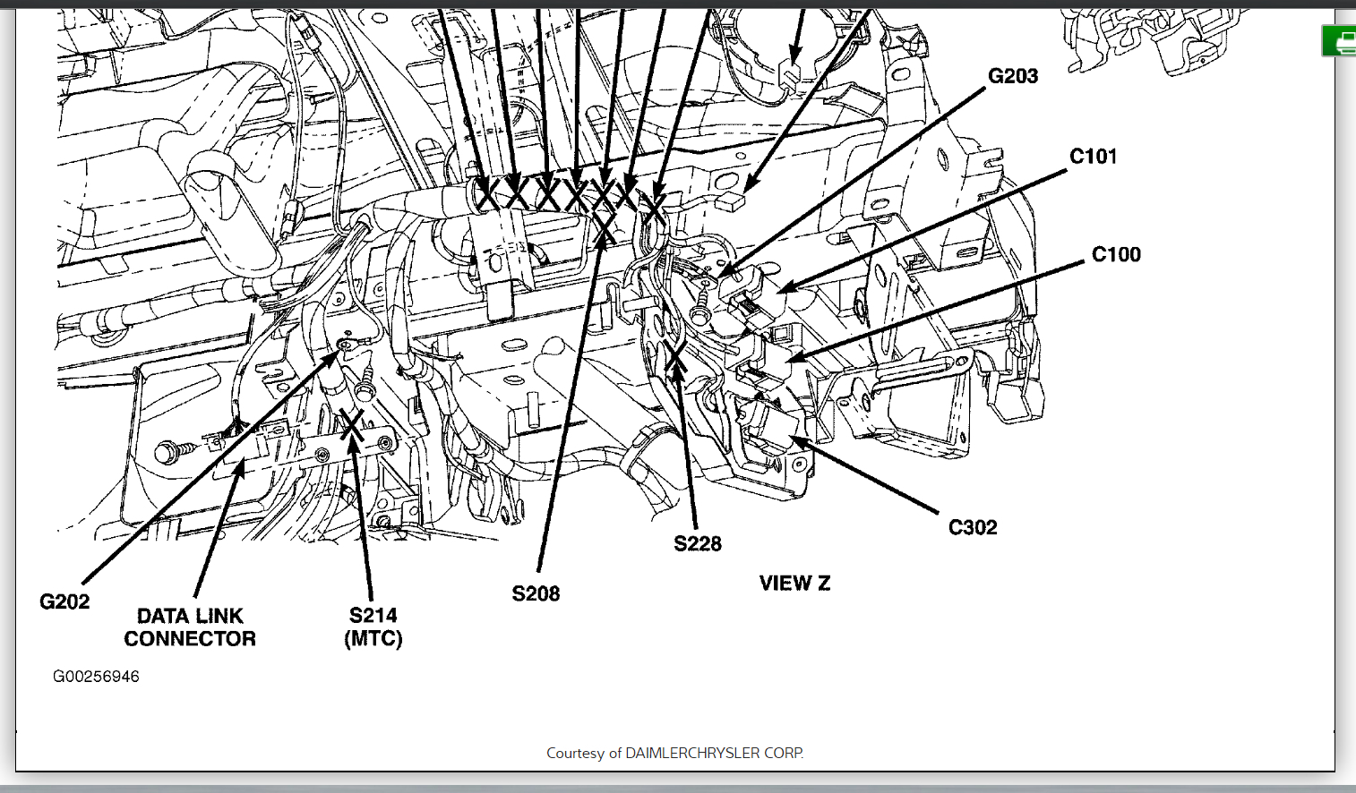

This could be a problem with Ground #203 which is located behind the left side of the dash. I have included in the diagrams down below a ground distribution wiring diagram showing the circuits that ground to Ground #203, as well as a diagram showing where Ground #203 is located in your vehicle. Ground #203 is highlighted of course. Please make sure that this ground is tight, corrosion free, clean, and making good metal to metal contact and get back to us with what you are able to find out.
