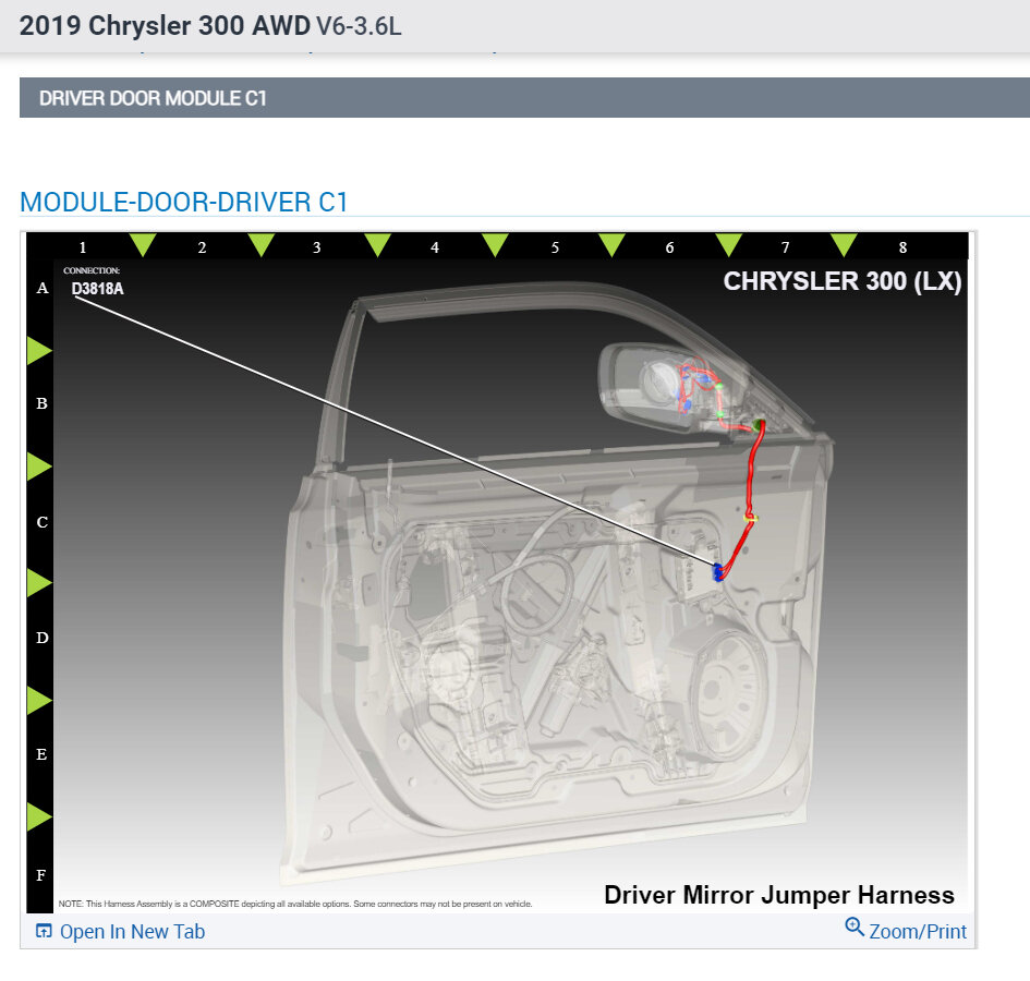

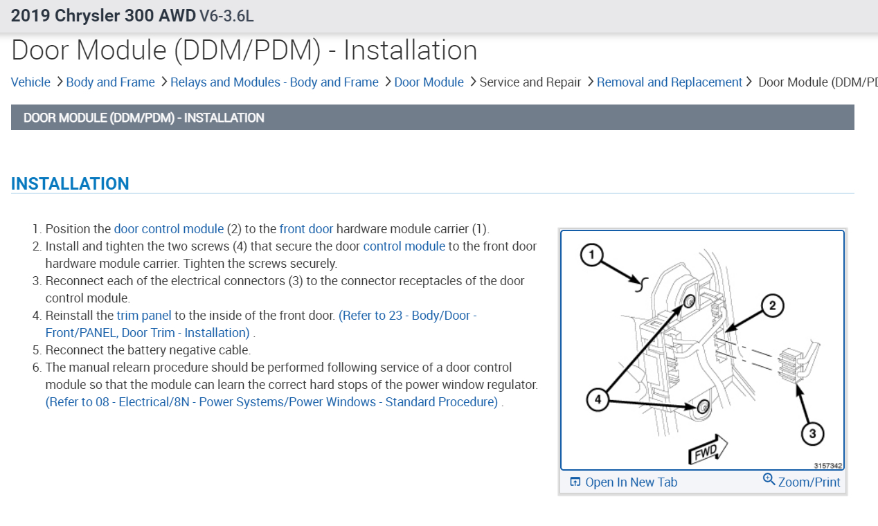

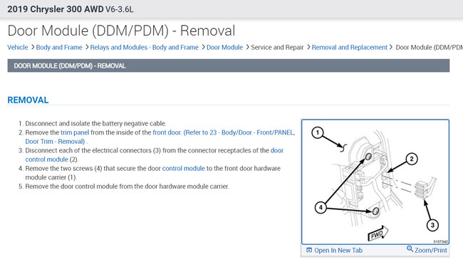

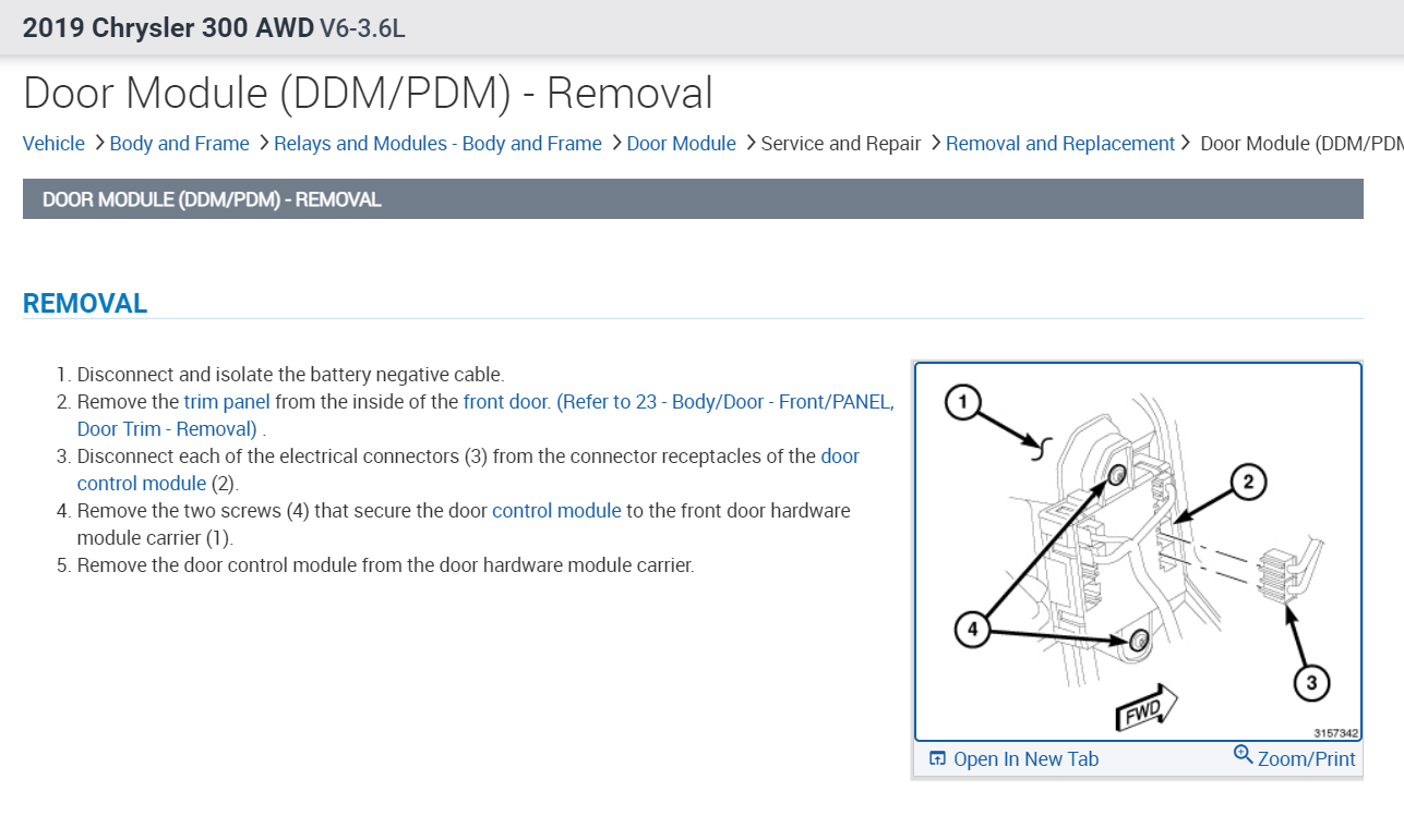

First, I would check fuses # 64 circuit breaker, #11 and # 10 in the rear fuse panel, if they are good the driver's door module has gone out and needs replacement. Here is the location and how to replace it in the images below. Please let us know if you need anything else to get the problem fixed.
