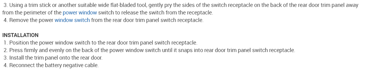

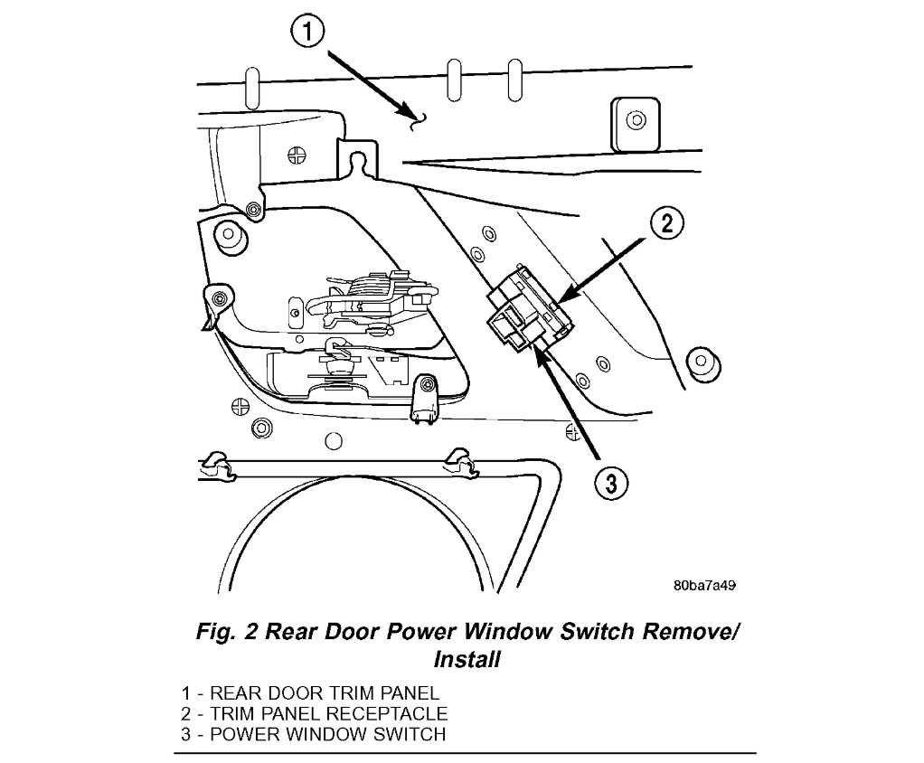

This sounds like the main window switch went out which is common. To be sure here is a guide to help you test the switch with diagrams below on how to replace it:
https://www.2carpros.com/articles/electric-window-repair
