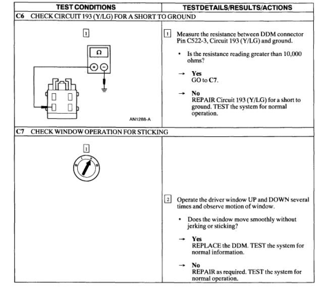

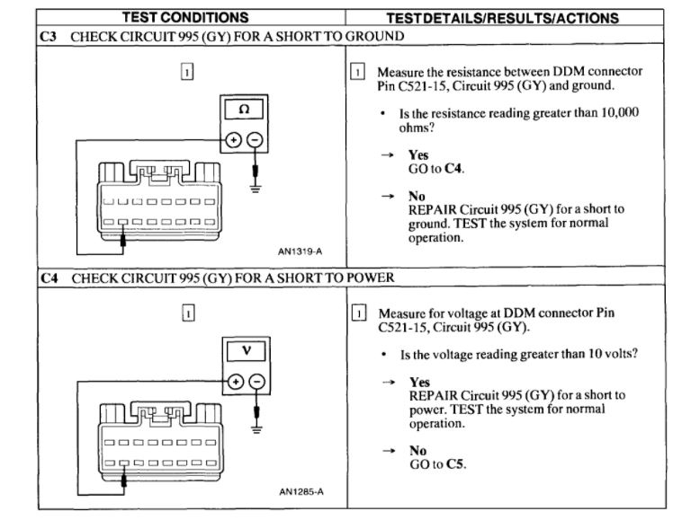

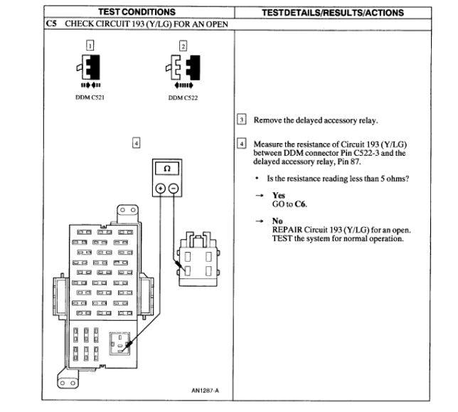

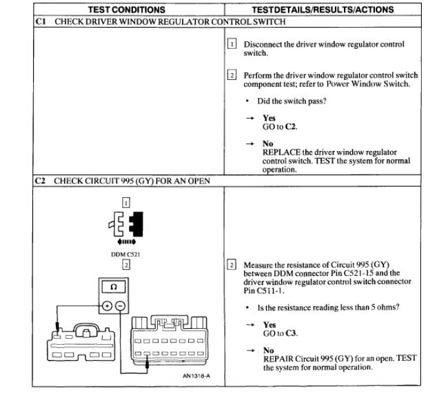

Can you post the part number of the door module you currently have in the door?
I attached a flowchart for you to view. Just want to be sure the module has actually failed.
