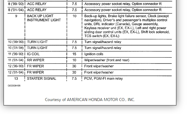

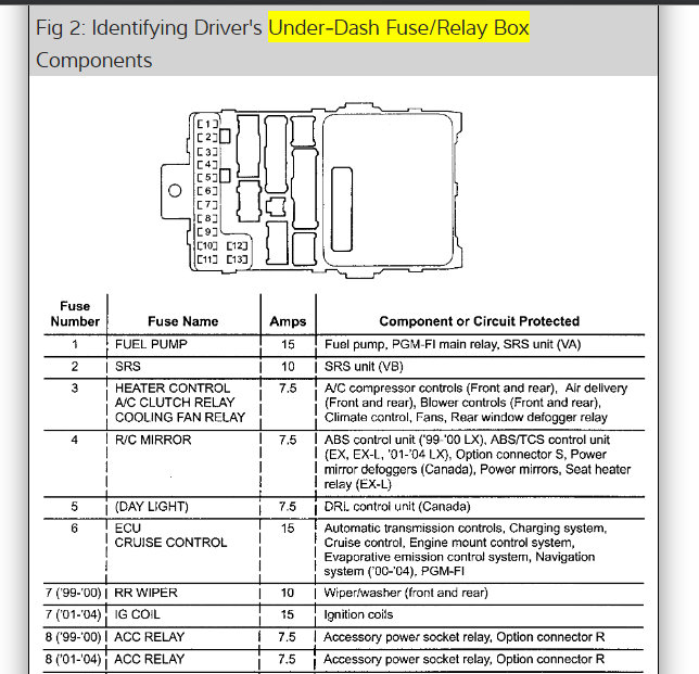

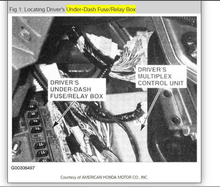

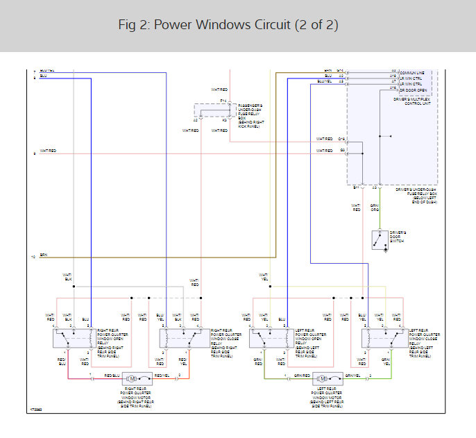

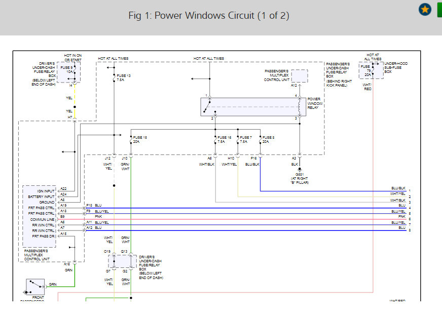

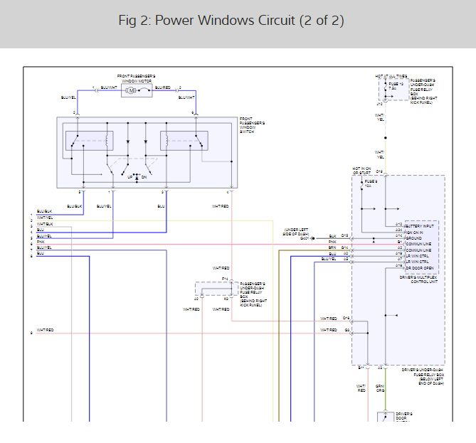

I have included the information that you requested in the diagrams down below. I have included the wiring diagrams for your power windows as well as the diagram, location, and callout for the under dash fuse panel for your vehicle. Please go through these guides and get back to us with what you are able to find out.
