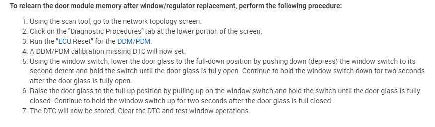

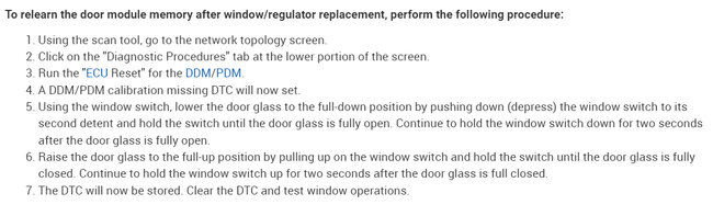

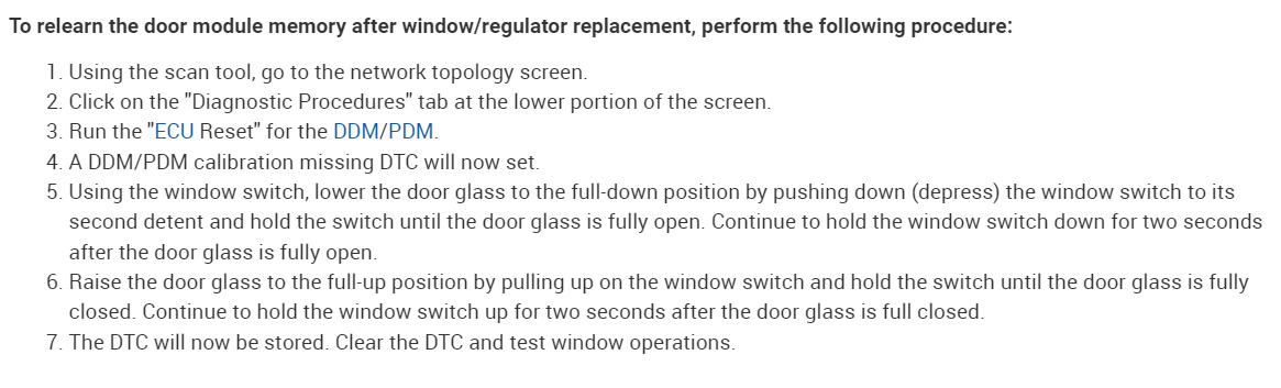

If none of the aforementioned information seems like a possibility, then you will need a scan tool that can communicate with the door modules for reprogramming. I attached the directions below for that procedure.
