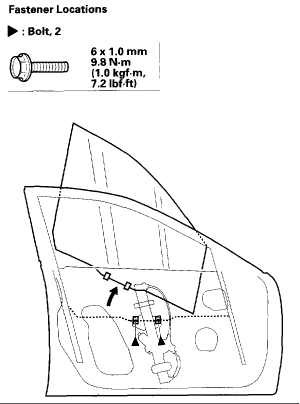

Carefully raise the glass until you can see the bolts, then remove them. Carefully pull the glass out through the window slot. Take care not to drop the glass inside the door.

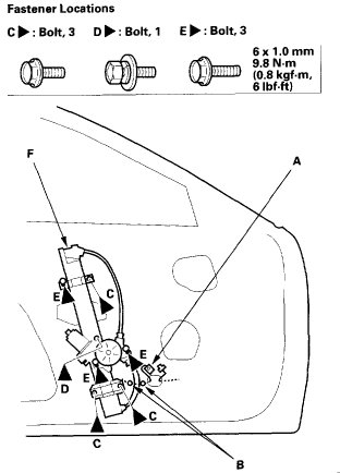

Disconnect and detach the connector (A) and harness clip(s) (B) from the door. Remove the bolts (C, D) and loosen the bolts (E), then remove the regulator (F) through the hole in the door.

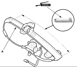

Apply multipurpose grease to all the sliding surfaces of the regulator (A) where shown.
