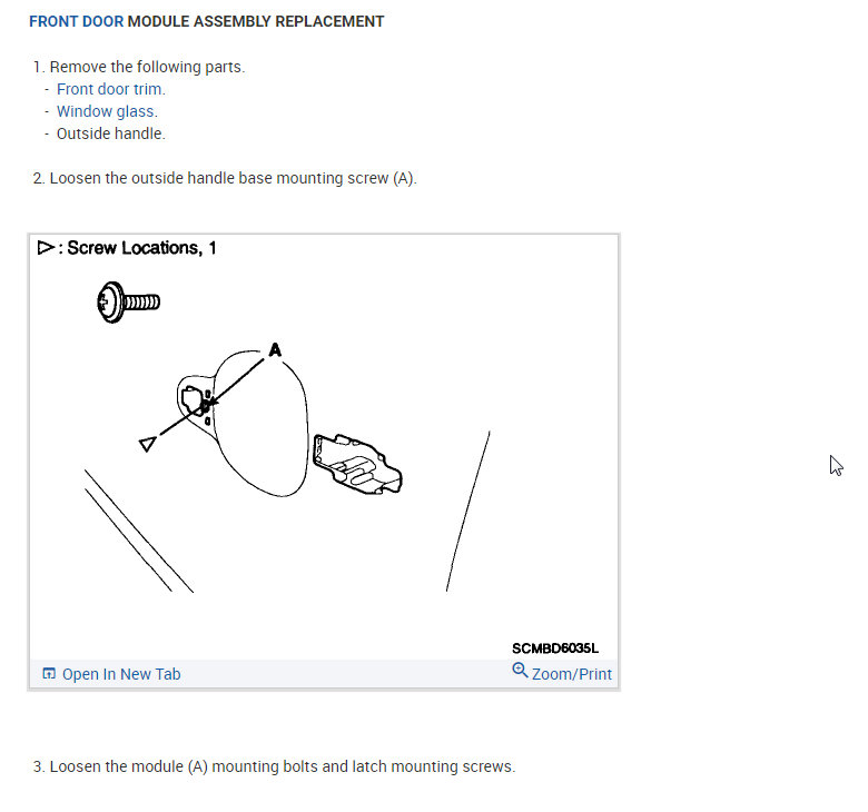

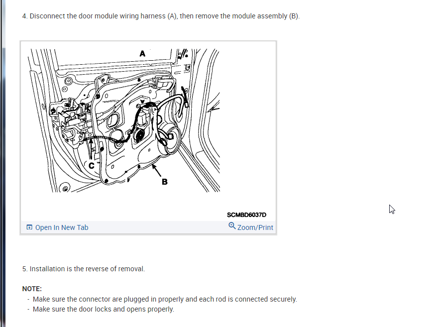

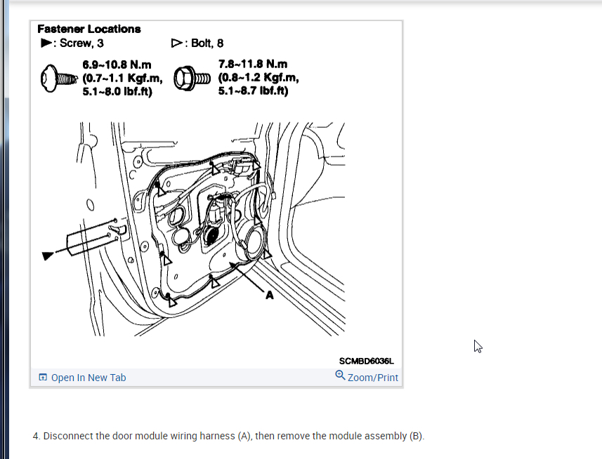

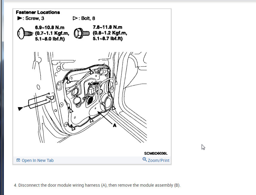

Unfortunately we are going to have to remove the door panel and replace the regulator. Here is a guide for both of these:
https://www.2carpros.com/articles/how-to-check-and-replace-a-electric-power-window-motor
https://www.2carpros.com/articles/door-panel-removal
Also, below is the process from the manual to replace the regulator. Let us know what questions you have. Thanks
