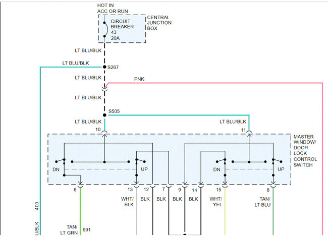

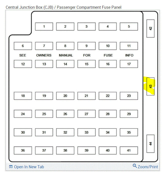

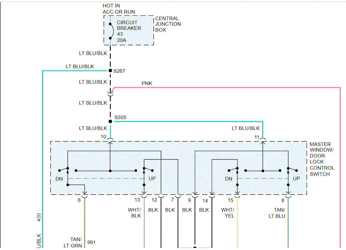

The first thing to do is check circuit breaker number 43 in the central junction box. See pic 3 below. If it is good, confirm there is power to and from it.

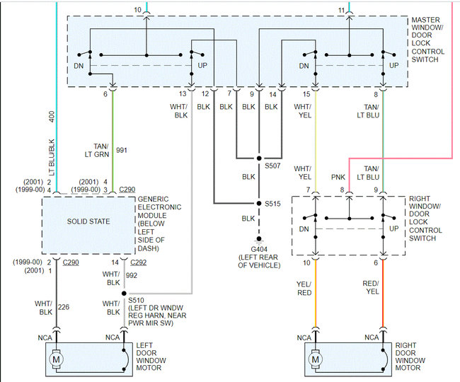

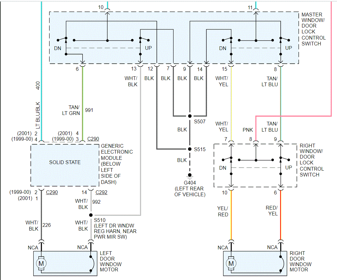

Next, check the light blue/black wire at the master window switch for power. It should have 12v when the key is on. Note: I attached the entire wiring schematic for the power windows for your review. See pics 1 and 2. I had to cut the schematic in half to make it readable. I did overlap the two so you can follow them easier.

Yes, those are both testing good.

Note: When you select up on the switch, power should only be sent to one of the wires, not both. Also, you mentioned the blue wire, which is before the gem module. Are you actually at the motor?

Okay, it was the gem module. i watched a video on YouTube of a guy who bypassed it and tried that and it will work like that. I will probably end up getting one from junkyard. thanks.

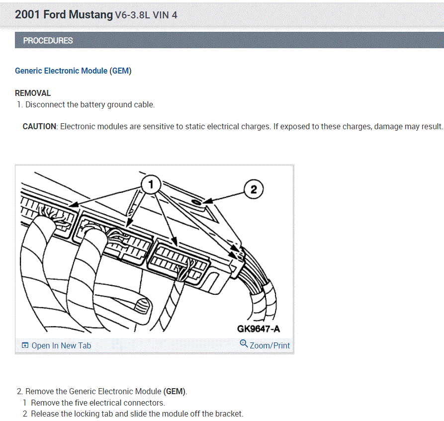

I'm glad to hear you found it. I had a feeling you were checking before the GEM. If that is what you were doing, then it makes sense that the problem was the gem.

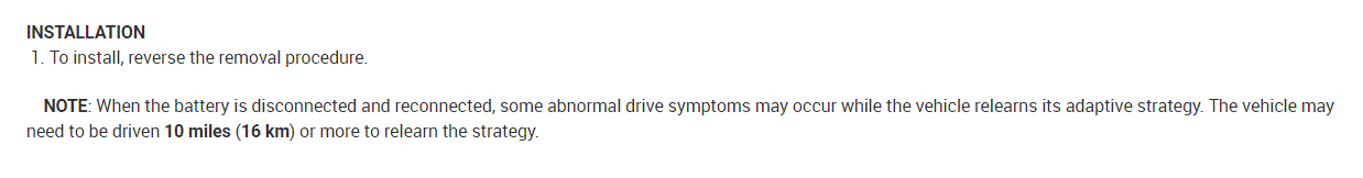

Regardless, I'm glad you found the problem. I don't know if you need them, but the attachments below are the directions and pic specific to your vehicle for GEM replacement.
