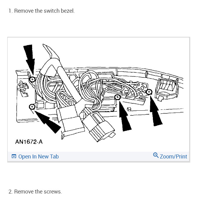

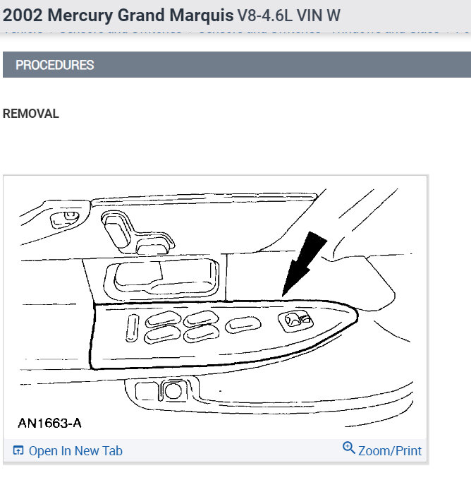

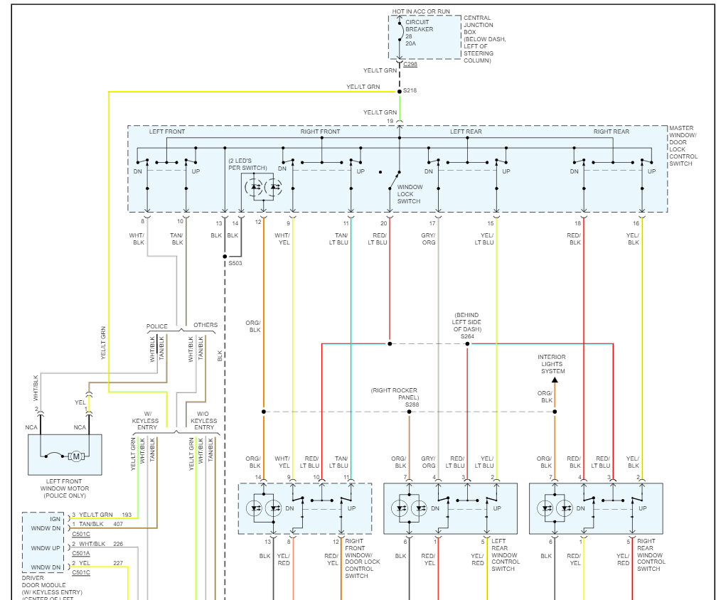

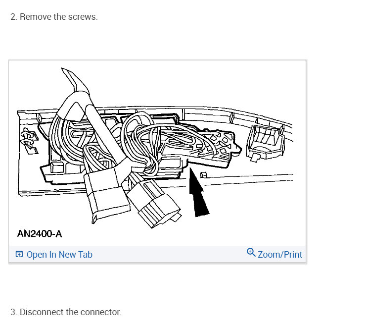

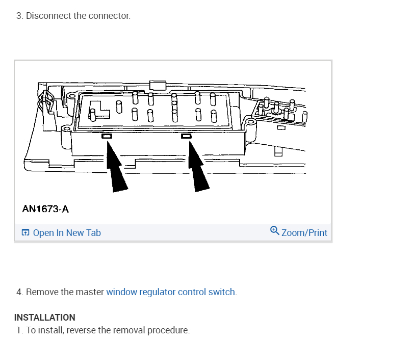

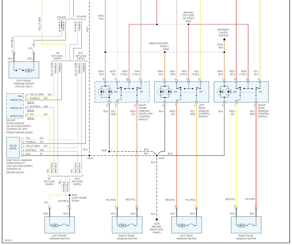

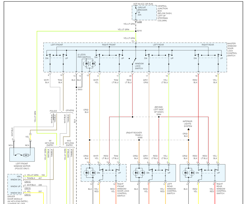

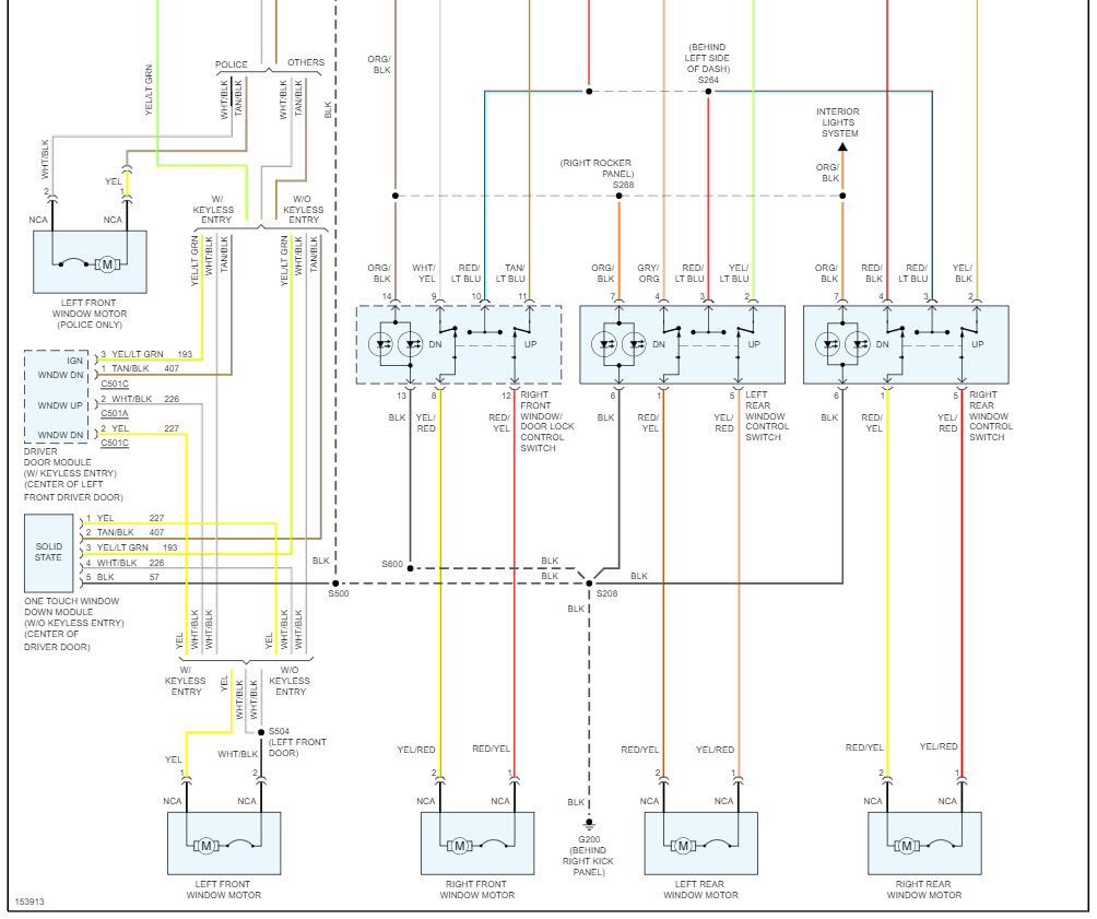

It sounds like the switch has gone bad, but to be sure this guide can show you how to check the power and ground for the window operation. Also, I have included the window wiring diagrams to help you see how the system works and which wires to test.
https://www.2carpros.com/articles/electric-window-repair
Check out the images (below). Let us know what happens and please upload pictures or videos of the problem so we can see what's going on.

The window commands get sent through the switches, you must have a broken wire or a bad switch, you can use the wiring diagrams above and this guide to help check the connections and through the switches:
It sounds like the passenger's side front switch is bad, you said all the windows work with the driver's door main switch?
