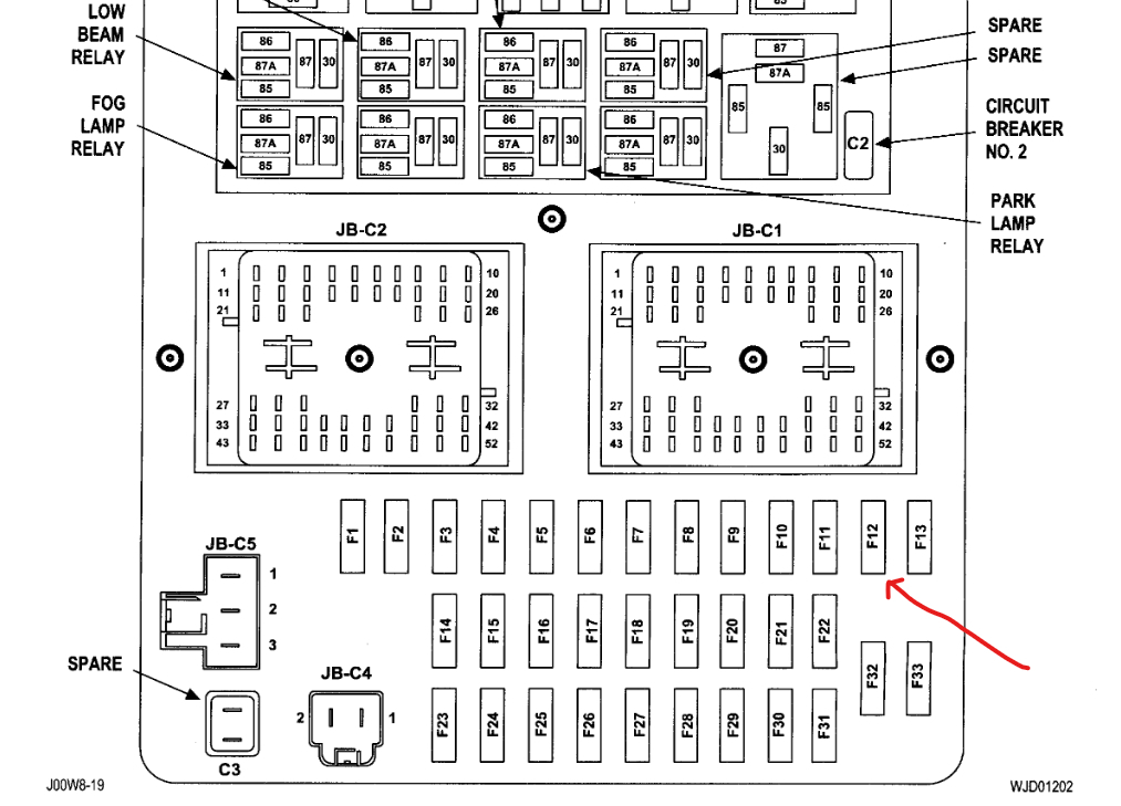

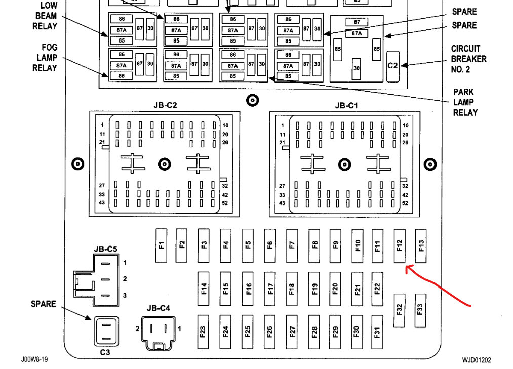

I would start by checking fuse #12 in the PDC under the hood.
Here is a guide to help:

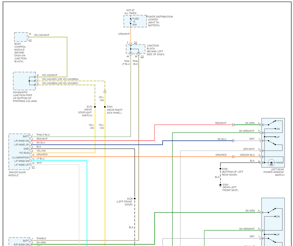

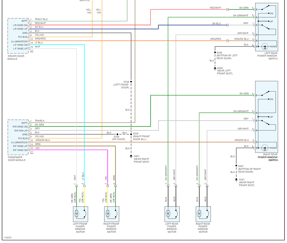

I have included the window wiring diagrams as well so you can see how the system works. Check out the images (below). Please let us know how it goes.
