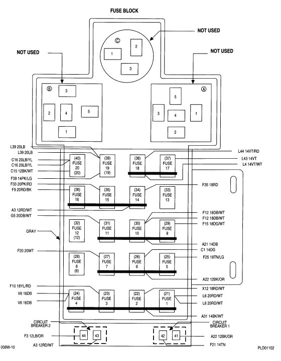

There is not one. There is a 30 amp auto resetting circuit breaker. It is on the lower right corner of the fuse box (breaker 1) and powers both windows. Check out the diagrams (Below). Please let us know if you need anything else to get the problem fixed.
