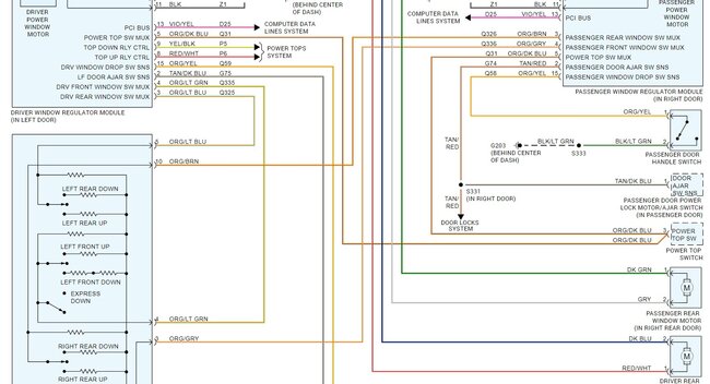

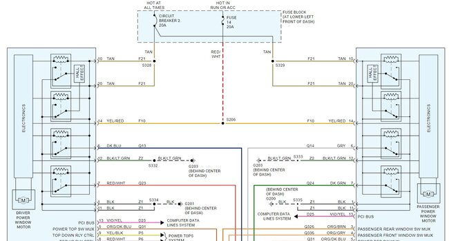

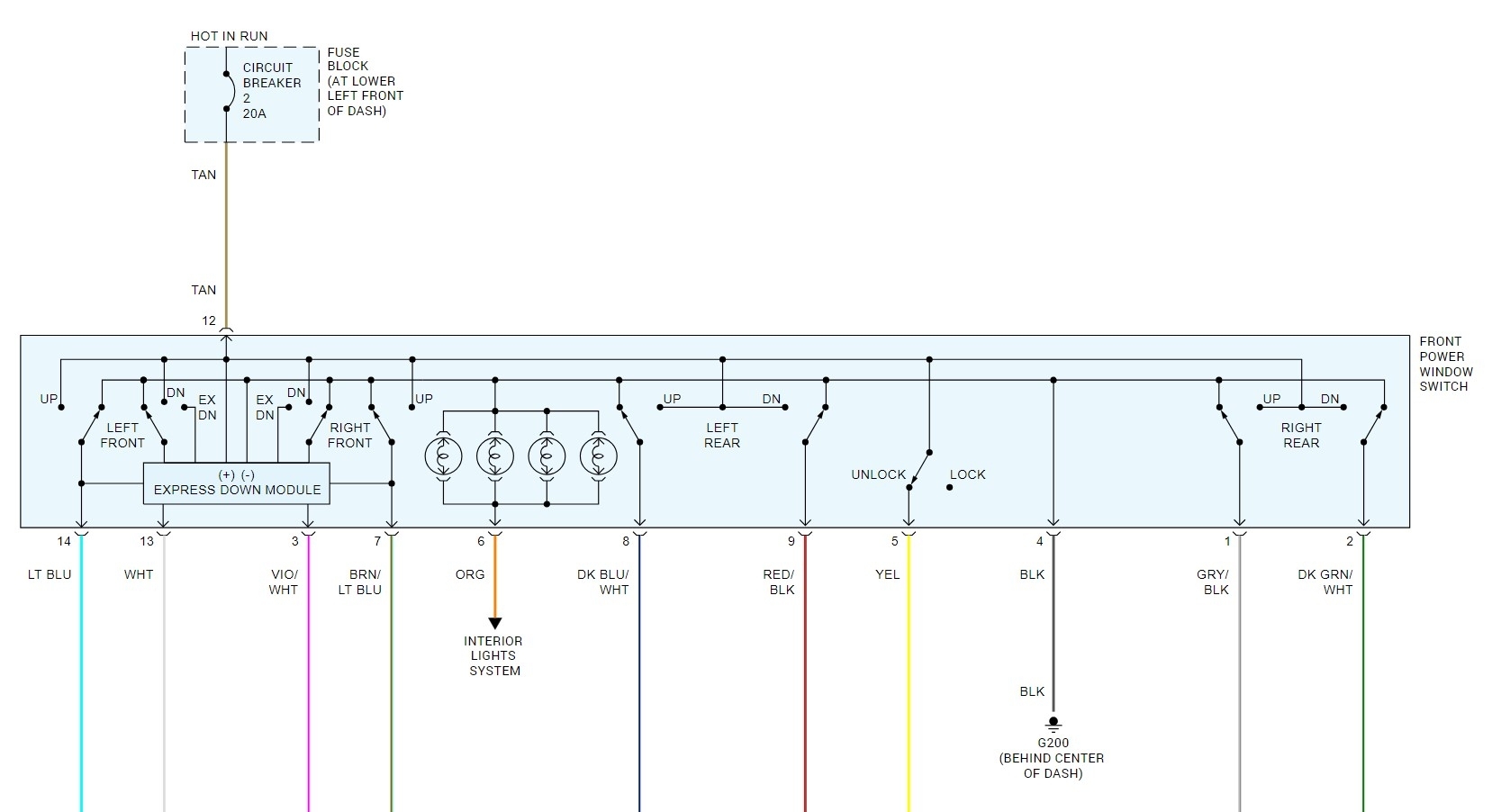

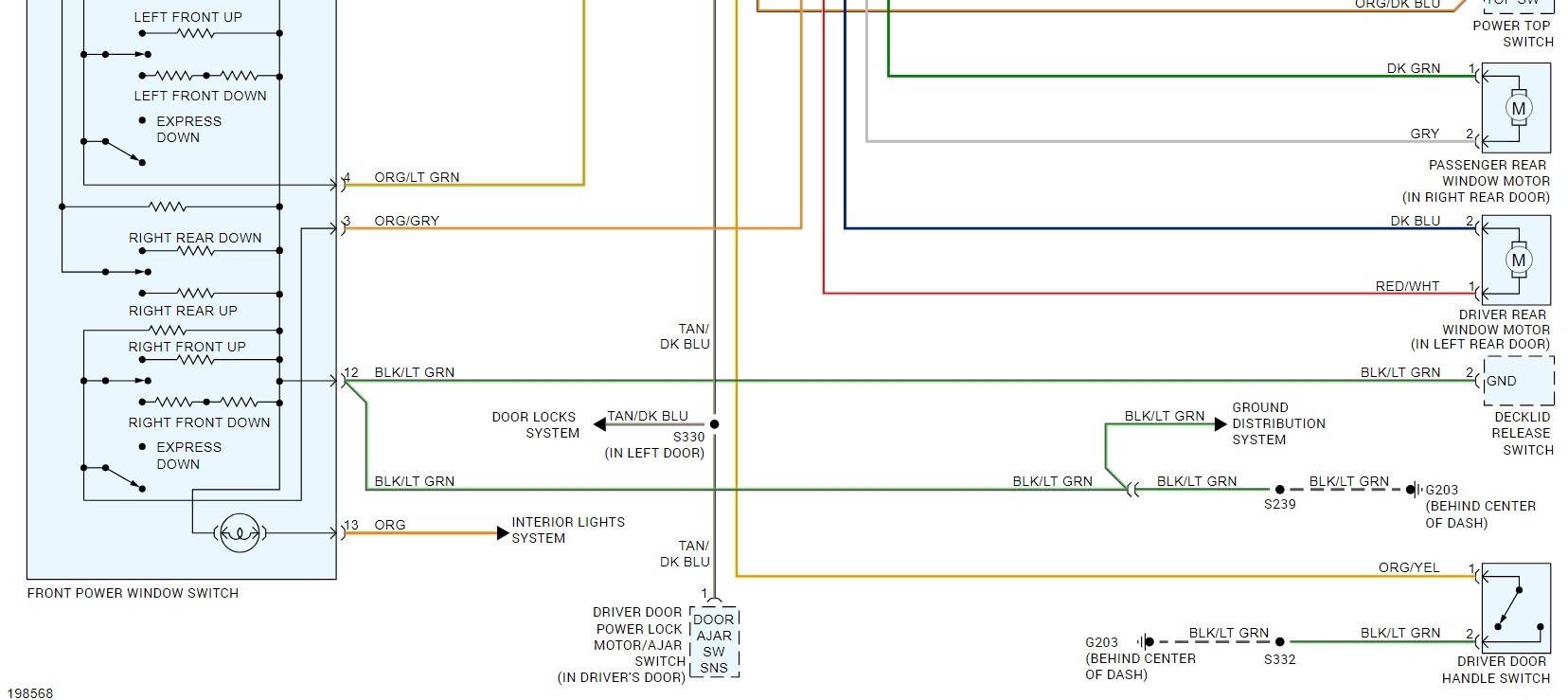

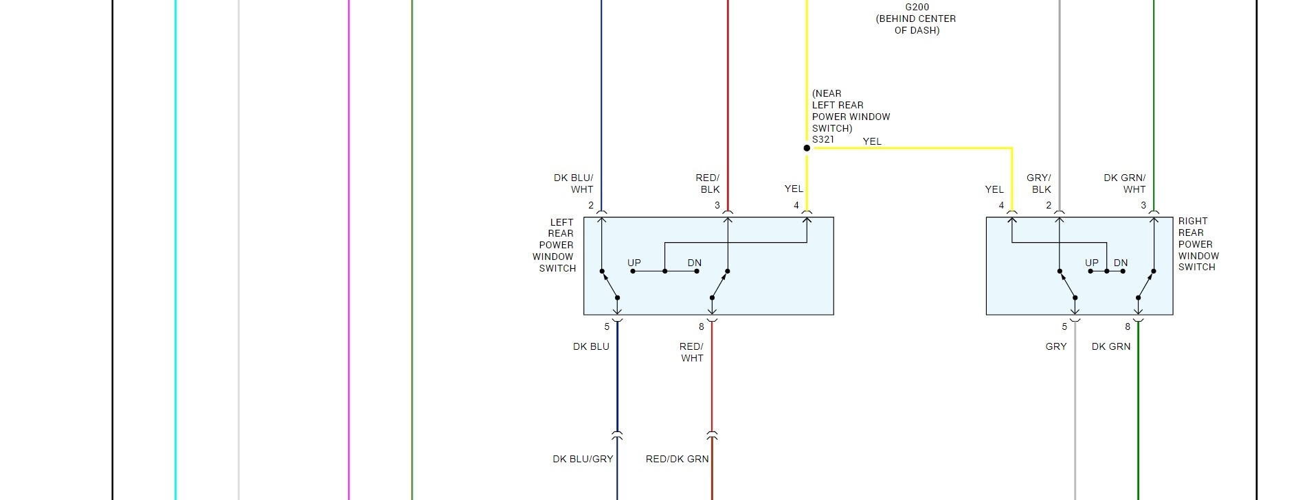

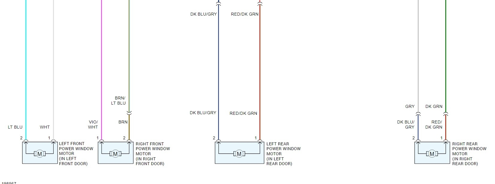

Replaced switches and jumped off battery. Windows still do not function. Doors will unlock with a button but no sound when attempting to lock from the switch. Circuit breaker CB2 is closed. I need to know where to test to see where I'm losing voltage. Or I need a good, clear schematic.
