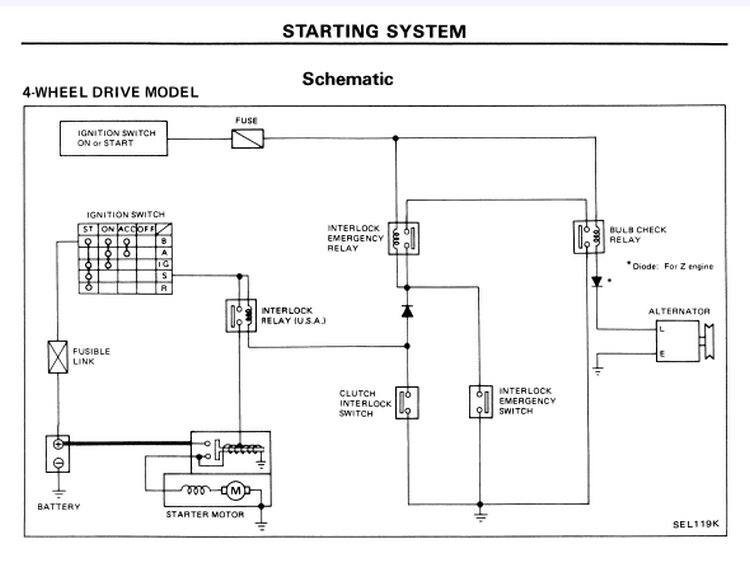

changed valve cover gasket, reassembled, it started, ran erratically, found the vacuum hose not connected to air cleaner housing. attached it and now it will not turn over at all. Have rechecked all the vacuum routing and assembly 3 times. Everything is in order. checked spark with multimeter, all good there and definitely getting gas.
