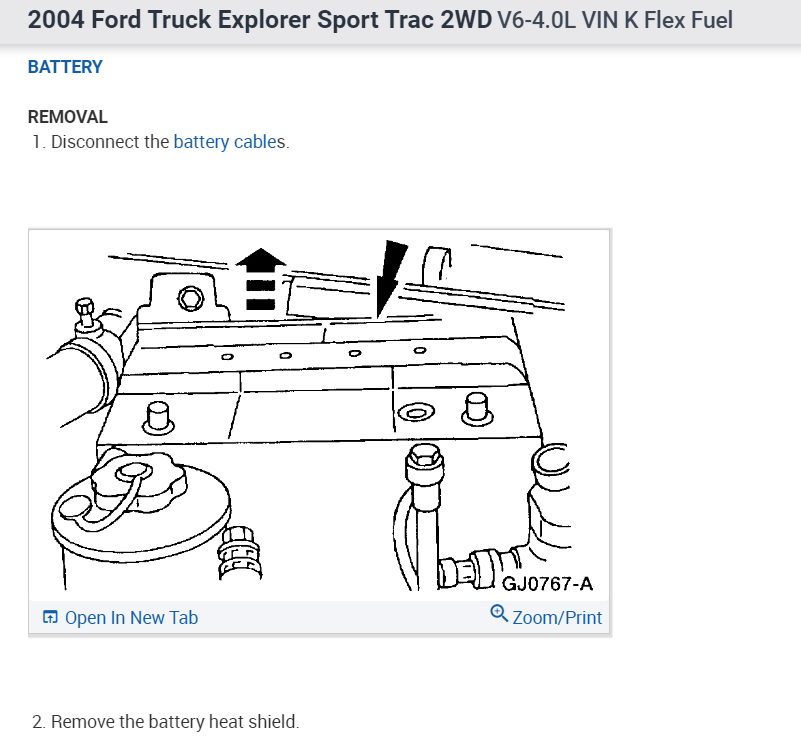

Yep, this can be one of two things, either the battery is drained, or you have a bad connection at the battery, I would try to clean the connections the battery first which this guide can help with:
then load test the battery which you can do with no equipment by following this guide

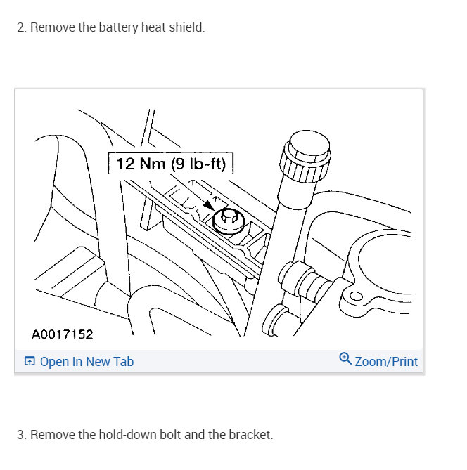

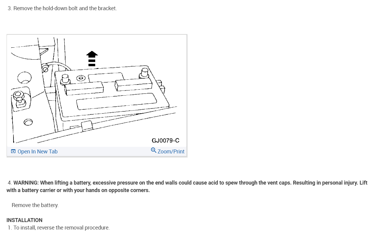

If the battery fails let's install a new battery which this guide can help with, and I have included specific instructions for battery replacement in the diagrams below:
