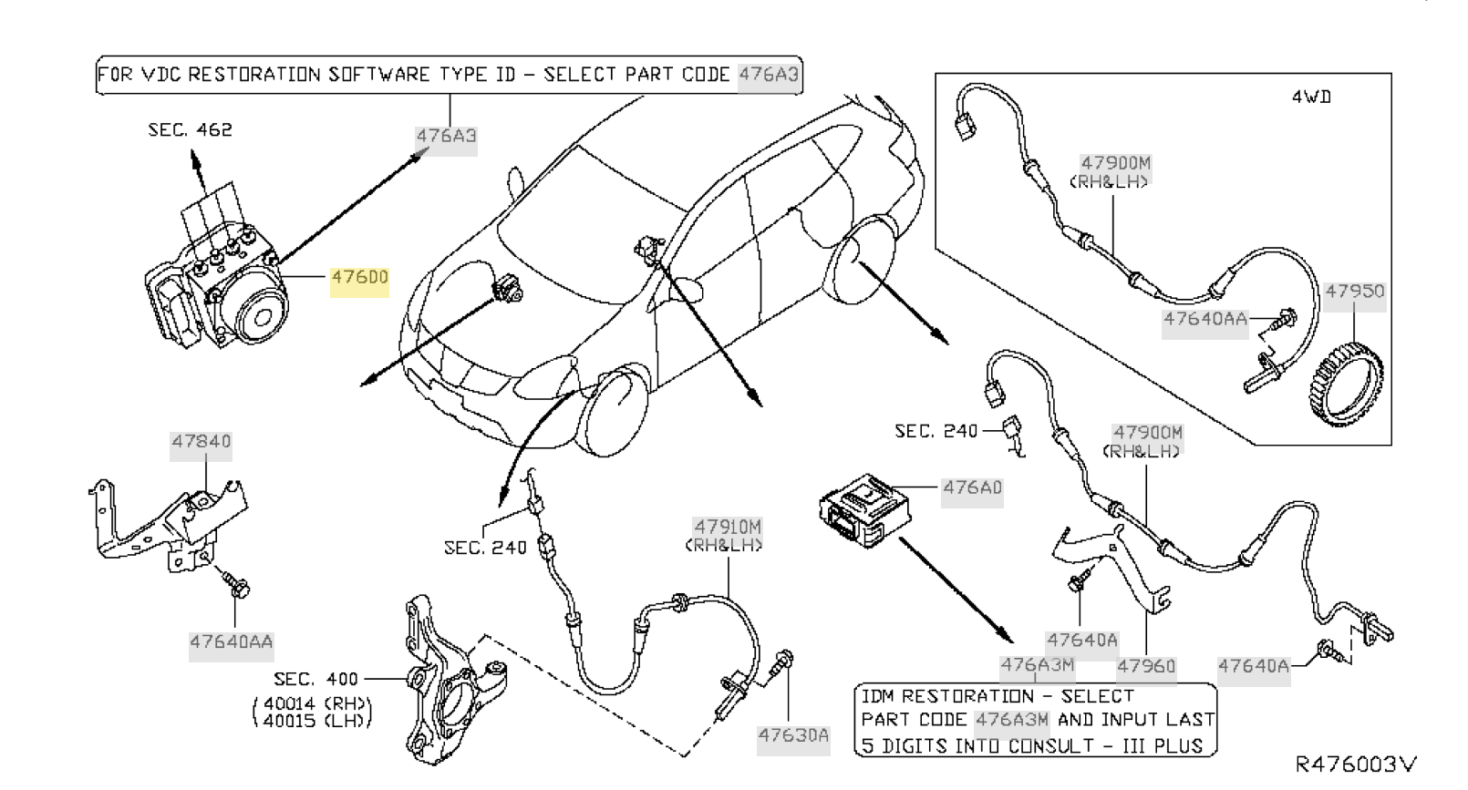

It looks like code U0121 is set if the distance sensor detects and error signal that is received from ABS actuator and electronic control unit via CAN communication, the Controller Area Network. This allows modules to communicate with each other.
The other code U1002 pertains to the ABS and electronic control unit is not transmitting or receiving communication signal for 2 seconds or less.
Seems like it may be an issue with the ABS actuator.

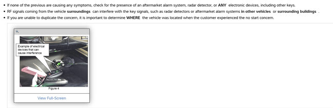

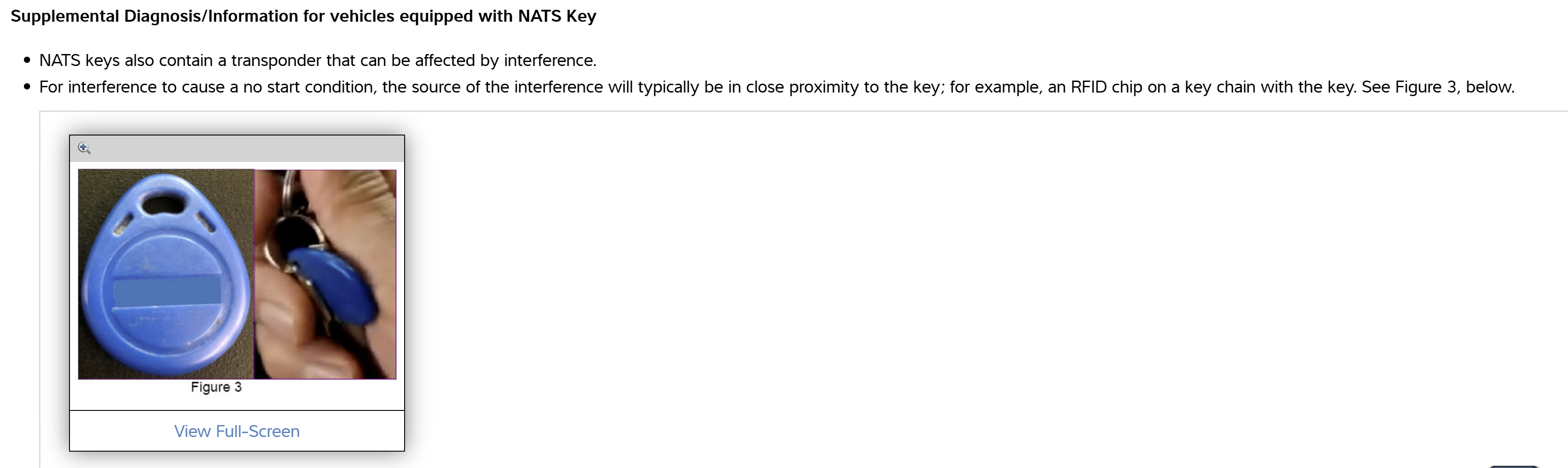

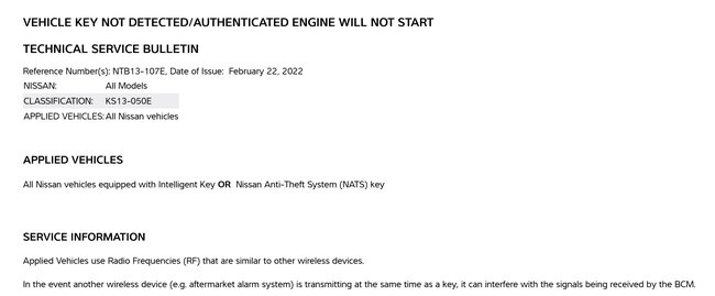

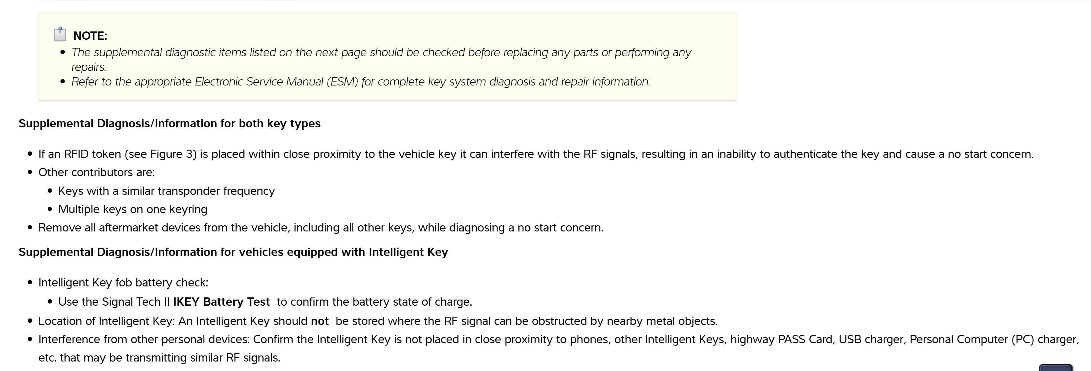

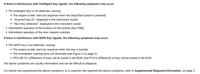

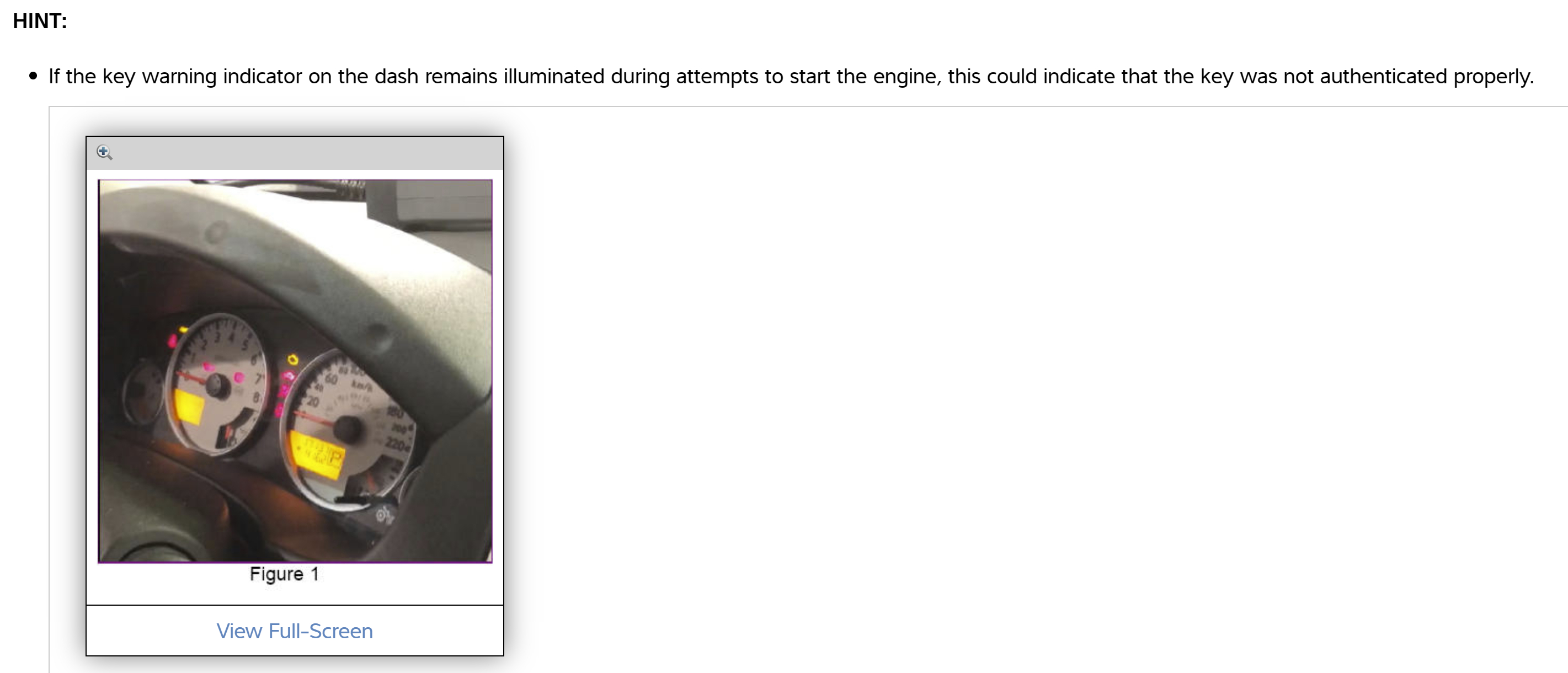

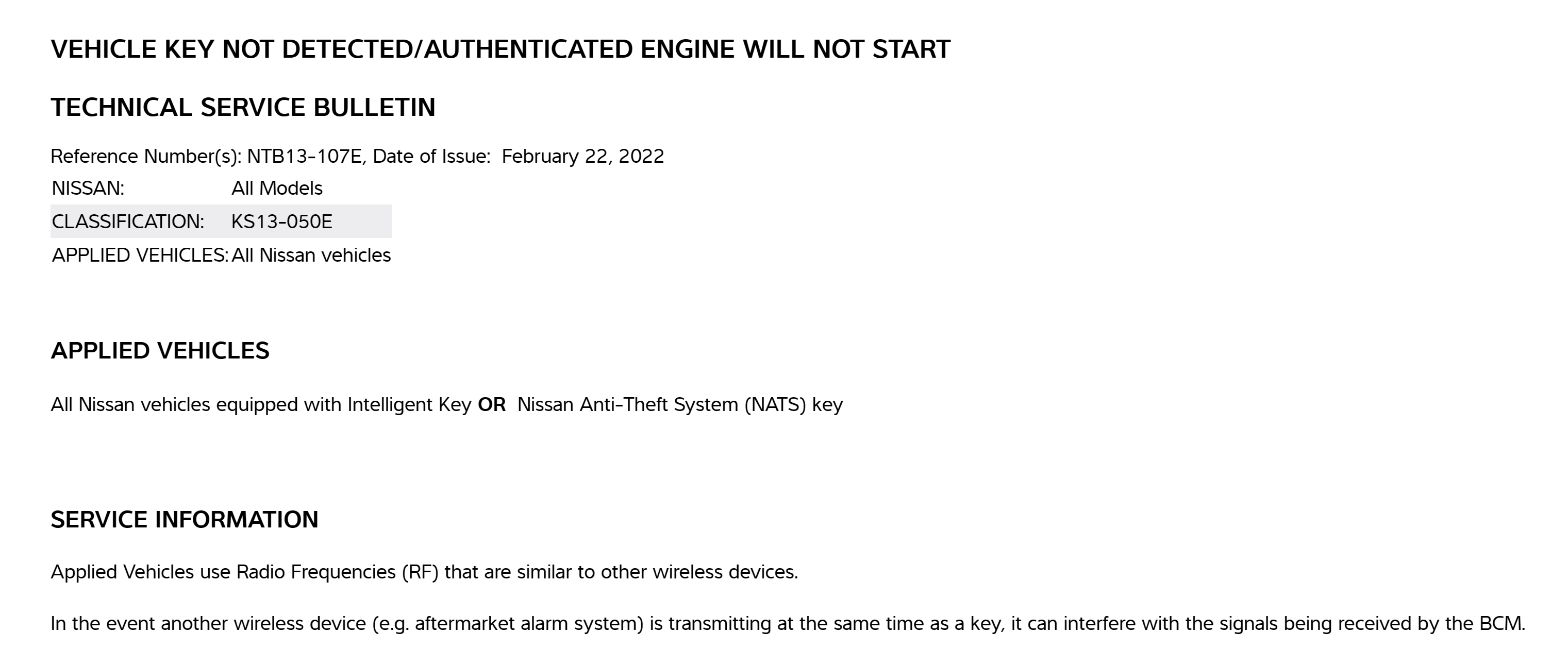

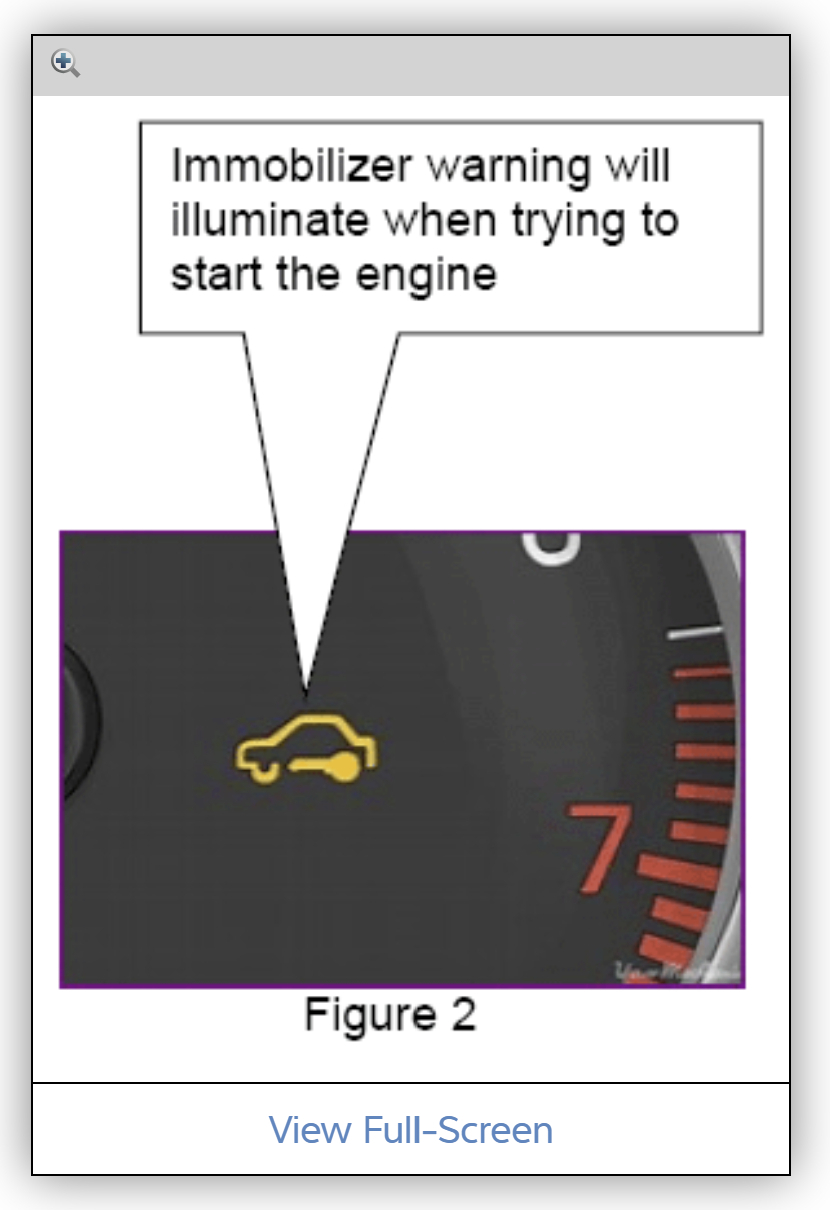

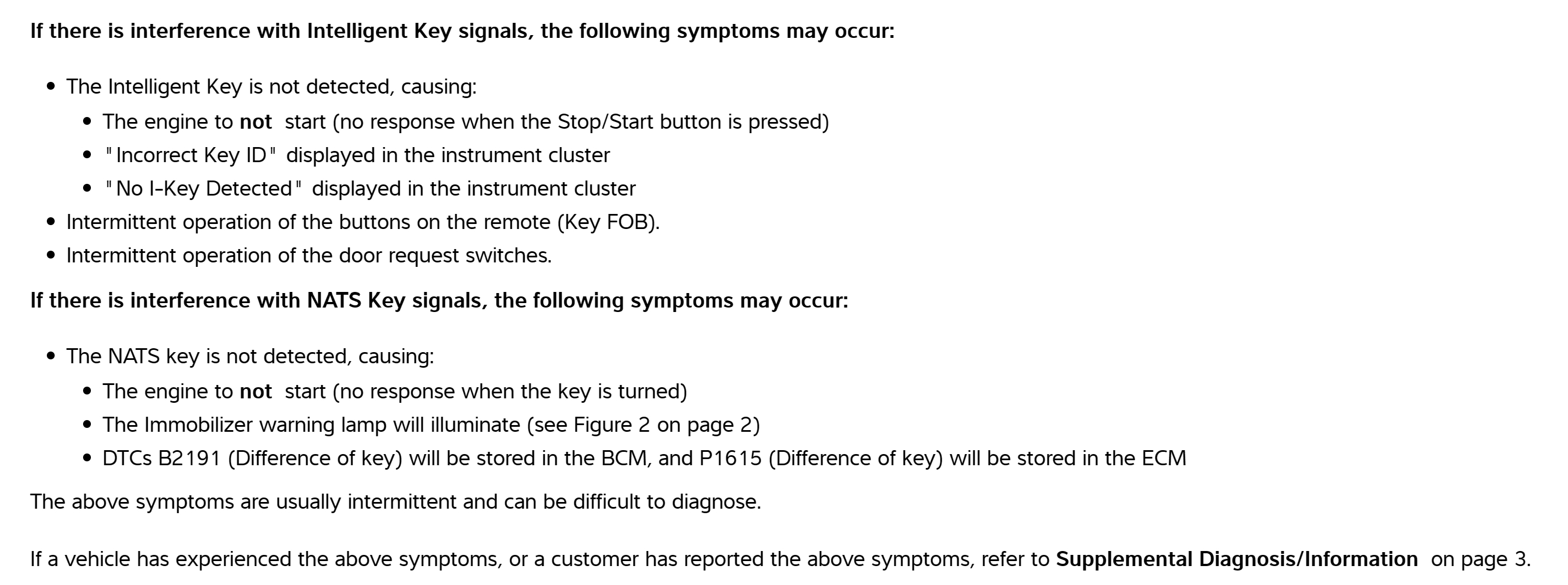

I am adding a TSB for key not detected/engine will not start. Go through it and see if you have any of the symptoms in it. (Sorry it was kind of large, so I had to add it in multiple photos)
Also, if you have any devices in the car that has been added, please remove them for now. Anything that puts out a RF signal, for instance Bluetooth devices, phone chargers, Apple Air Tags, toll transponders like E-Z Pass anything electric or wireless can interfere with the Nissan Anti-Theft System or NATS and cause the vehicle not to start. If you have added anything that did not come with the car, remove it for now.
