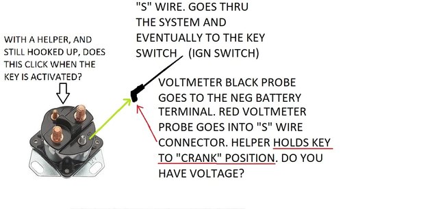

In ancient times, this was called the solenoid or starter solenoid. (nowadays it is often called a "starter relay")
https://shop.advanceautoparts.com/web/PartSearchCmd?storeId=10151&catalogId=10051&langId=-1&pageId=partTypeList&actionSrc=Form&searchTerm=starter%20solenoid&vehicleIdSearch=8340
You have a 5.0 Liter? (Not a 4.6)
Do you have a voltmeter or 12 volt test light?
We might be able to narrow down where the issue might be.

Have you tried this?
See my picture.
