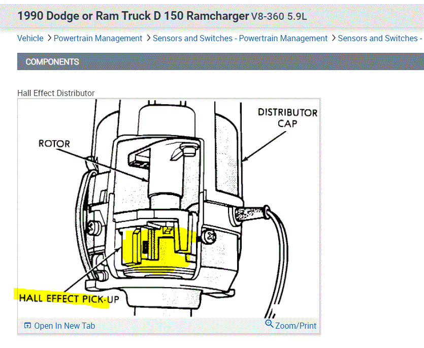

As far as the ignition control module is concerned, it is integral with the powertrain control module. That is an expensive part, and why I need to know if you lost spark. Also, there is a higher likelihood that the pickup coil in the distributor failed and is much less expensive to replace.
The pick-up module is located in the distributor and will prevent you from getting spark. I attached a pic below showing it.
Do these tests and let me know the results? I don't want to point you in the wrong direction.
