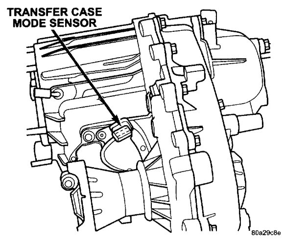

the #1 failure on these trucks: bad 4wd mode position sensor (internal to transfer case), also I have seen the control switch go bad as well, and finally there could be a bad ground, last resort. Also, lets double check the fuses:
Underhood PDC:
Fuse 24 (20A) - Transfer Case Motor
Fuse 26 (10A) - TCCM / 4WD logic
Interior Junction Block:
Fuse 13 - TCCM Memory
If this one blows, the module loses its learned values and just blinks.
With the key on test the fuses and check to make sure they are getting power this guide will help.
Here is the location of the sensor switch, check out the images (below). Please let us know what happens.
