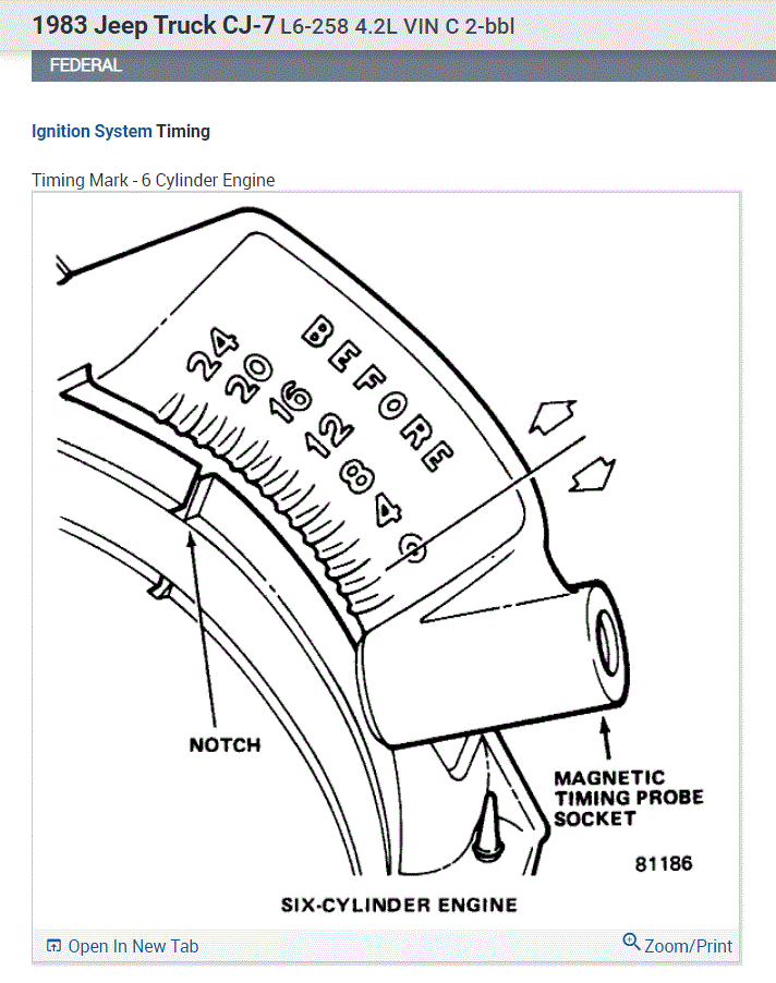

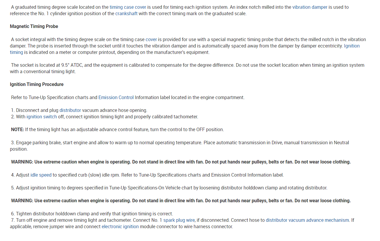

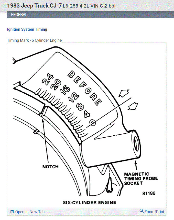

If you have spark, fuel, and compression, the only thing left is timing. Have you checked ignition timing?
If you look at the pics below, they provide the directions for adjusting timing. Since it isn't running, take a timing light and see if it is firing when it should.

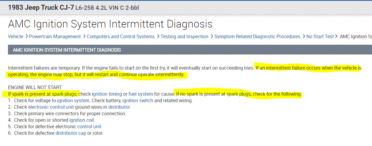

If you look at pic 3, it explains what to check for an intermittent ignition problem. You mentioned that you had no spark but now do, so that is why I added it.
