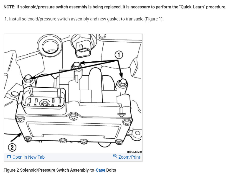

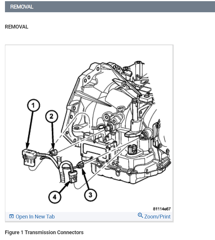

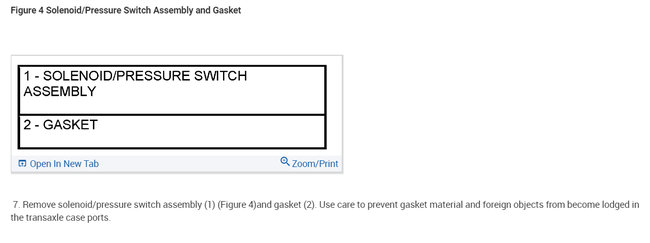

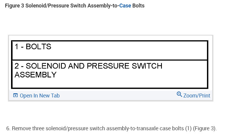

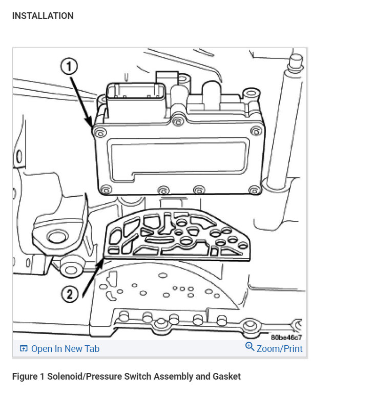

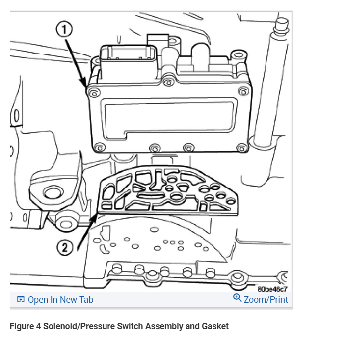

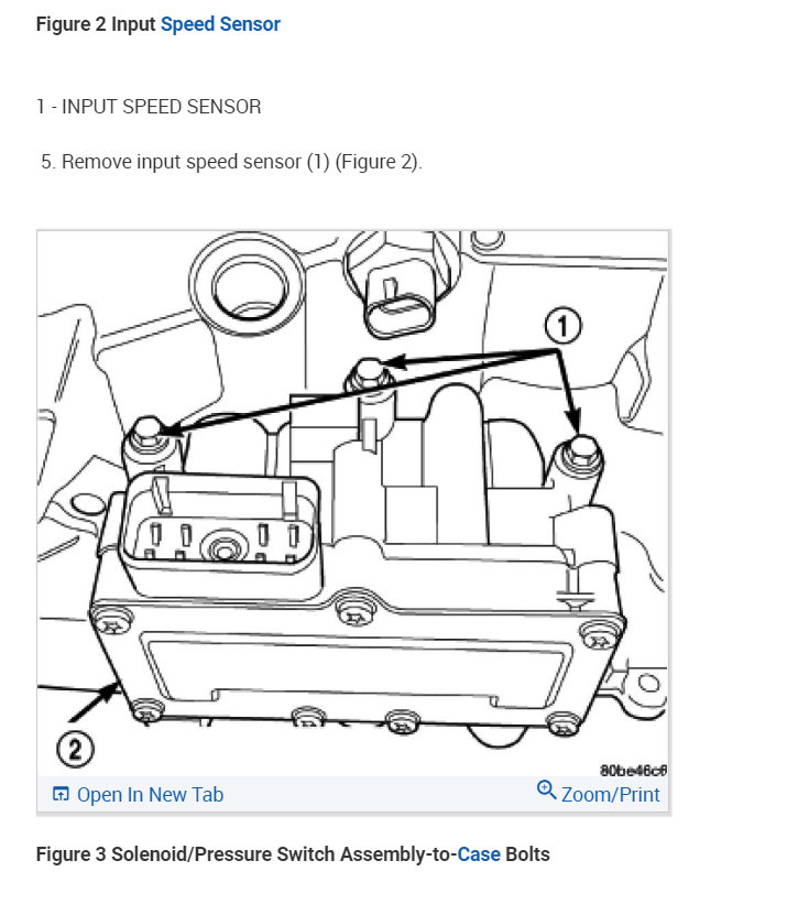

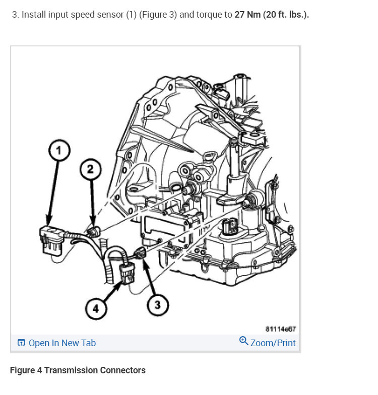

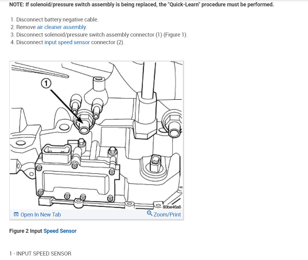

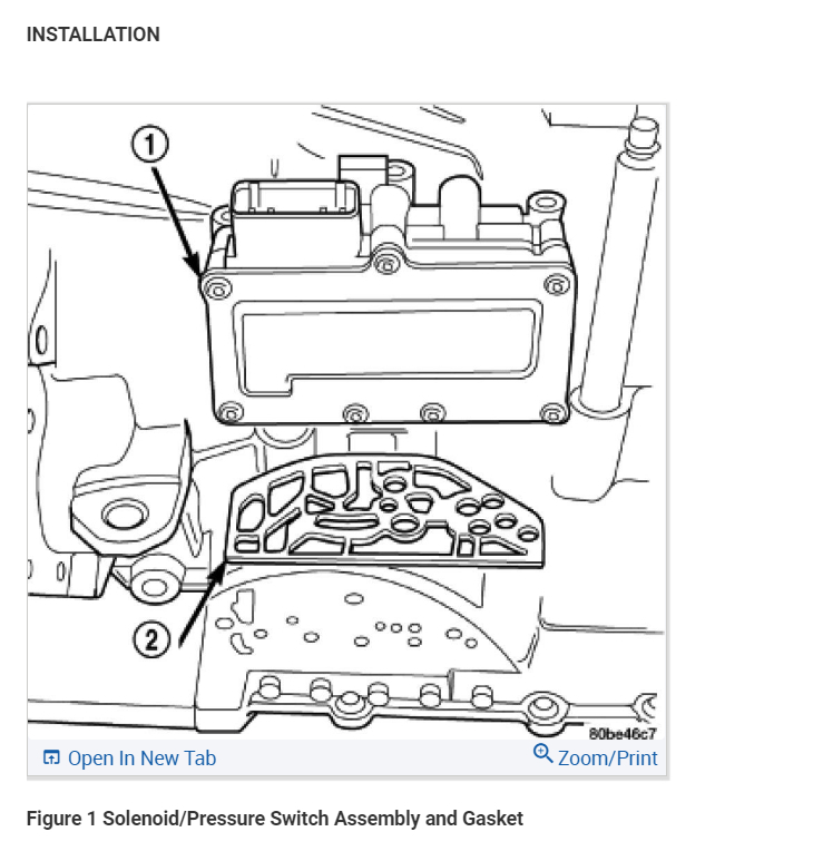

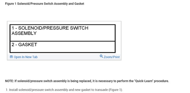

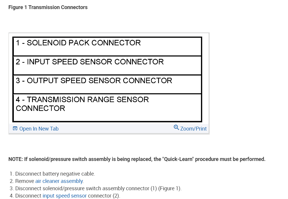

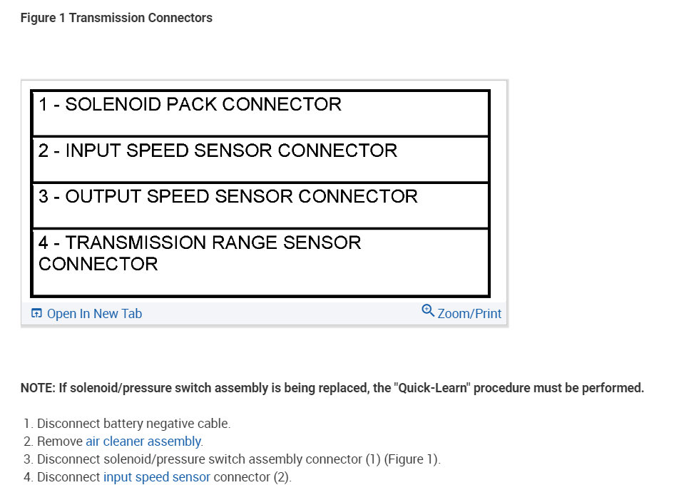

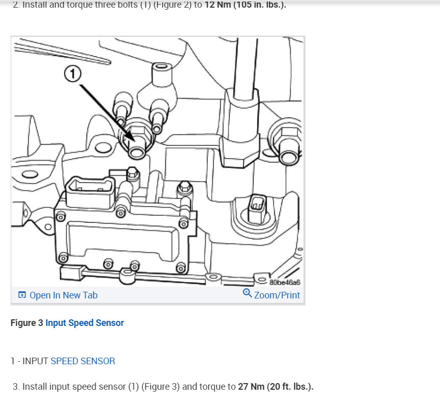

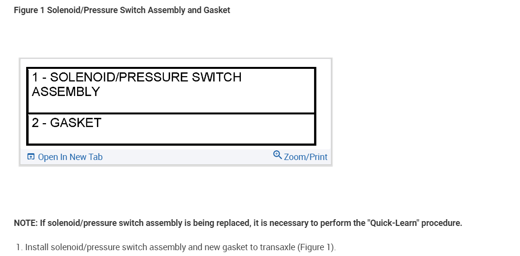

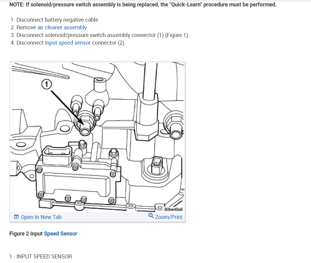

It is common on these cars that the solenoid pack to go out which includes the pressure solenoid and the speed sensors which is replaced as a unit. Here are the instructions of what needs to be done to change the unit out in the images below. Let us know what happens and please upload pictures or videos of the problem.
