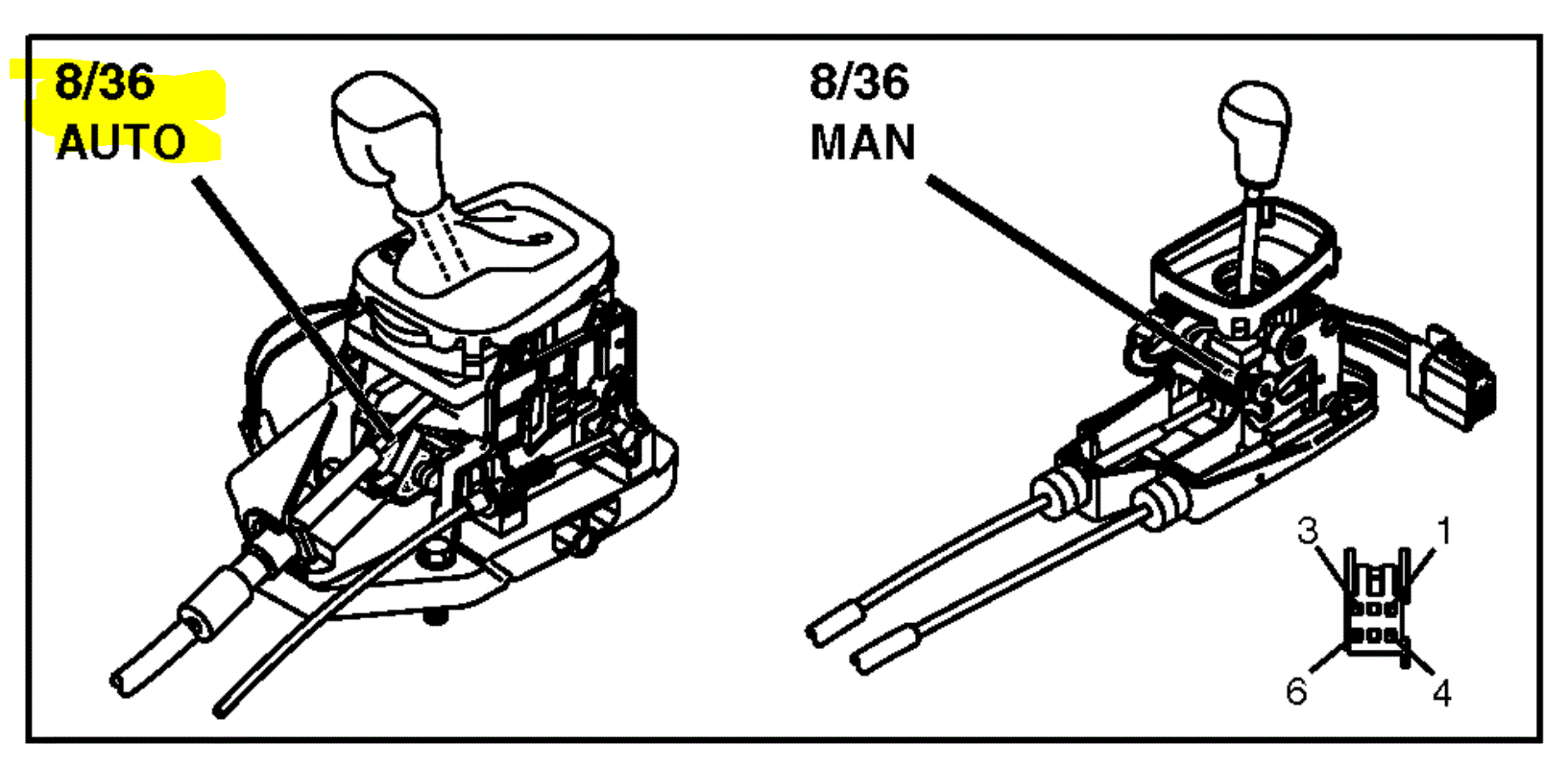

If you can't move the lever, it is related to the park interlock. Don't laugh but confirm the brake lights are working. The actuator to release the shift lever is powered by the brake light switch.
Keep in mind, I don't feel the shift interlock prevented the vehicle from going into gear, but if you can't shift from park, this is my first suspect. I attached a pic below if its location.
See pic below.
