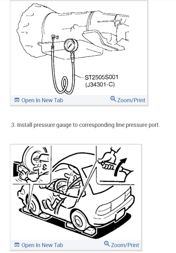

If the transmission will go into forward and not reverse, the issue is internal in the transmission. It could be a clutch, piston, band or valve body. someone will need to check the system with a scan tool to monitor applications to confirm.
Apr 2, 2018 at 2:36 PM

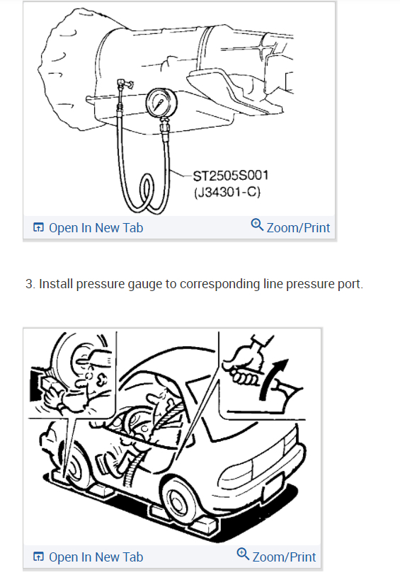

Okay, reverse is mechanically controlled inside the transmission. It is not electronically controlled at all.
https://www.2carpros.com/articles/automatic-transmission-problems

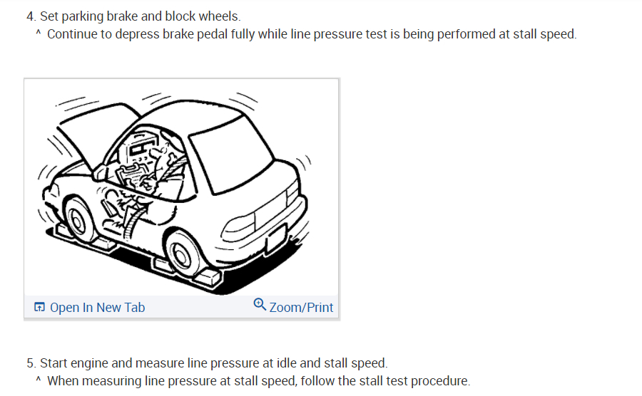

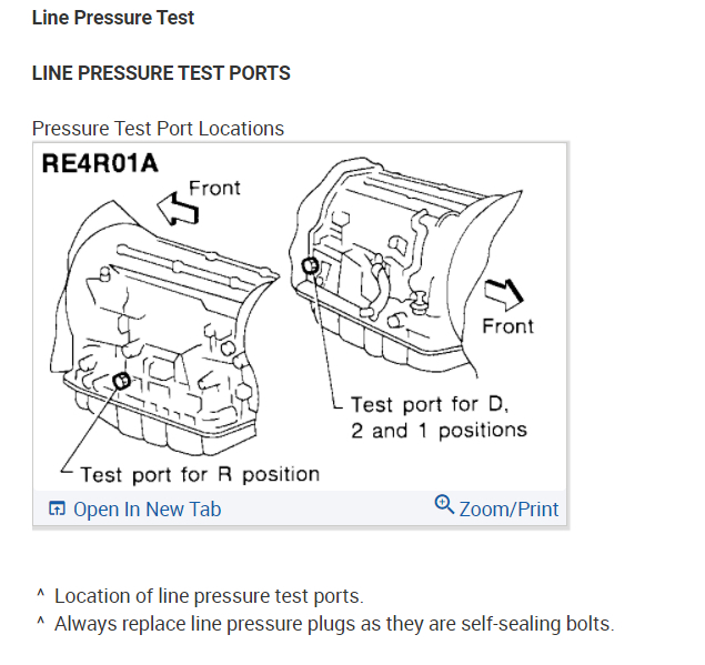

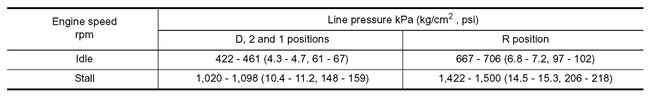

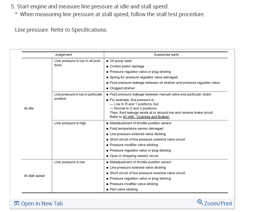

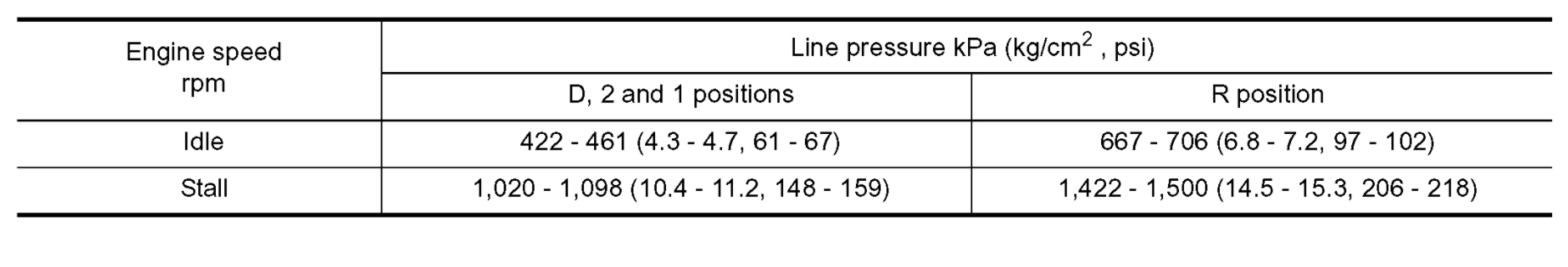

I attached the procedure for checking the line pressure to see if the system can engage. You will need a pressure gauge for this test. You can rent this at a parts store.
Low or no pressure tells you there is an internal leak for application of reverse. That will require an overhaul or replacement.
