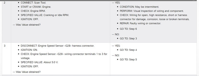

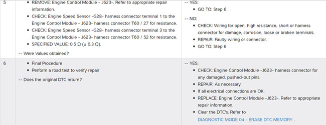

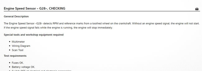

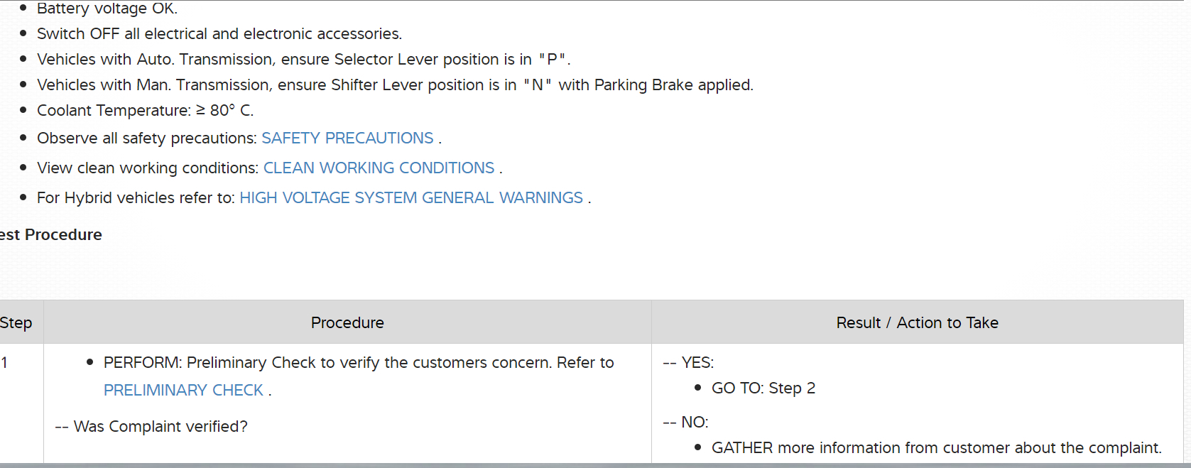

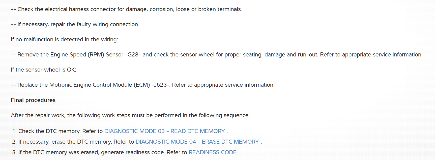

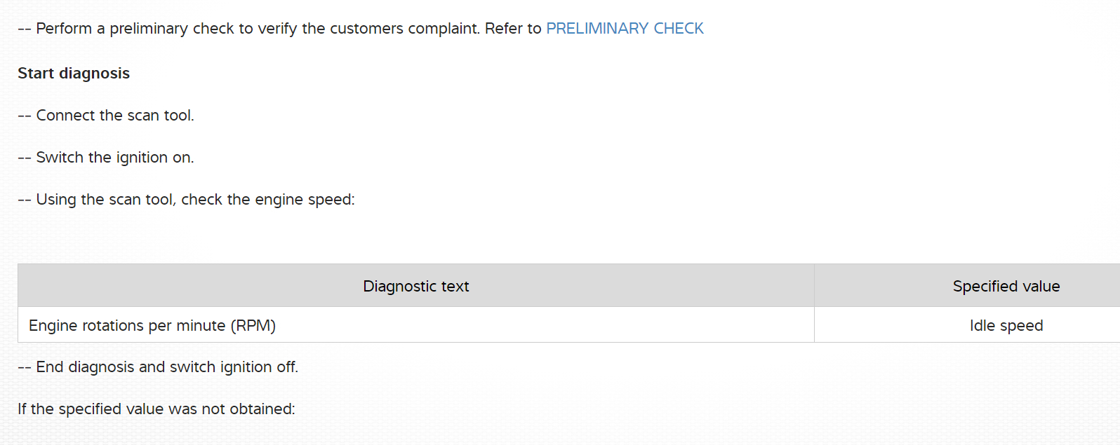

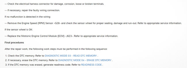

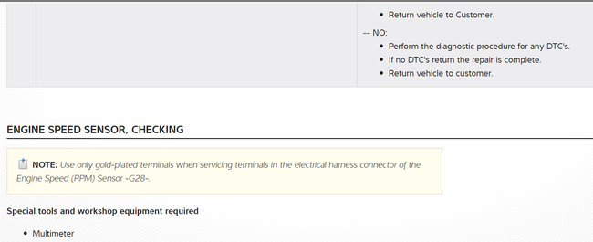

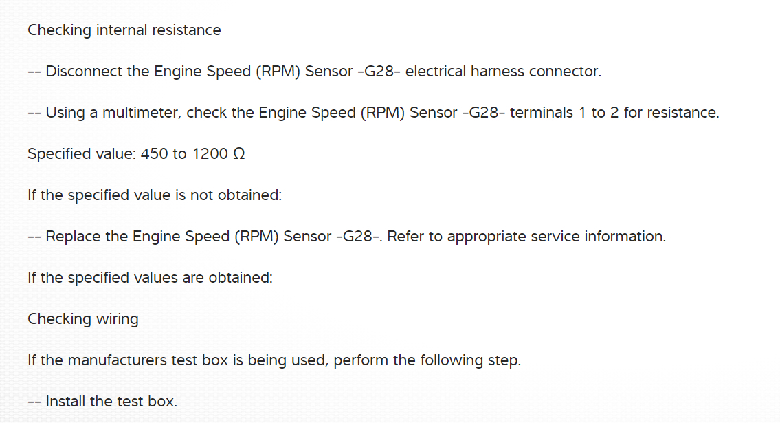

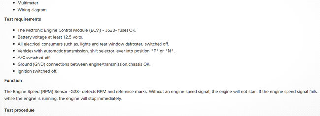

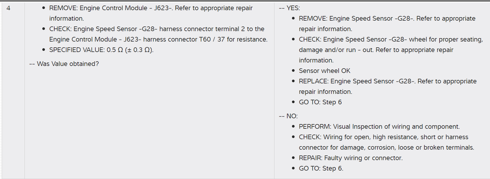

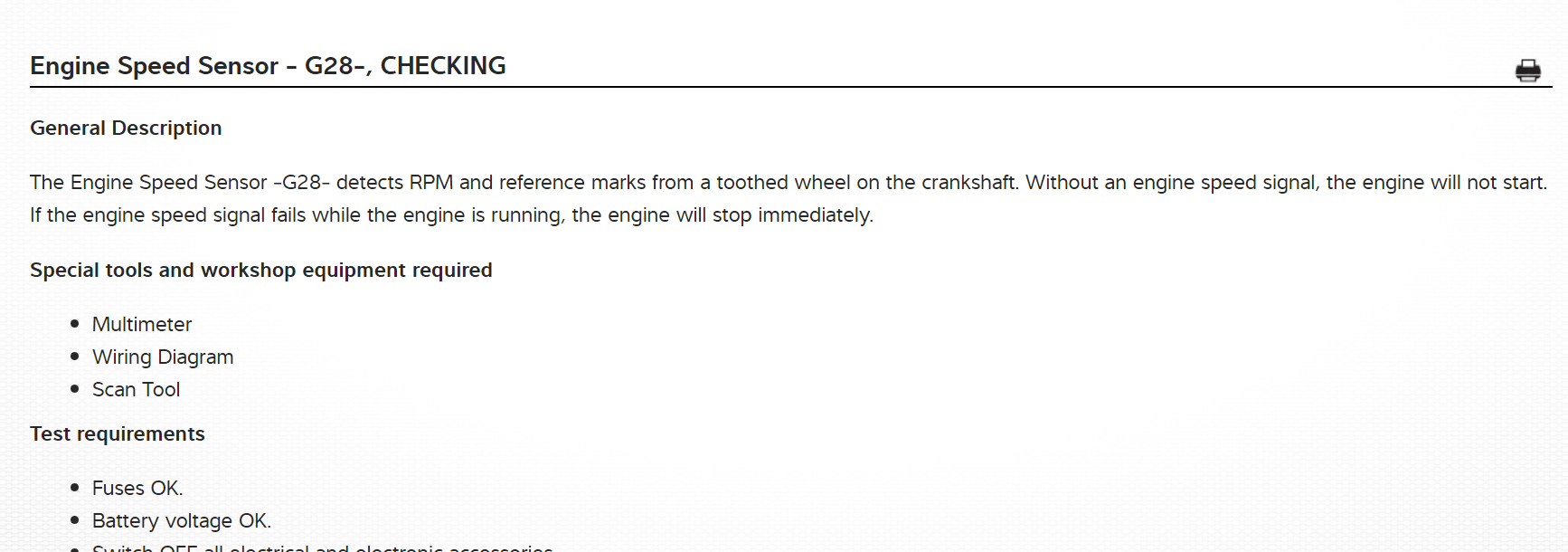

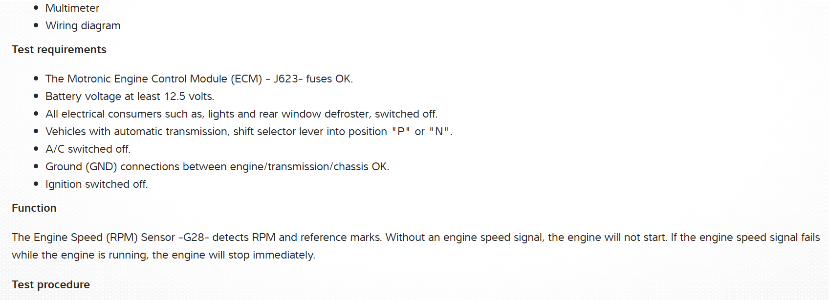

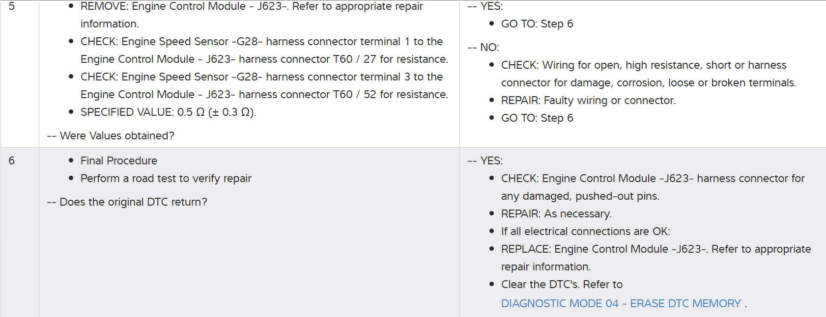

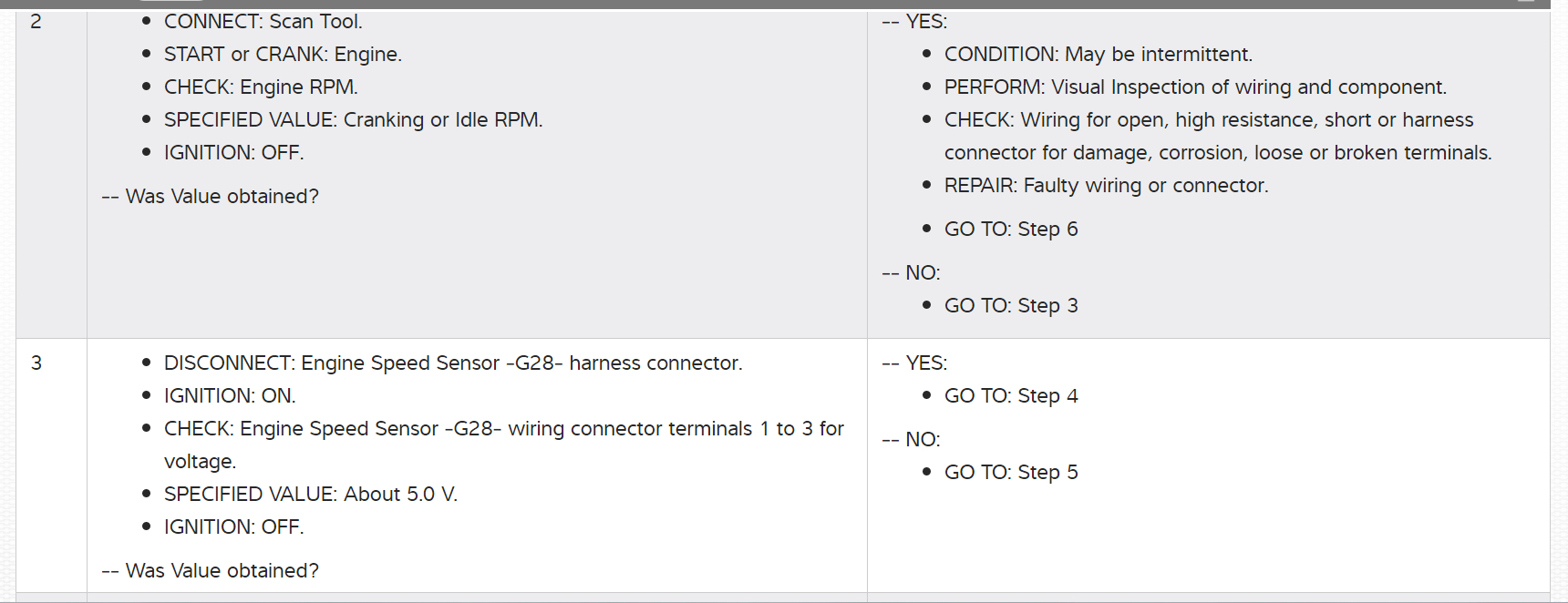

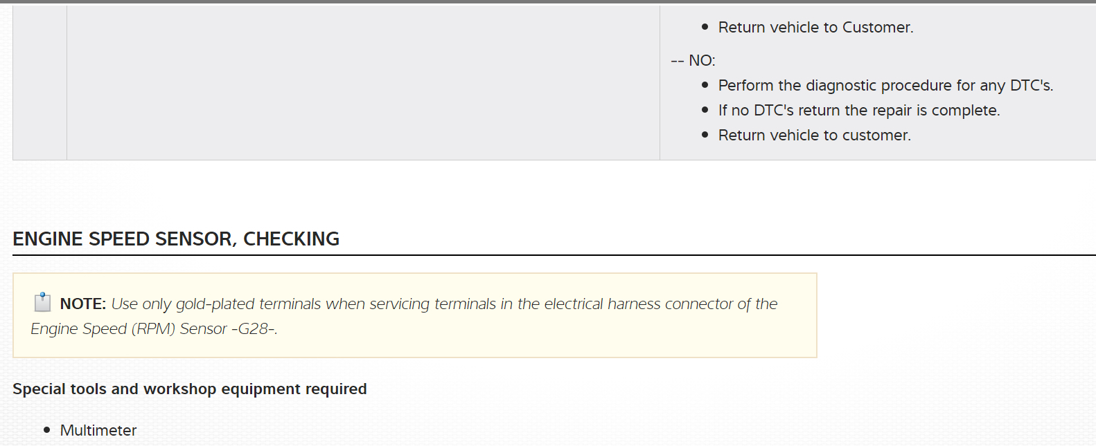

When you replaced the starter you didn't see any chipped teeth on the flywheel? I'm assuming no. My best guess here is your vehicle's engine speed sensor. I have included troubleshooting charts for you in the diagrams down below. Please go through them and get back to me with what you find out.

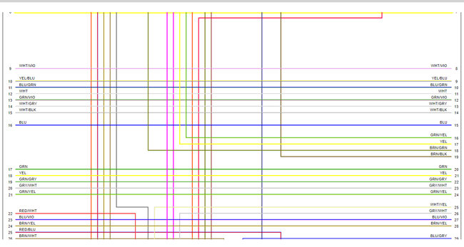

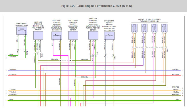

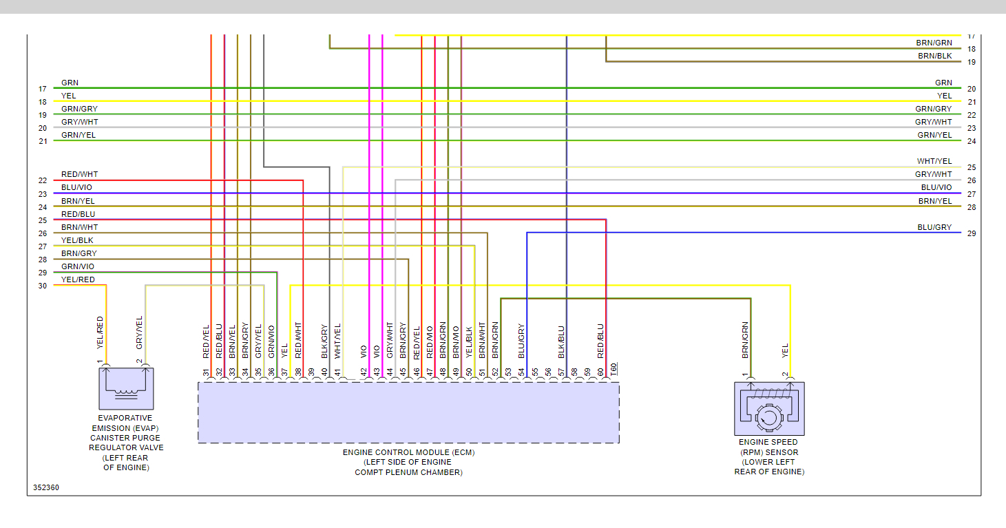

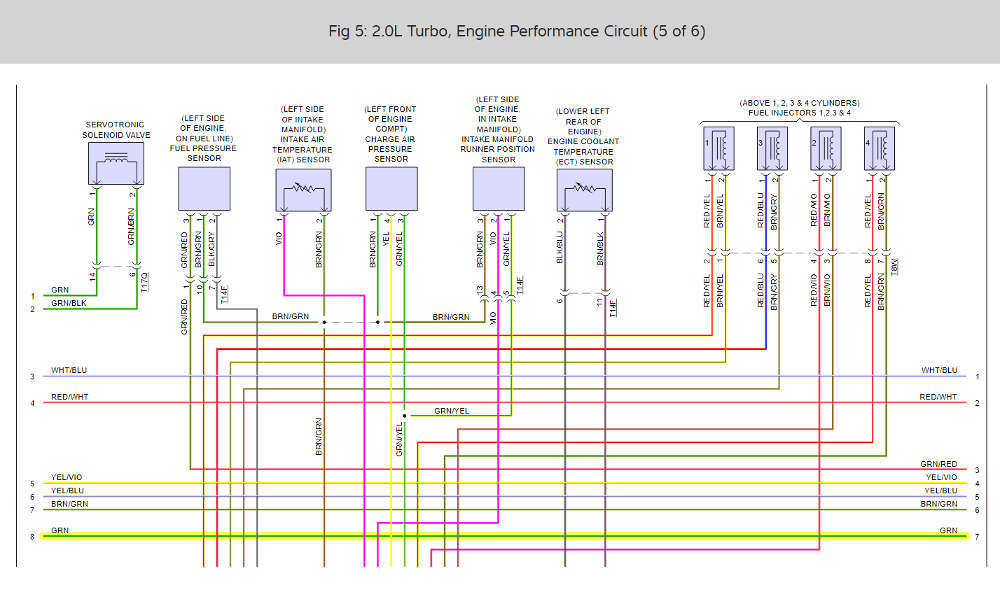

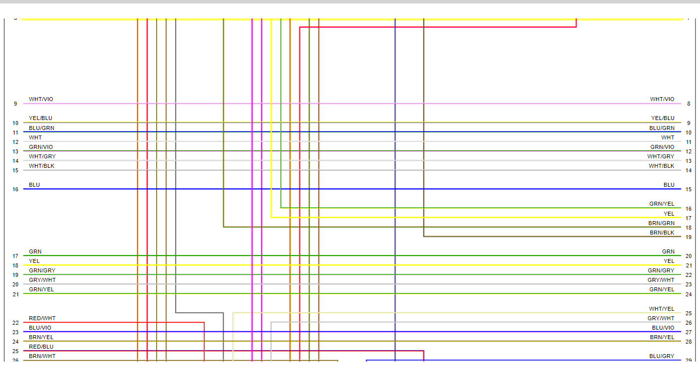

Okay. Thank you for your reply. This has been a very big headache and inconvenience. Do you happen to have any fuse/relay diagrams that would aid in running the tests you listed?
Mar 6, 2019 at 6:09 AM
SCGRANTURISMO
  • 4,897 POSTS
Hello again,
I have included the information you requested in the diagrams below. Let us know what you find out.
