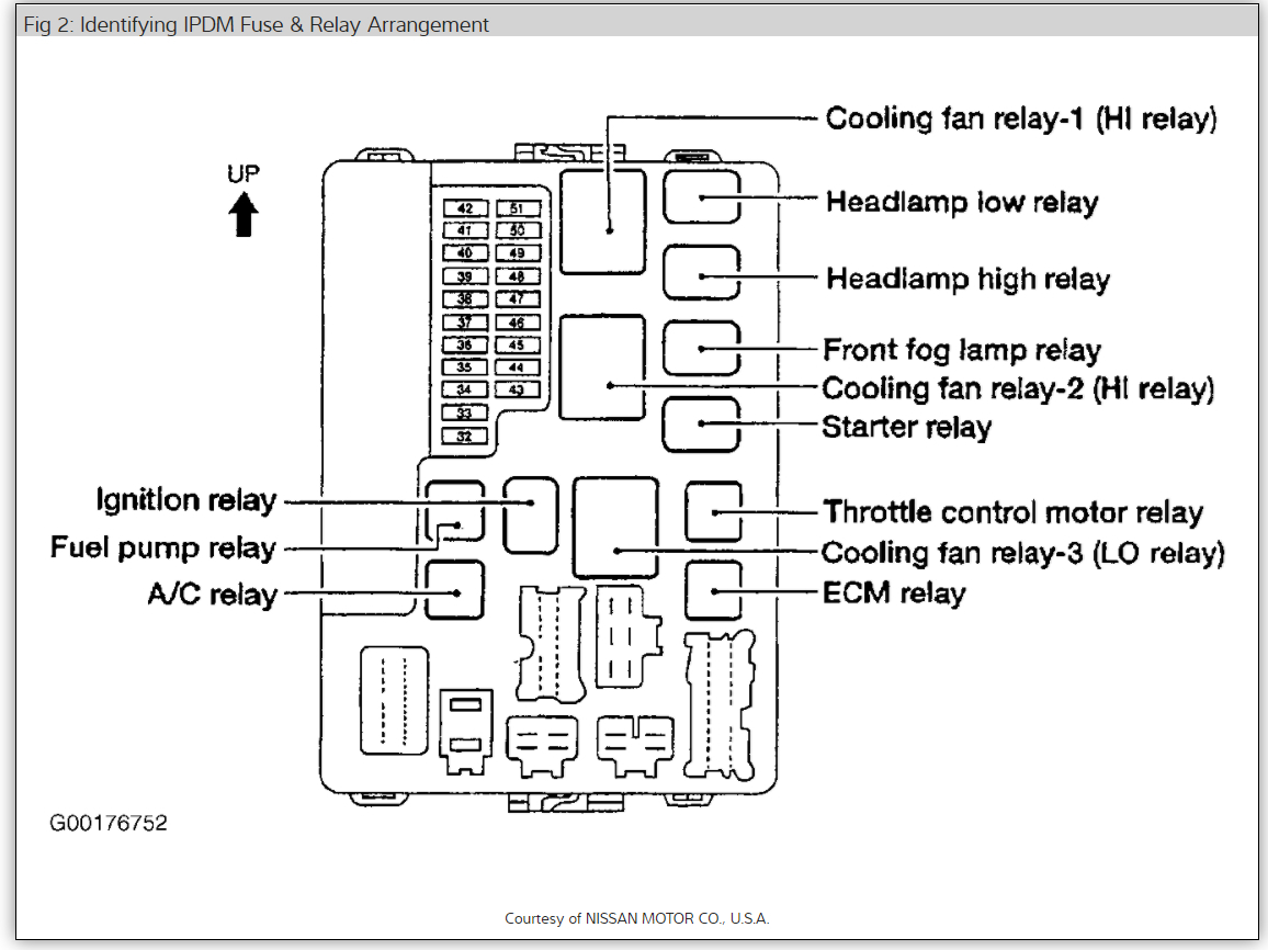

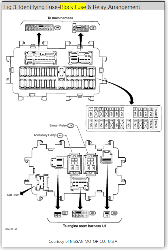

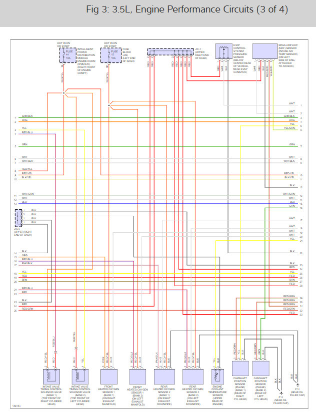

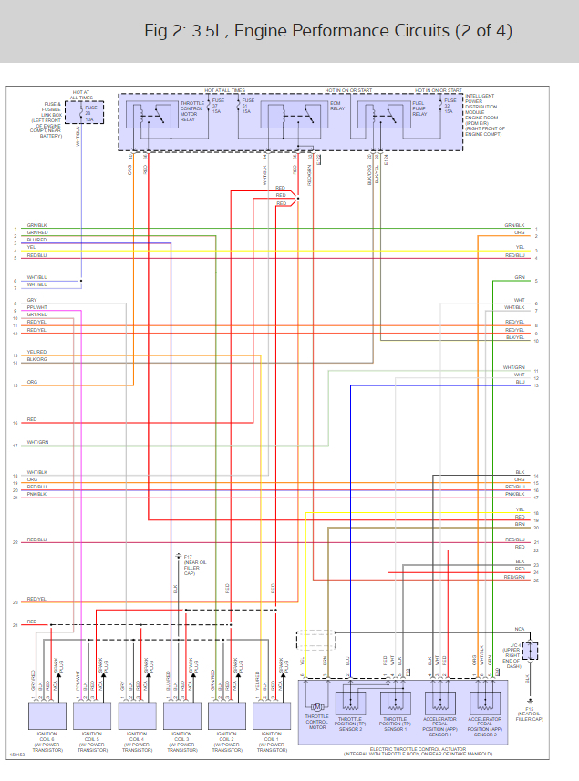

Is sounds like you blew one of the fuses when connecting the new battery due to a voltage surge. Lets start by checking all fuses.
Here are the engine wiring diagrams so you can see how the system works and which fuses to check with the fuse panels location and identification.
Cheers
Jan 22, 2019 at 1:25 PM (Merged)
BARBQME2
  • 5 POSTS
Thanks, Jack.
All the fuses are okay so I let it set overnight. When I started it this morning the accelerator worked like it is supposed to. I drove it and at first it surged but then it settled down and drove correctly. I drove it about 5 miles with no problems. For no reason that I could see it started acting up again. It would surge and then nothing would happen. While it was surging the car would move. When it wouldn't the car would coast. When I checked it with a code reader it gave me a P0733 code. I know what the code means but don't know what causes it. Could this be caused by a failing fuel pump, stopped filter, or is this electronic? Do you know what the next diagnostic step is? Thanks.

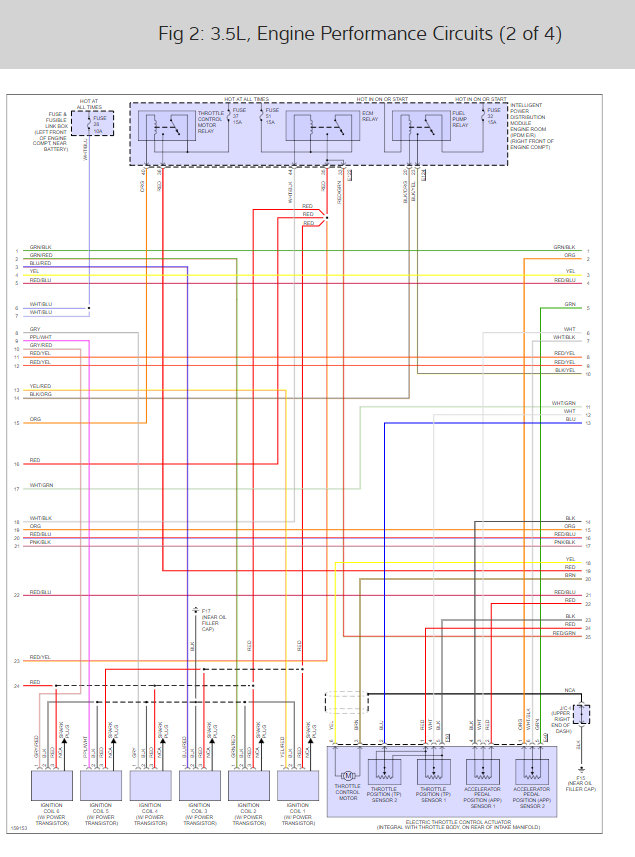

This is starting to sound like the throttle actuator is going bad. Have you had it replaced?
