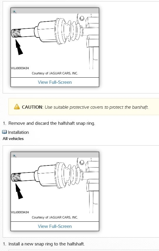

I am reading, " The inner CV joints are retained in the differential with the aid of a spring clip", but there should be no splines missing. If there are splines missing, it would seem to me that the axle would slip while turning, not pulling out because of missing splines. Can you post some photos of these missing splines?
Are there part numbers on these axles?

The last and first procedure they list when removing and installing this axle is remove and install a new snap ring.

I think if the axle keeps pulling out, the problem would have to be with the differential, where the axle splines go into and where the clip is supposed to hold the axle in. It is worth a look to inspect that and see if something is wrong and the reason the clip does not hold.
