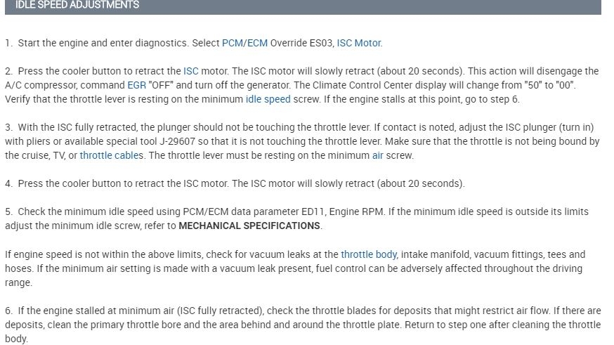

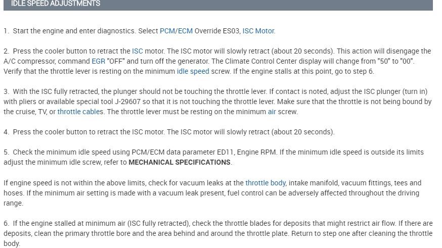

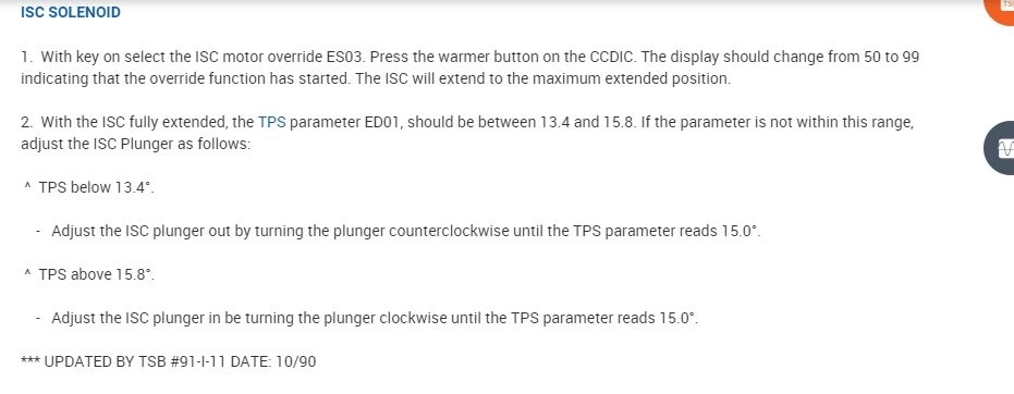

My car listed above with a 4.5L, stalls out when driving or idling when the temperature reaches 149 degrees. Fires right back up, but as soon as you give it gas in gear, it stalls out.
